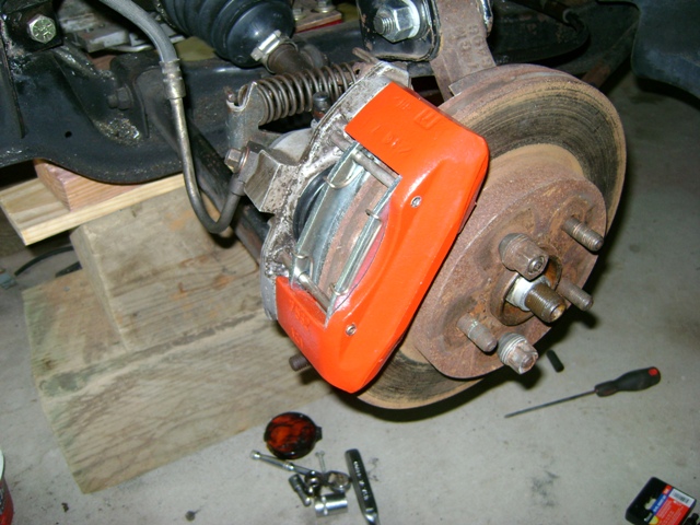

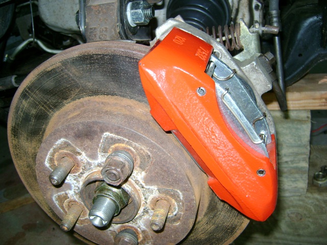

Both rear calipers and pads on and torqued down to specs. I have found that my parking brake cables are wasted so I just have the ends in its holes to keep the springs in place. I'll have to order all three new .$80.00 more shot to hell.
One side:
and the other side:
The rotors look better than they appear. The camera flash paints it, and lites it up for capture. I used a air sander to remove the surface rust on both sides before mounting them on the hubs.

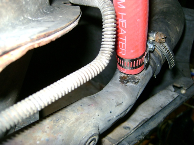

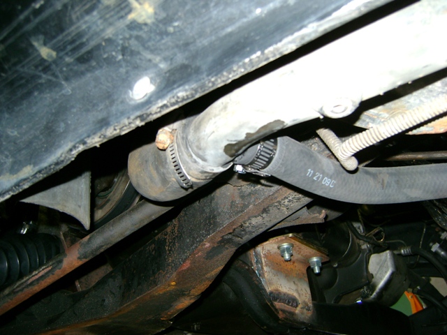

Drained, cleaned up , then installed a new hose. I tightened the hose with it away from the weld so I could see better. Refilled, and started it up to build pressure. Found the leaks. There are two. One from 12 to 3, and the second from 6 to 9 facing the pipe as it is mounted on the car. I can only get a picture of the one leak as the second one is on top and not accessible with the camera.
