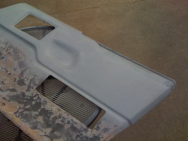

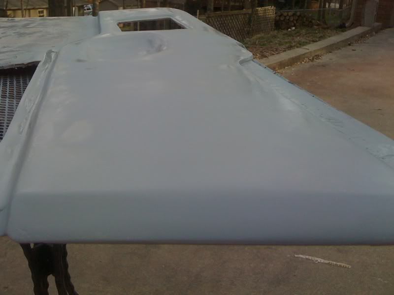

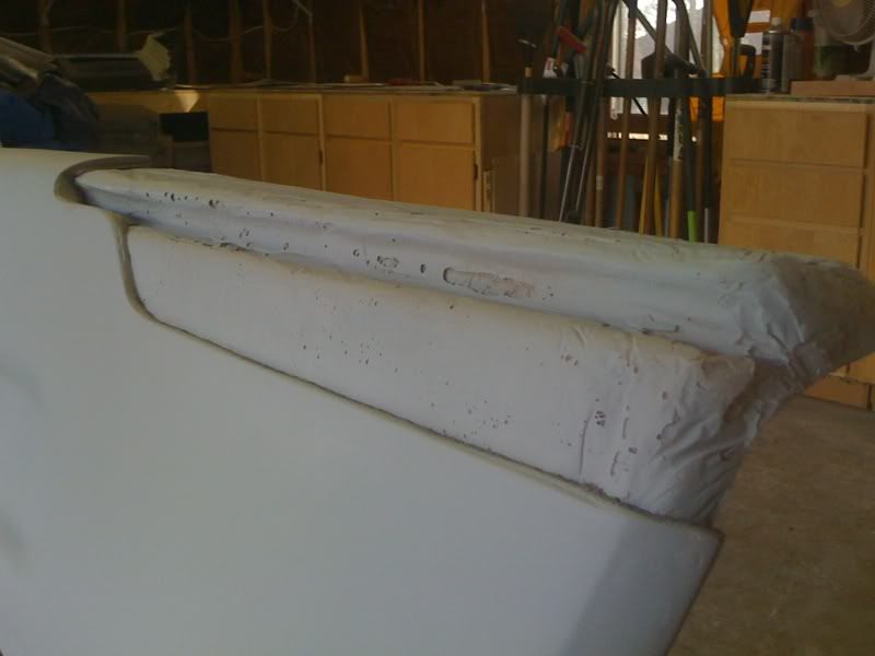

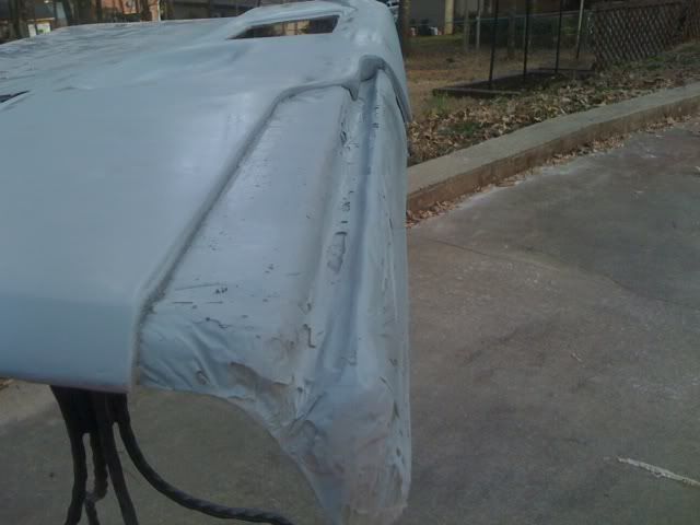

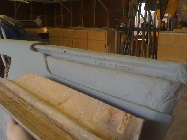

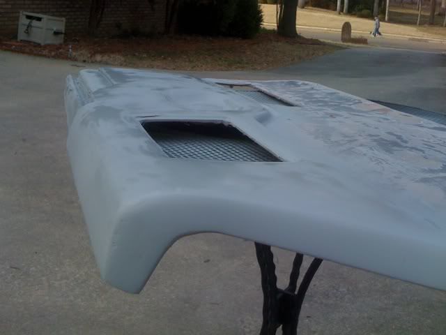

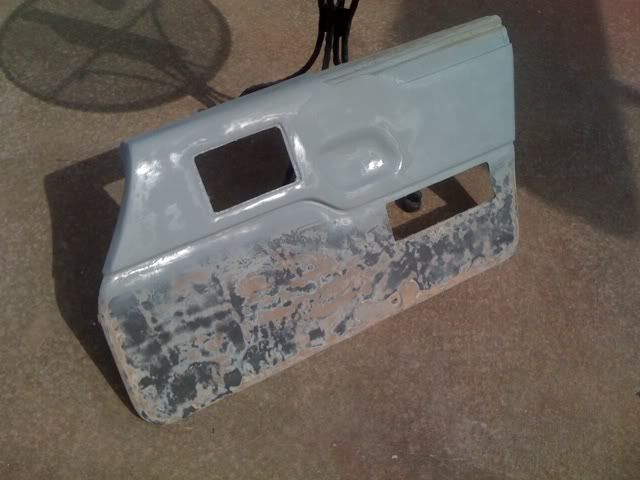

I've got updates but not as much as I would like - even though I worked ALL day. The day was spent sanding and filler holes in the door panel. I also had to work the area where the door handle trim piece mounts. The area was pretty rough and uneven.
I'm nearing the final stretches with the door panel.

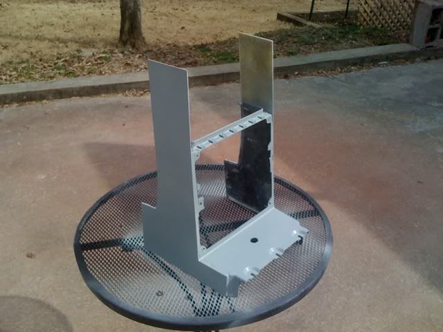

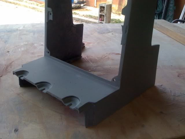

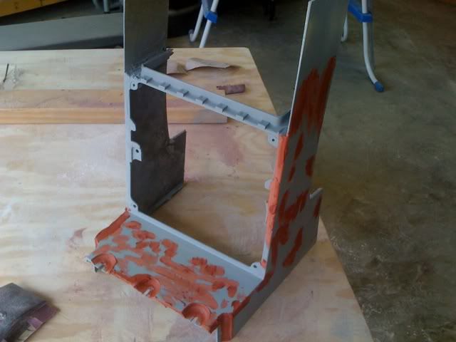

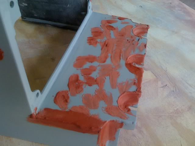

I primed the radio console. I was hoping to get a lot farther along with this piece but maybe this week or by the weekend.
Another with more glass added at the base
As with anything... lots of filling and sanding
Another

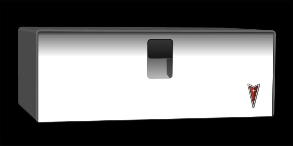

That's about it. Not much to tell. I'm hoping to just move forward. I am considering building a glovebox that would mount where the "aftermarket" gloveboxes mount. Here's the idea
It would be very similar to the armrest console I created - black, white lid with a smaller Pontiac Logo in the bottom right hand corner

Glove box =
Love it.
