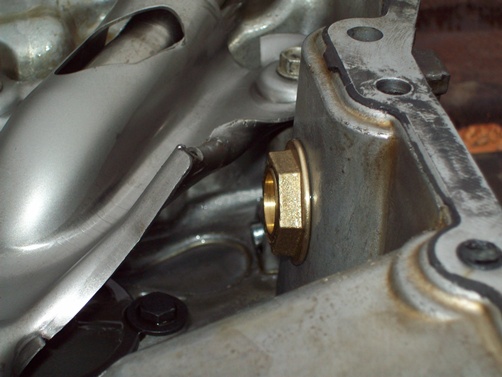

engine parts are supposed to be shipped monday , so i should have everything by wednsday .i have been busy rerouting hoses and i drilled a turbo drain hole in the oil pan so i am finally going to get rid of the oil scavenger pump .i also took off my inline fuel pump that has been disconnected most of the time it has been on the car.it just isnt needed and it did not work the way i planned it to so it is just weight for nothing .i have a bunch of pics to post but i cant seem to get them sized right to get pip to accept them .still looking for an easy to use photo program .
