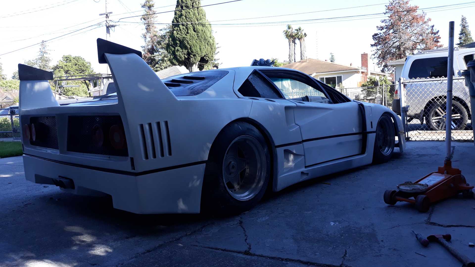

Firrario sounds like fierarri, and that was too cheese for most. I thought of fubarri, its def a fubarred fiero! But the fubar gives it away. Figured out the gun issue, operator error as usual. The first batch I mixed dried in the gun and only a small column of wet paint could make it to the tip. Sprayed everything w the lil touch up gun today, no issues other than operator error. As usual. Got a ton of drips touching up the primer. Moving the gun too fast and some primer would come out the air hole in the top. Durrr. Sandingwise I just keep finding tiny sub micron pinholes here n there n everywhere. This game of fill-a-hole is waaaay old. Lines on the hood were a bit off, had to cut it up a bit. Hit it w 400 dry, touched it up, shot the black. After a million rounds of filling today. Thought I was done, pulled it into the garage to shoot, found a million more. Some areas are just perfectly flat the sealer has a light gloss to it. I think its going to come out pretty damn good. The black basecoat friggin stinks wow

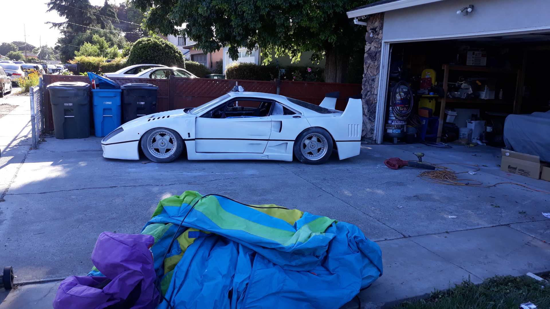

 Threw the lights and back winduh on, looks killer as a stormtrooper! Andrew this is just sealer but I did look for a white sealer because of the pic u posted awhile back. Imsa the gun has a 1.3 in it now and came w a 1.5 setup. I got the gun dialed in, the lil touch up gun needed to be dialed back- too much coming out lol.
Gonna spend a lil more time looking for boogers, Gonna see red this week. Maybe not clear as ill more than likely find even more boogers w the first coat of red. Its been crazy the whole car had teeny tiny microscopic bubble divots all over. Im pretty much thru my 4th tube of pro filler and sitting here typing, looking at the car 2 feet away, I see a few more boogers. Cutting the car up and shaping it was kinda fun, messy but fun. This friggin sucks! lol

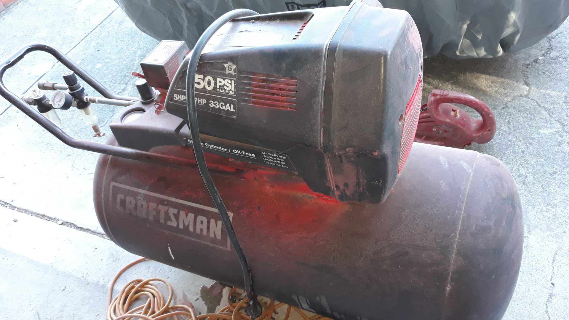

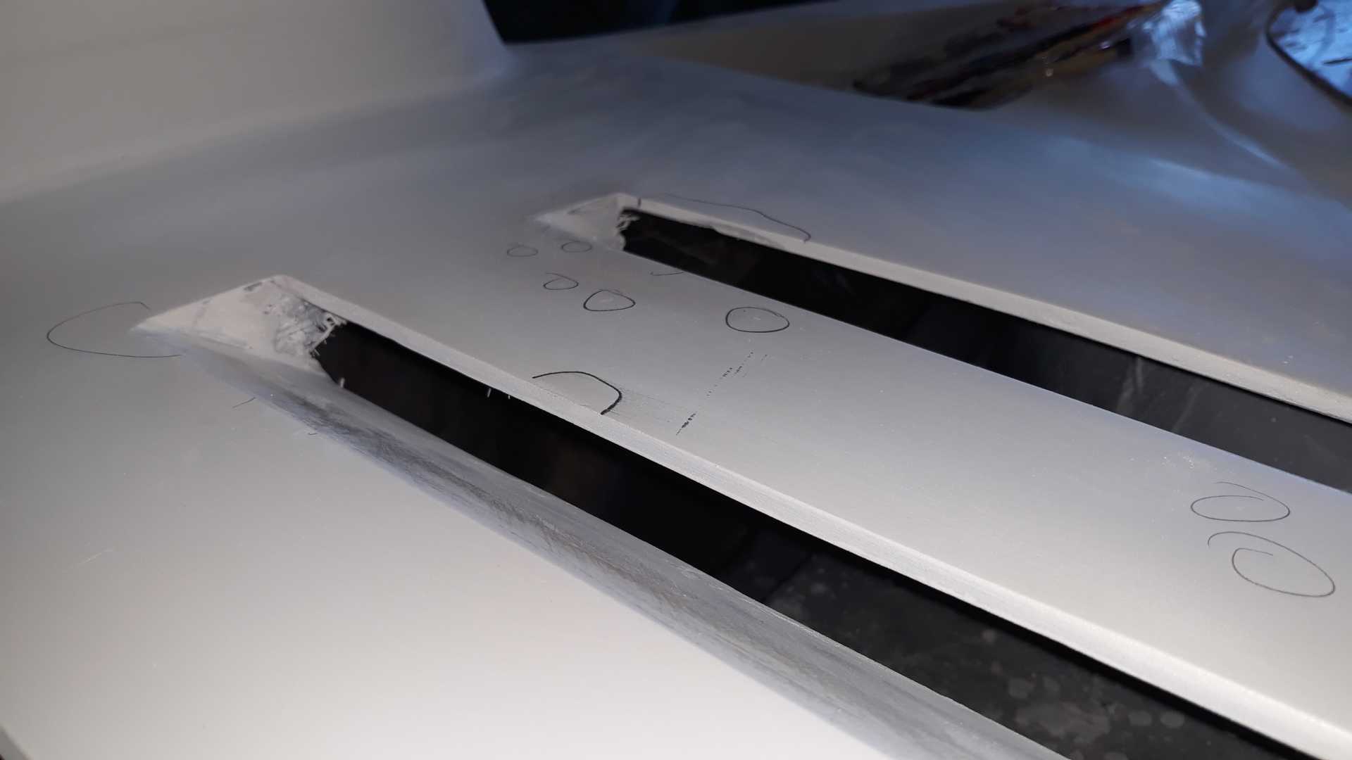

Thanks for the tips fellas I appreciate it! But its air bubbles in the bondo, bubbs in the fb, and air pockets in the dynaglas. Sometimnes the putty doesnt stick too. I brush off everything before spreading. Almost done, just being picky now. Did a cupla fb repairs. Im using a 33gal compressor w the little bronze color water trap. theres a dessicant filter too but no silica. I didnt shoot w the pancakes but they both had water traps. Heres what im doing
 lil boogers everywhere but im not finding many anymore. They will show in the clear so I gotta stay vigilant

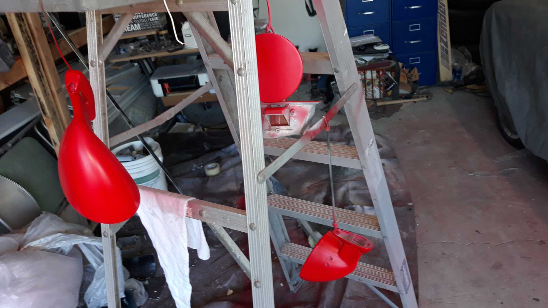

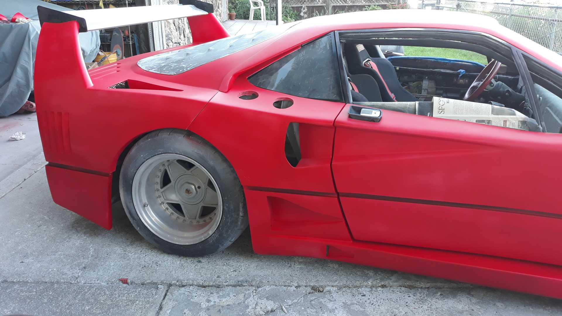

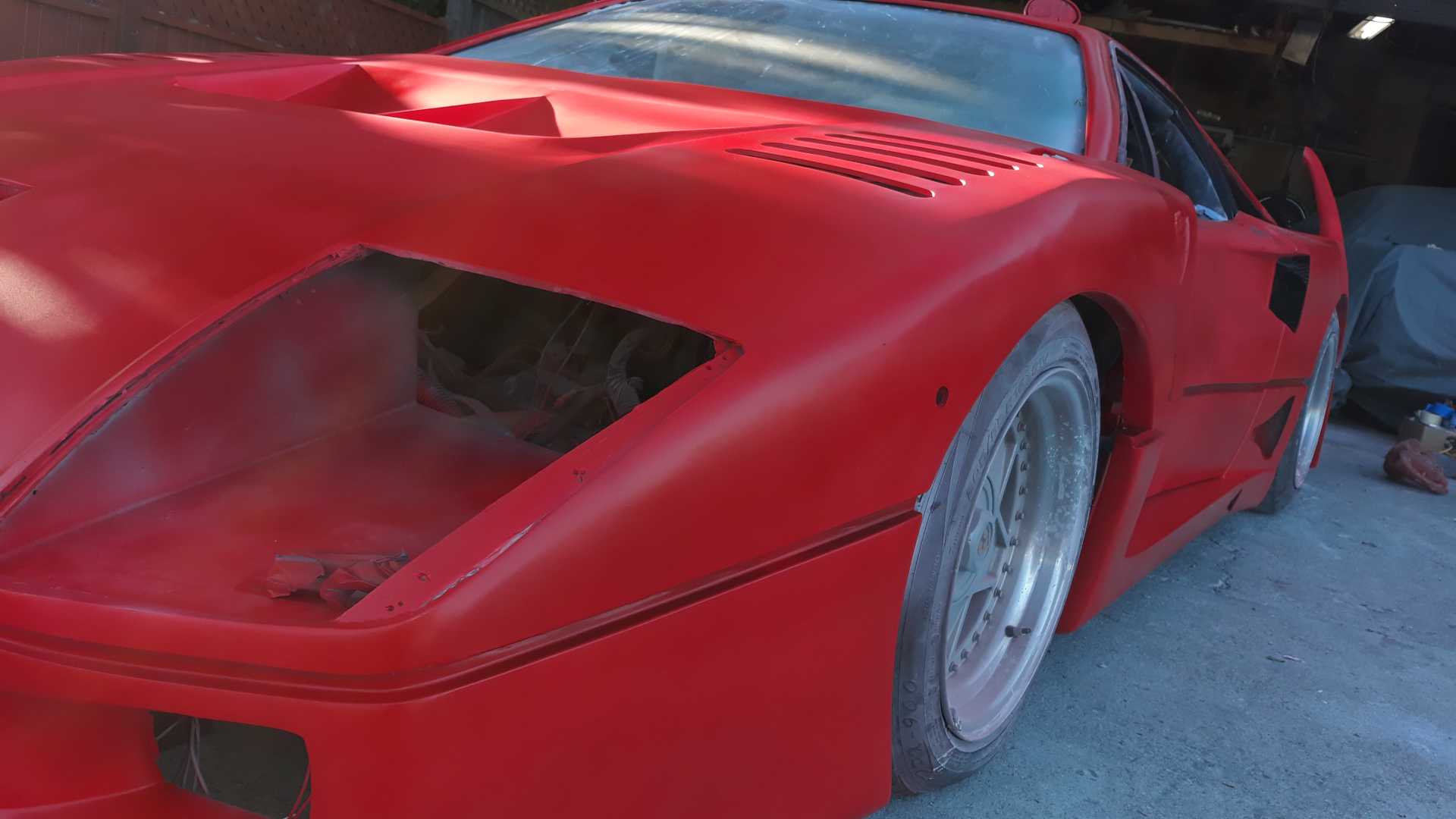

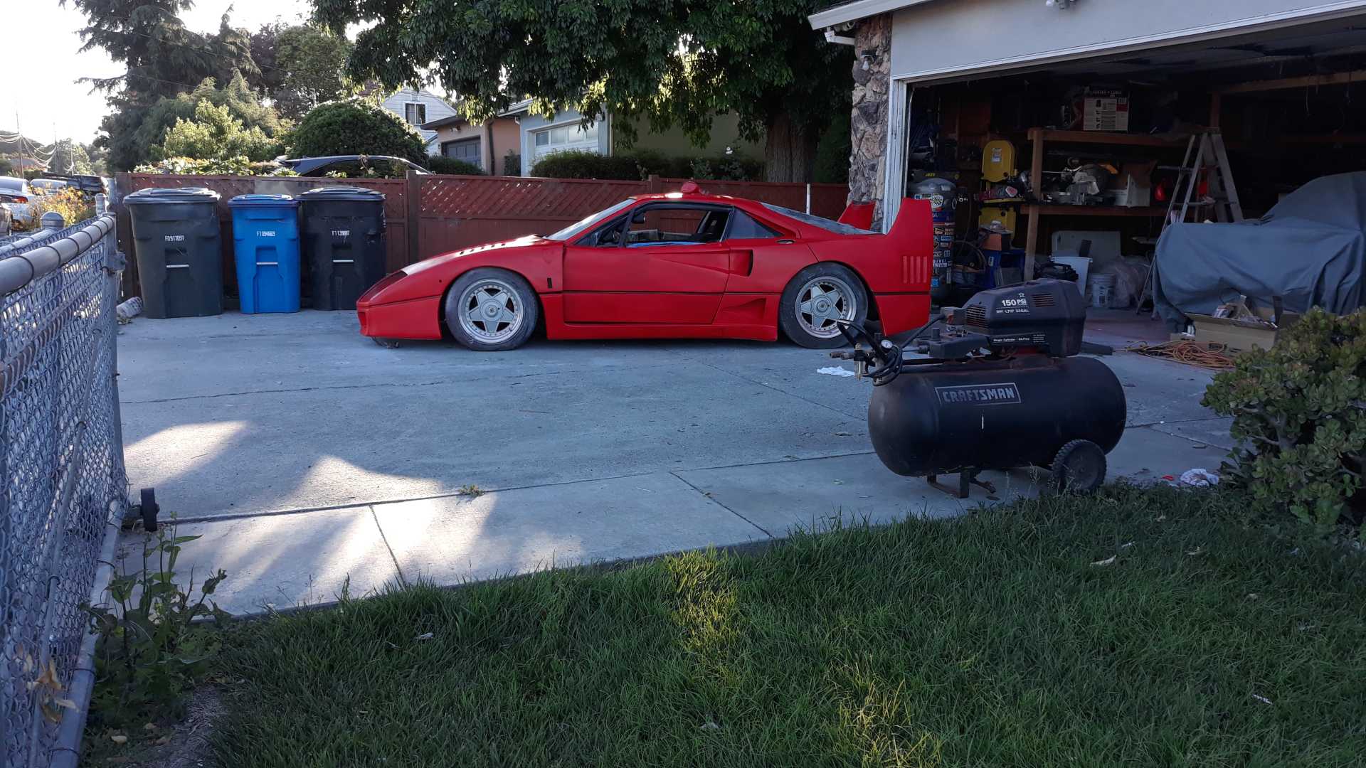

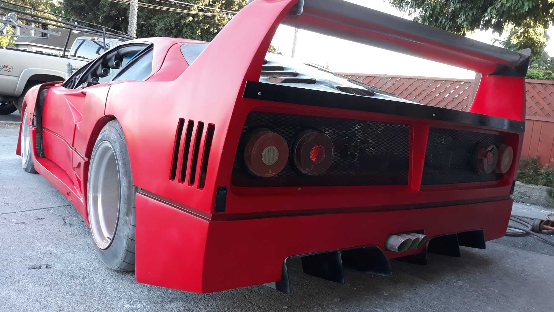

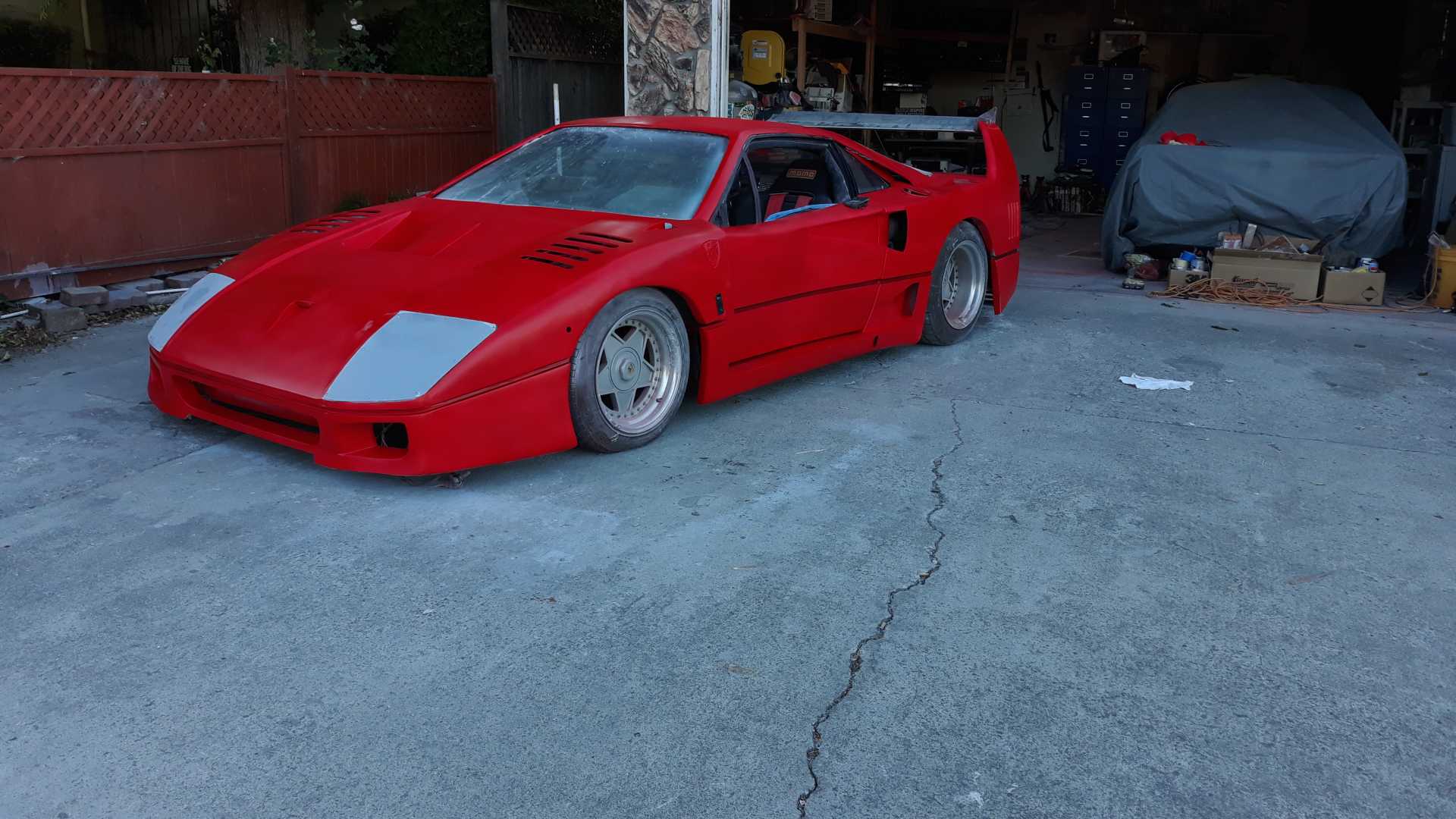

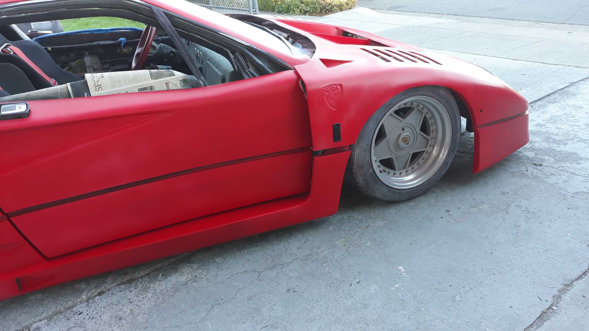

Tig ol bitties! Paint came out super good. Hit up a cupla boogers this morning, and the few that show just before paint after everythings cleaned. I found a cupla more boogers but maybe 10 mins work, its that good. And smooth as can be painting in a dusty garage. Shot the touch up sealer w the mini gun, and shot the red w the big gun. No Problems, no drips. Laid down some heavy coats too. Looks awesome wow. Pics just dont do it justice.
Dunno about the red tho, had a weird feeling as soon as the first paint hit the white. Its an angry friggin red! Like my roosters beady ass eyeball red. I really liked the white. Ill see how it looks w the clear n work on other stuff. Now other things that dont looks so good stand out because the paint looks so good.
Was kinda apprehensive about spraying, monday some city car was eyeballing me. Neighbor that lets me borrow that big compressor came over and told me. Somebody musta called. Im figurin w the covid thing, staffs thin and not working weekends. Of course right after I painted, I pulled the car out and a cop car rolls by kinda slow and one guys eyeballin me. I had the roof on a garbage can and the door panels in the middle of the garage, cuz told me the lackuh thinnuh could be smelt for awhile. I clean those guns out after each batch of paint now. Anywho, they rolled on.
