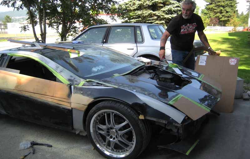

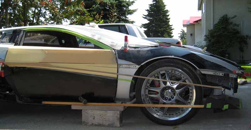

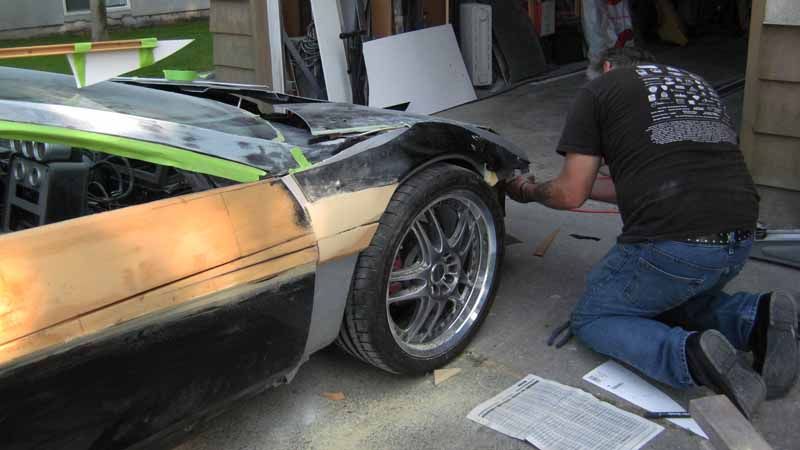

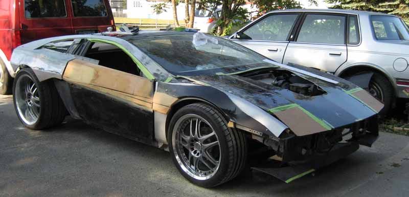

Today I had to tweak flowing line higher to meet front open wheel
Before
Sanding flowing line higher

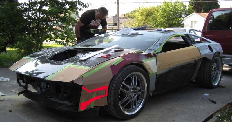

Red mark showing open wheel

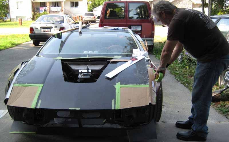

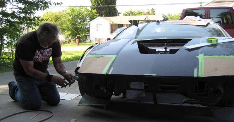

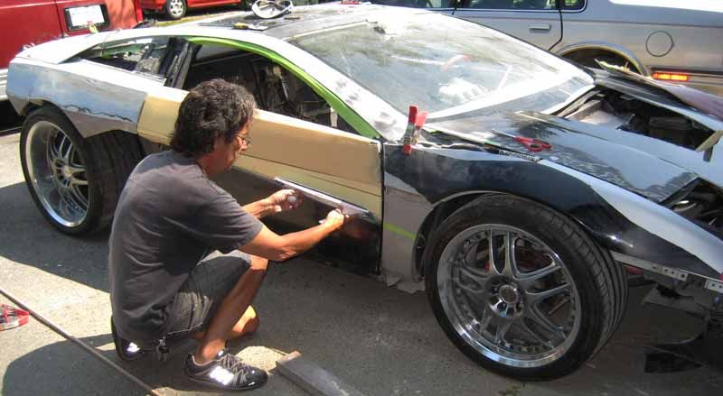

After that Clynt showed up and we had to mock up front end to make sure everything lines up
Red mark showing roughly open wheel

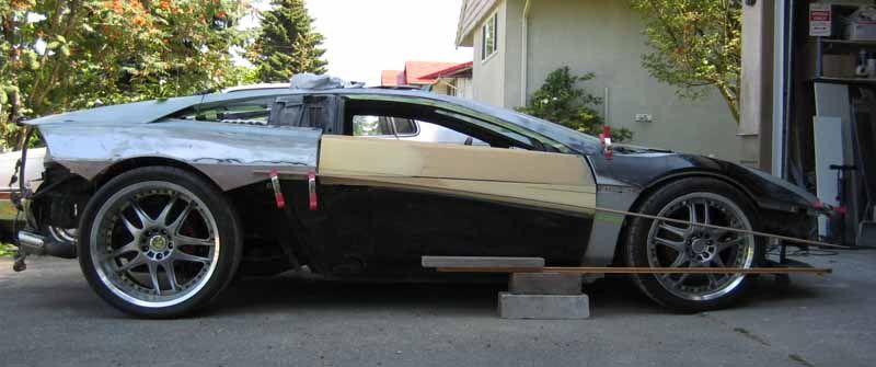

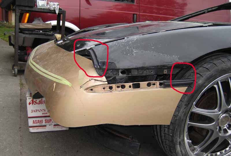

Maybe I missed it... Didn't you shave the front frame a bit to let the hood angle down more? Is that hidden under the temporary double fender?
I must check this thread like 4 times a day for updates. :-)
Front frame was lowered 2" and 2"shorter, red circles showing difference with stock fender and lower hood.
We curved fender tip down 2" to frame and hood is also bend with same curve, it's subtle and make big difference with overall view

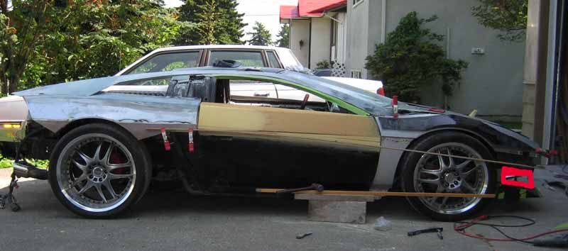

Not hidden, notice curve on silver fender pic below, it has more curve than pic above showing stock fender with little curve and 2" higher that hood.
Notice silver fender curving low to front
Hope that helps a bit

355Fiero JUL 29, 02:27 AM
John;
Does the door front edge still end in the same place as oem? I am asking to confirm when opening the door that there are no clearance issues with the reconfigured front fender. Lots of replicas end up with this issue so clearance needs to be thought about for full open position. I think u have that covered as I see the door open in a couple pics. Something to think about is all.
