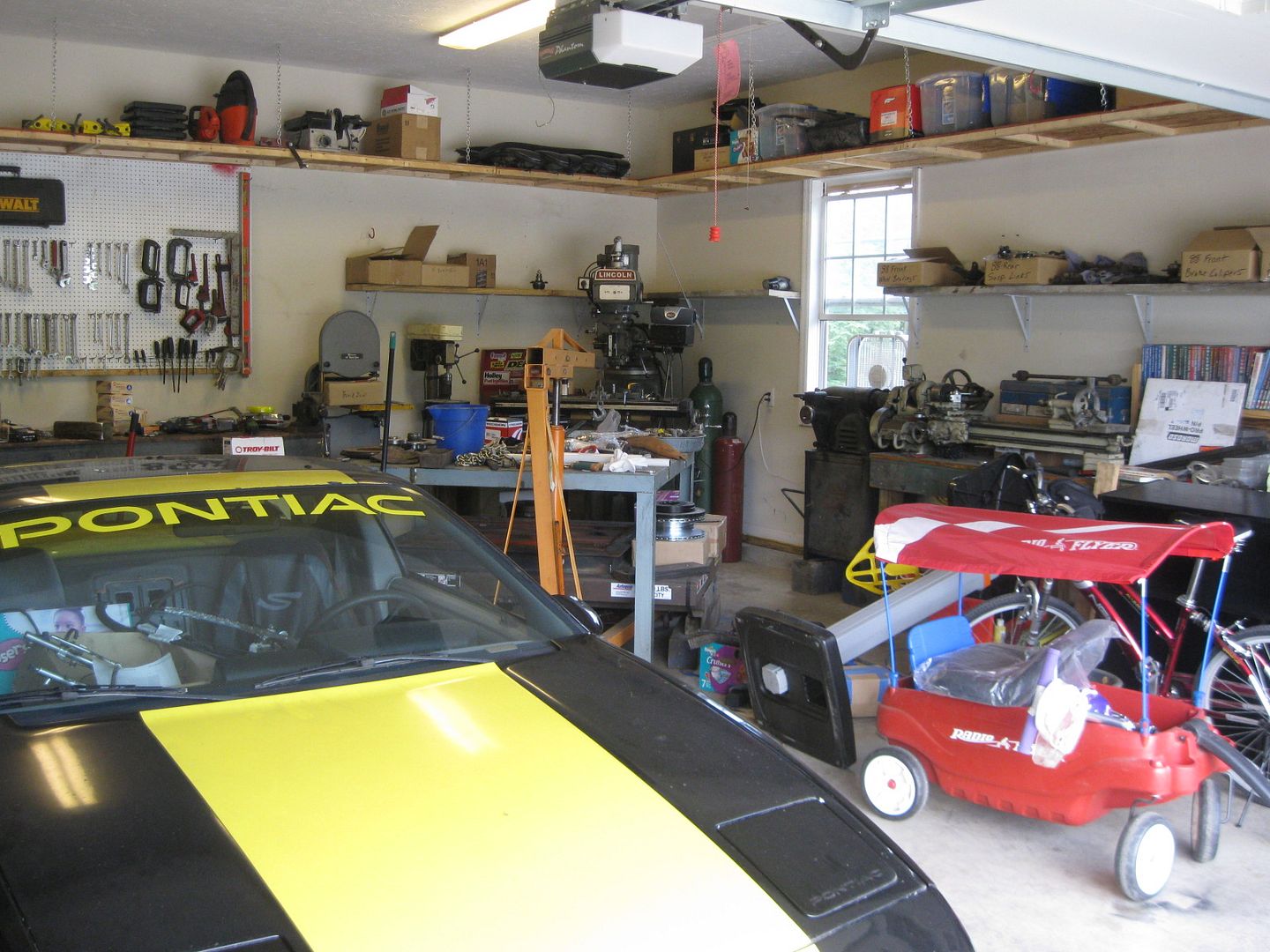

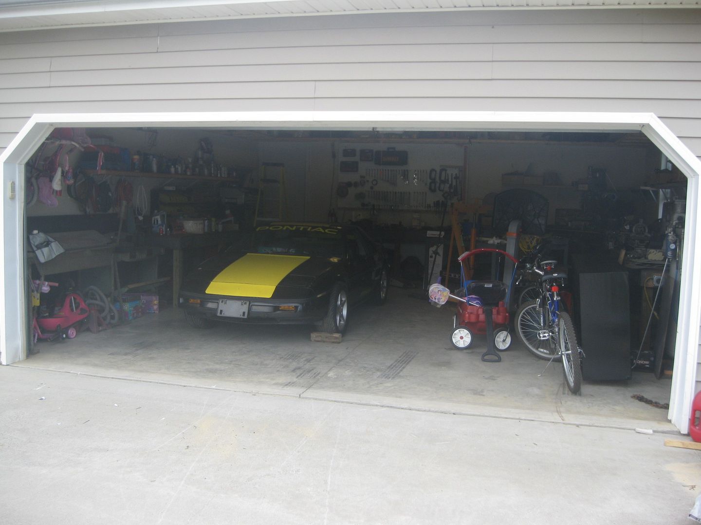

Finally got the new garage to the point I could fit the LS4/F40 coupe in it... now I just need to get focused on actually working on it again!

Nice! Looking forward to seeing more updates and seeing how your flywheel/clutch works out.

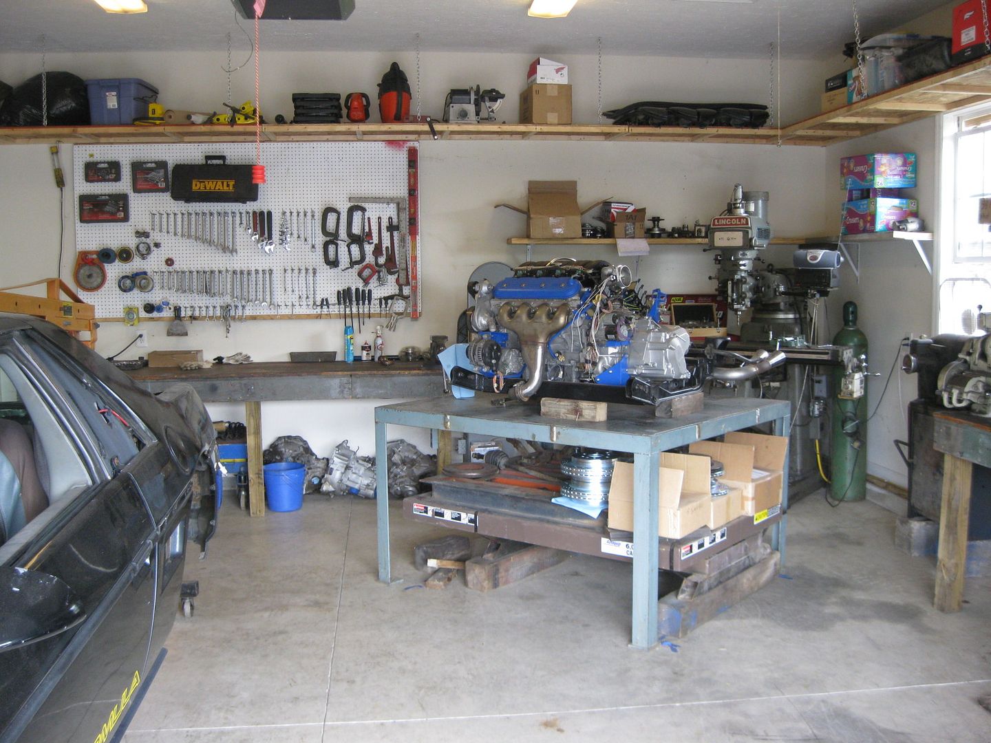

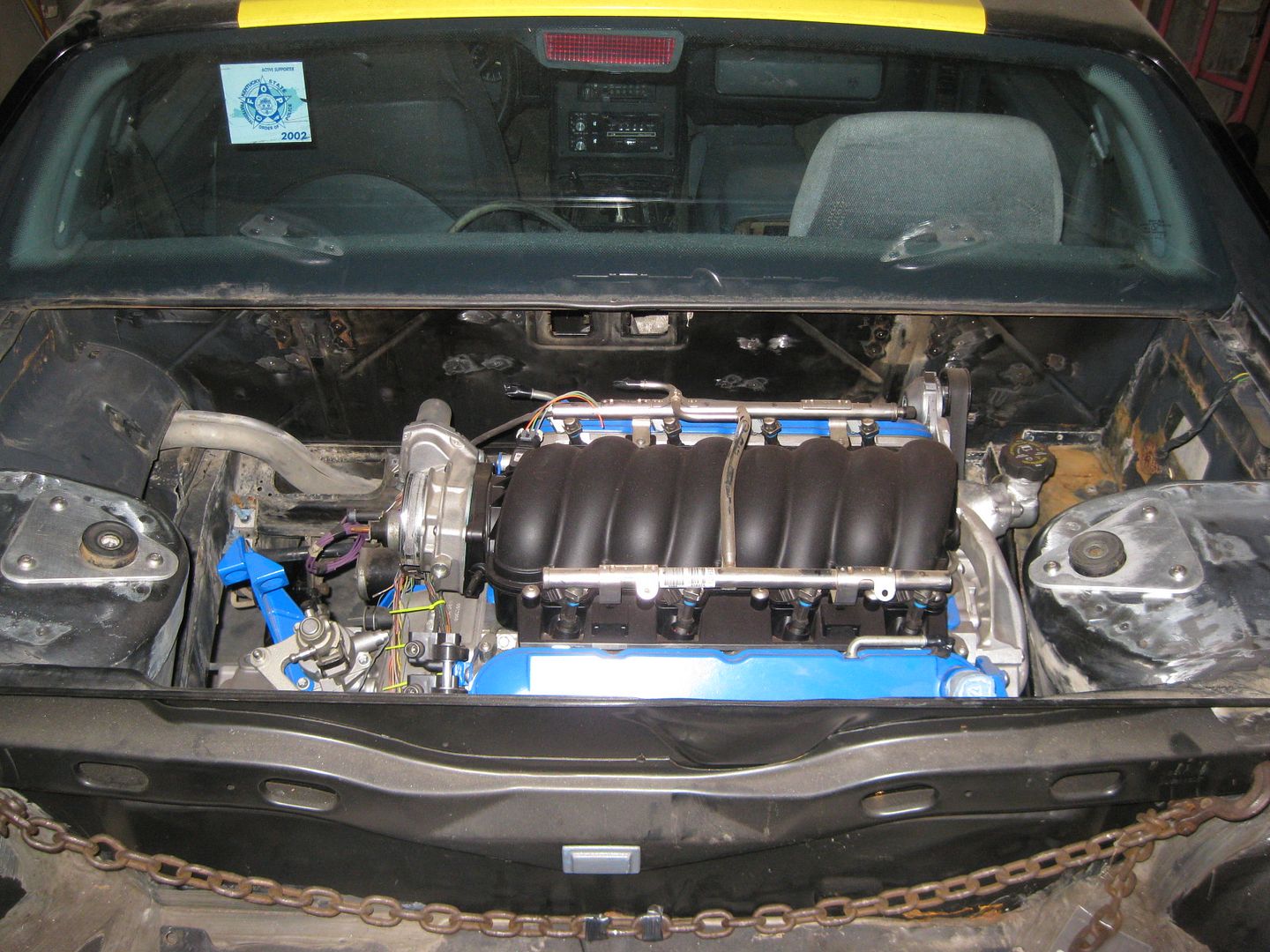

I was able to get caught up on my current honey do list and worked on getting the LS4/F40 back out of the chassis so I can start working on it some more.

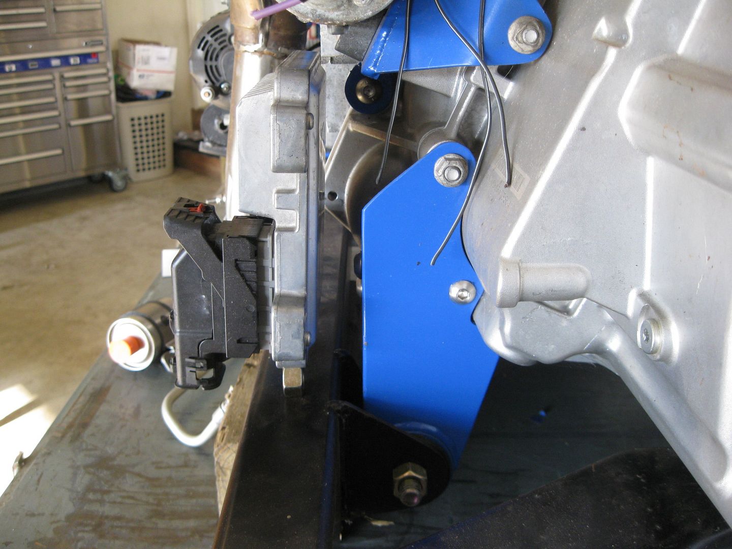

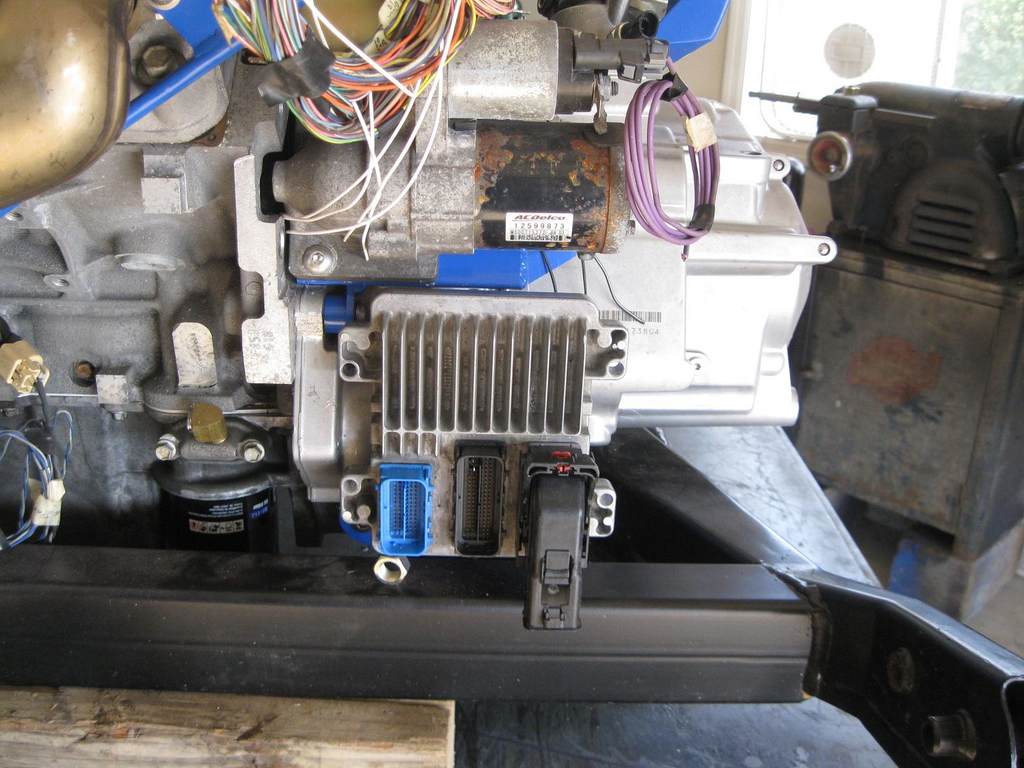

Today I ordered a bunch of needed parts: backup light pigtail, 100 ECM pins, AN fittings and PTFE braided hose for the fuel lines, replacement AC compressor hose, and rubber isolation mounts for the ecm. I think this is the place the ecm will be mounted. I just need to make a couple of brackets for it off the start mount and the front transmission mount.

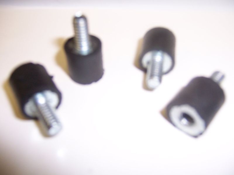

GM doesn't normally do a clean/space efficient job of mounting the ECM, so I just planned on using these rubber isolation feet bolted to a backing plate that bolts to the front transmission mount. The 4 feet were $12 shipped. Sorry for the crappy ebay pic.

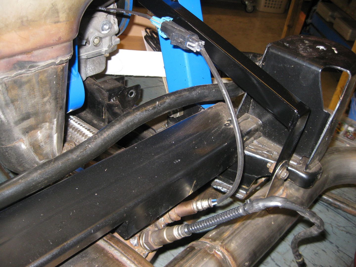

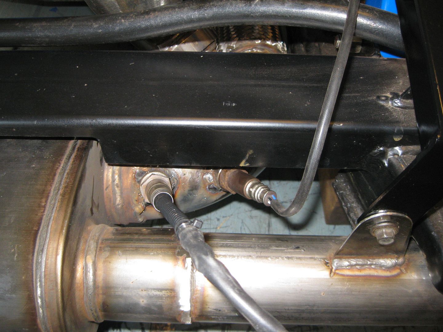

Tonight I welded in the two O2 sensor bungs. One for the ECM and the other for the wideband:
Then drilled the muffler support bracket to accept the harness side O2 connector:
I needed to get the o2 sensor located so I can start building the harness which starts with the camshaft sensor and the O2 sensor.
