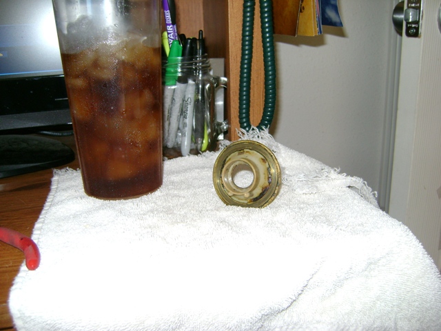

have spent the morning attempting to rebuild two of my rear calipers. I have them back together, but I am sure that they will work as they are supposed to.
I don't see a need to send the sliders with the calipers either. They were not an issue to install. These were original slider boots , not The Fiero Store boots.
Joe
I just took another stab at these two calipers. I have been able to do it all correctly except for getting the parking brake screw bolt and it's seal back in the hole at the rear of the caliper. You will not know if it is in correctly until it is seated all the way in the back of the caliper. It is difficult to insert the piston past the piston seal.

I just spent two more hours working on the two rear calipers again. I have figured out how to get the parking lever bolt and its seal back in the bore on the drivers side caliper. It is ready to be put back on the car. The passenger side is together but I am nor real sure about its working correctly or not. It just didn't fell right as the piston went in the bore. I removed the piston and placed it back in a second time. All appeared well, but who knows.

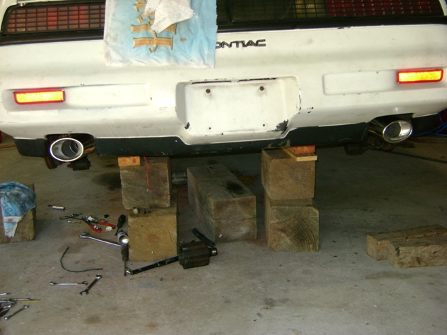

My welder friend came over this morning and we tacked the tips to the pipes. I dropped the exhaust from the car so we could weld everything up good. After a good cool down period I put it all back on the car. I like it, sounds pretty good too.

I took the passenger side caliper apart and replaced the one seal I was unhappy with. It went together right the first time and was seated and sealed perfect. I put the rest of the parts on it. I now have two fresh rebuilt 88 rear calipers ready to go back on the car. Tom Slick donated me two 88 slider boots last week, and was kind enough to send me one more so I can get this car back on the ground.

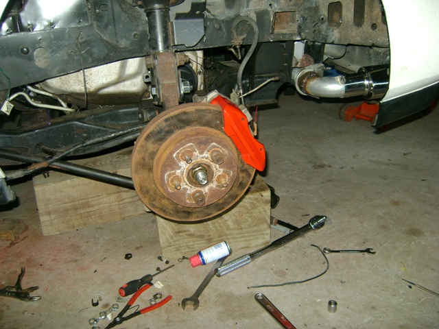

I had painted my bridges a few days ago, and had them out in the hot sunshine 'baking' since. On the drivers side rear:
