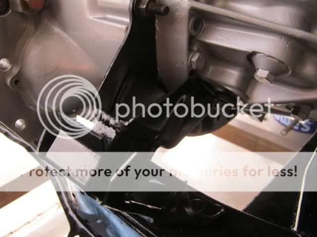

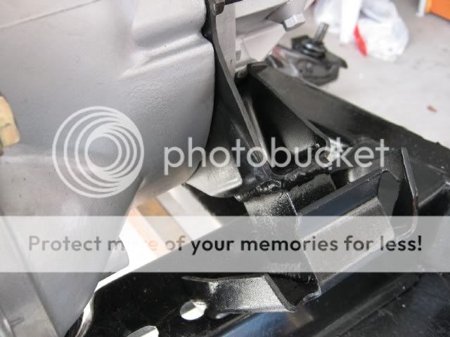

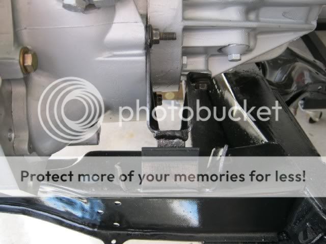

I'm shooting for a motor stuff next Friday/Saturday - just waiting for the headers to show up. I have a few little things left to button up but I will get it all done this week. Finished the solid trans mount this morning after fixing the tail lights on the XTC and installing new locking hood pins. The mount turned out great. I am debating on messing with the other one - it's in a lot better shape than the one I built and not near as soft and flexible. I'll look at it a little closer this week.
Here's the mount!

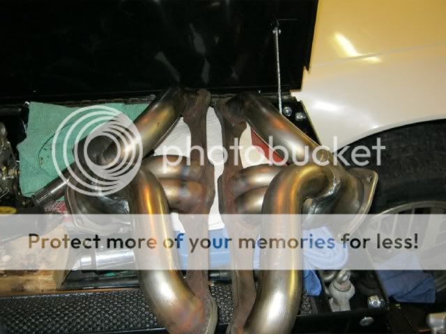

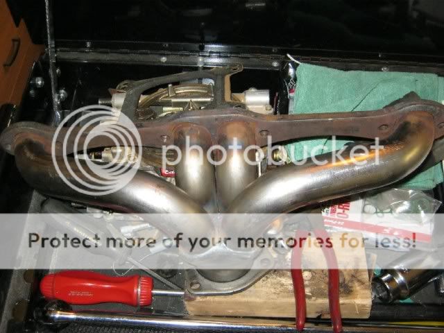

In the box - my new Shorty headers. Now I hope they will fit. I'm a little worried about the firewall side! It will be close and I may have to build a heat shield on the firewall? I'll know for sure Friday!
And the new headers:
I will install these bare so that I can build the exhaust and strat the motor for break in. Once it's all up and running, I will take the headers off and send them off for ceramic coating. This was the last piece I was waiting on to finish up the V8 Coupe's new motor. Maybe I can have it running this weekend????

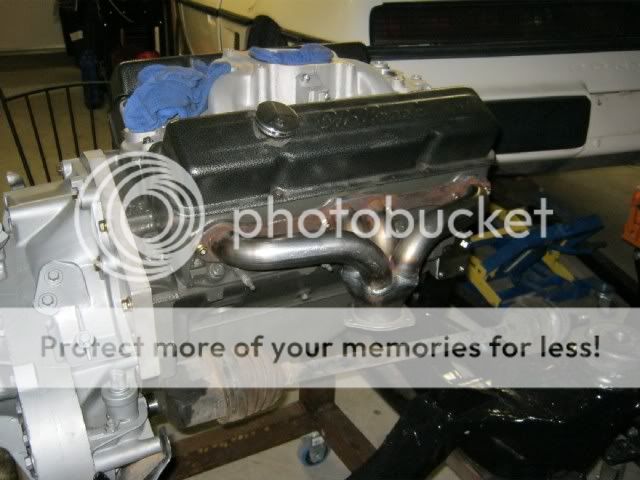

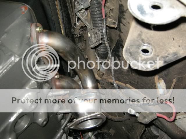

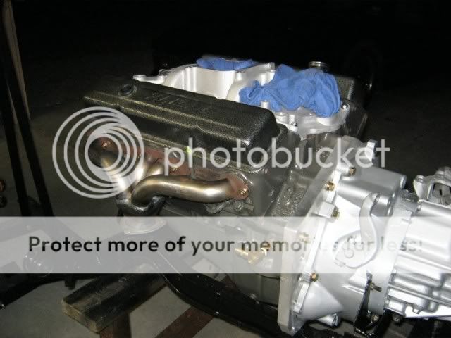

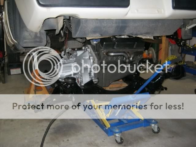

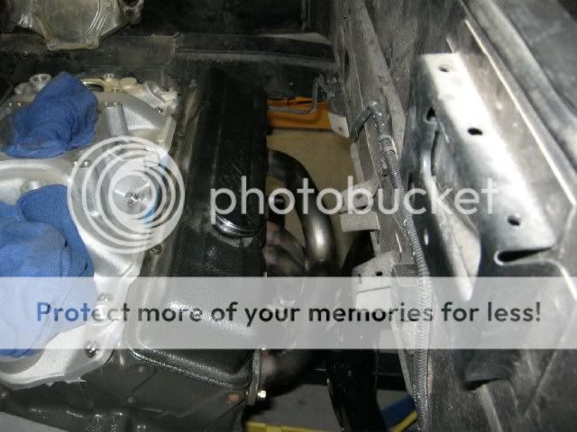

This evening, I decided to bolt on the headers and slip the motor in the car to check clearance. I was worried that these headers may be a little tight and I think I have to do some "engineering" to get some clearance both trunk side and firewall side. I was more worried about the firewall side but it actually looks better than the trucnk side. I have to remove the heater lines on the Firewall side and maybe relocate the crossover coolant tube/hose. The truck side looks to be a little tighter but I am planning on cutting the truck anyway so I can incorporate the "clearance" into the truck cut. Seems like a lot to do just to be able to use these headers but I was planning on the modifications anyway.
Motor with headers:
Slipin her in!
Firewall side:
Trucnk side:

kennn DEC 03, 02:38 PM
Hey kat,
Where did you get that interesting looking jack for the motor/cradle assembly? Looks trick.
Ken
