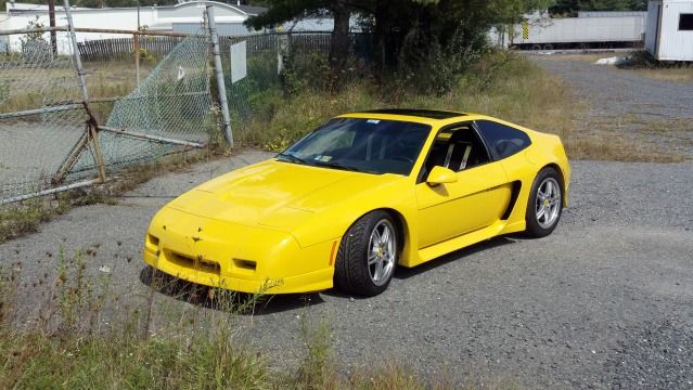

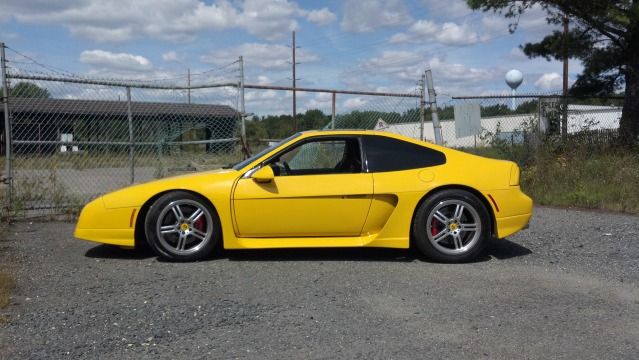

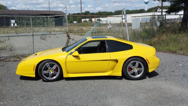

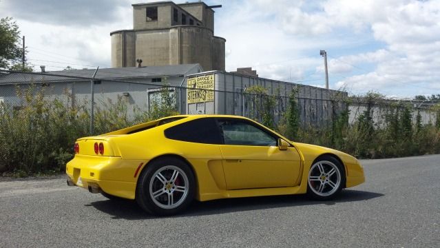

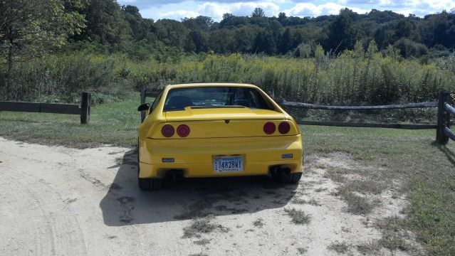

I took Charlie's car to the outskirts of town and took some pics near the abandoned factory and other rural areas. I've probably put about 300 miles on this car in the past two days.

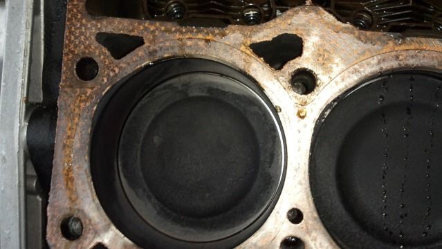

So, Charlie's car was ready to go home and it started getting slower. I did a compression test and leakdown test and our worst fear had come true....we lost cylinder #6.
The sad part is it was still faster than most 3800 Fiero's on only 5 cylinders.

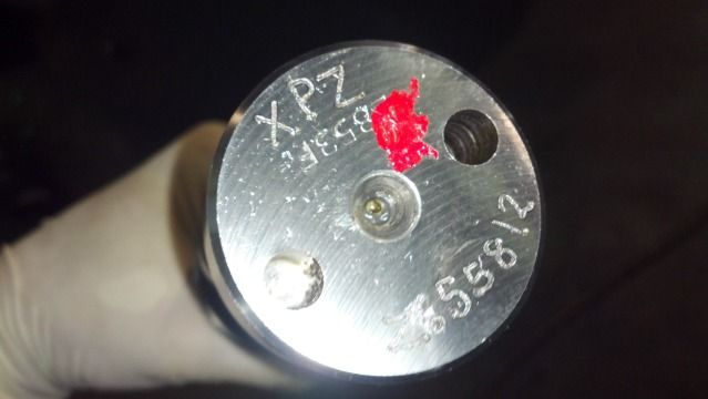

I spent two days and got a low mileage series III short block and switched all his parts over. Since Charlie is a good friend and customer (even with his Mercedes-Benz), I bought him a present for his short block as long as we were digging that far...The XZP cam.

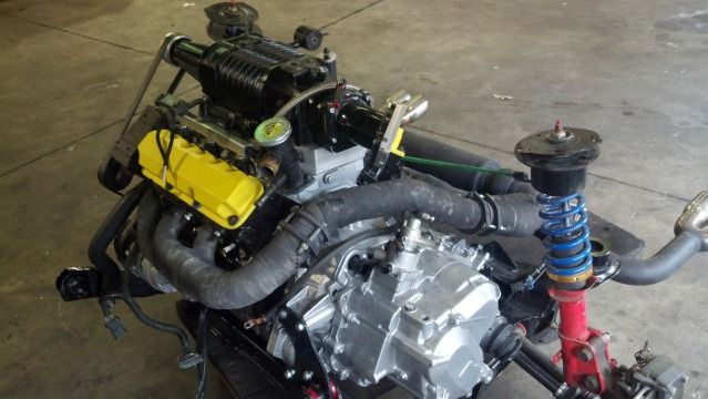

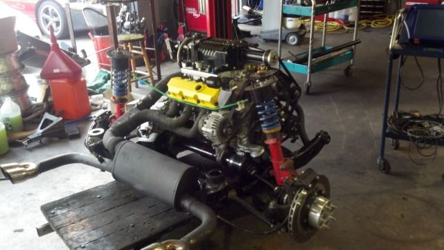

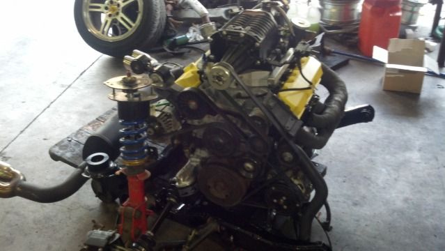

All assembled and ready to drop back in...
Should be on the road again Monday. We also modified Spec's slave cylinder shim. It rattled really bad. If I have to do another 3800s/c/F40, I will either make my own shim or make my own flywheel.

The replacement engine was from a 2005 Grand Prix. The junkyard was baffled when I told them that I would be stripping it down to the short block and I wanted a "professional warranty"....basically my word that if there was an issue with the short block, they would not try and say it was my fault. I had to get the motor built and running in a reasonable amount of time for this as well. I performed a leakdown test on it and it runs nice....so we should be set.
