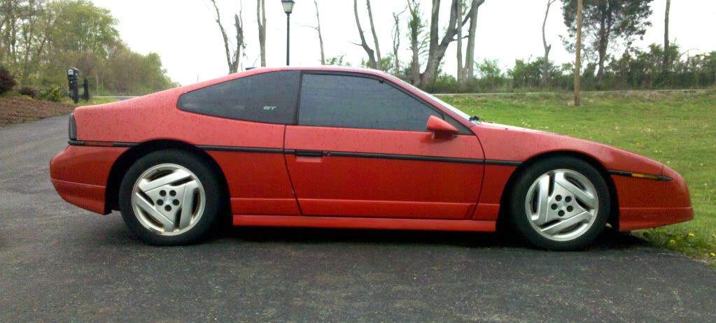

I also added another 88 to the personal fleet this weekend. I call it "4cyl fastback" because that is what it is. Started life as an 88 coupe 4cyl/auto and underwent a GT conversion except for the engine/tranny. This will be my daily driver shortly. I will get this one weighed as well, then eventually swap in an isuzu and reweigh it.

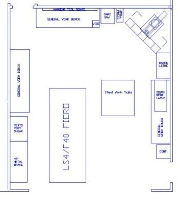

Found a house, offer was made and we have a purchase contract. Closing date is June 8th and I have to be fully moved by June 30th. My new garage is 5' narrower than my current one (larger one will be built in a year or two), so I had to figure out where everything goes in the new place. This is the general location, but subject to change:
[This message has been edited by fieroguru (edited 05-07-2012).]
