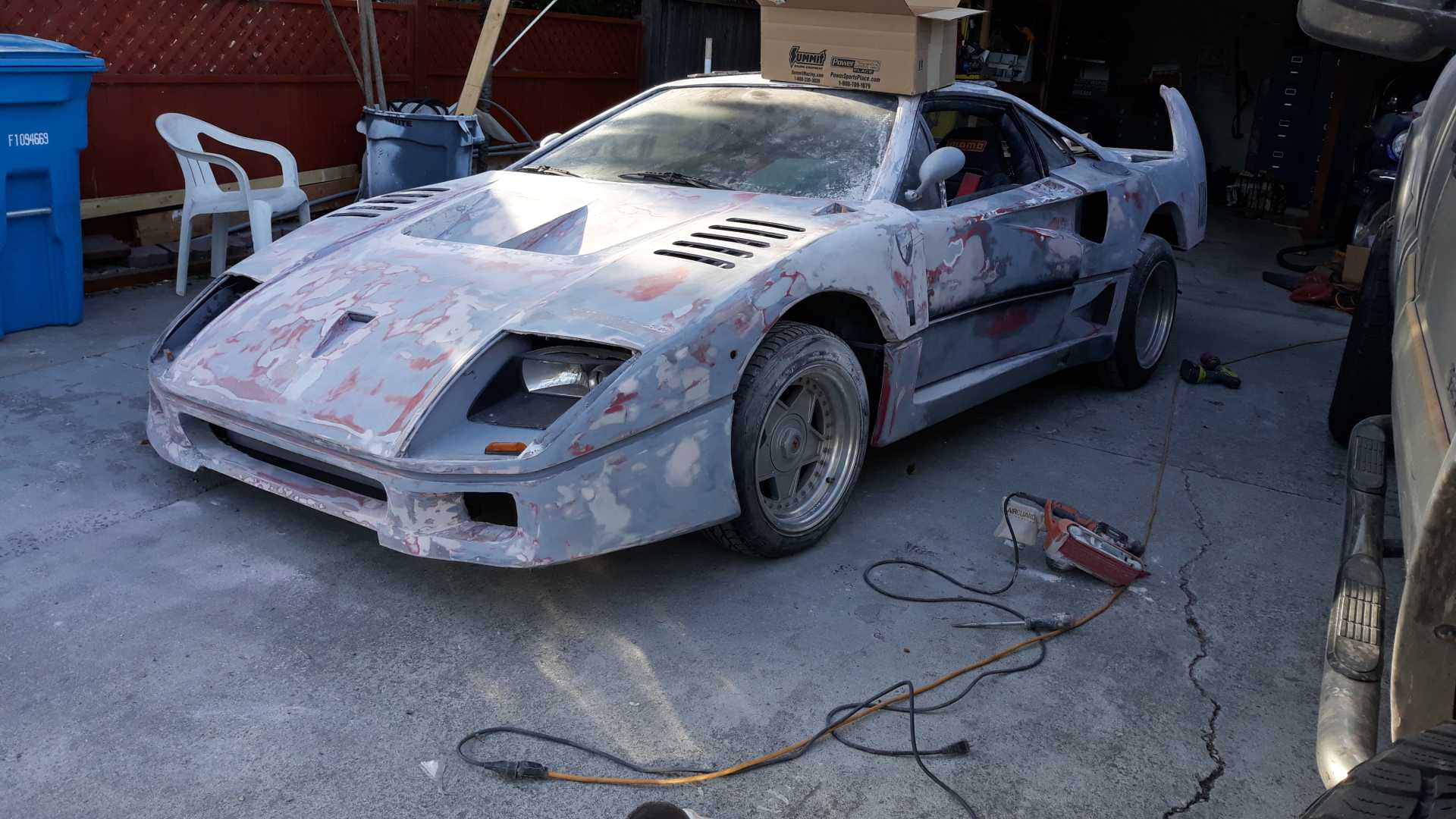

Got mosta the hood and roof sanded, lil bit to do on the a pillars.
 Neighbors kid across the street came over to check out the car. Is this a 1992 ferrari f40lm? the kid asks, turns out hes a huge ferrari fan and proceeds to educate me on the history lol. Couldnt tell the difference looking at pictures on his phone, all the details were there. Made me smile

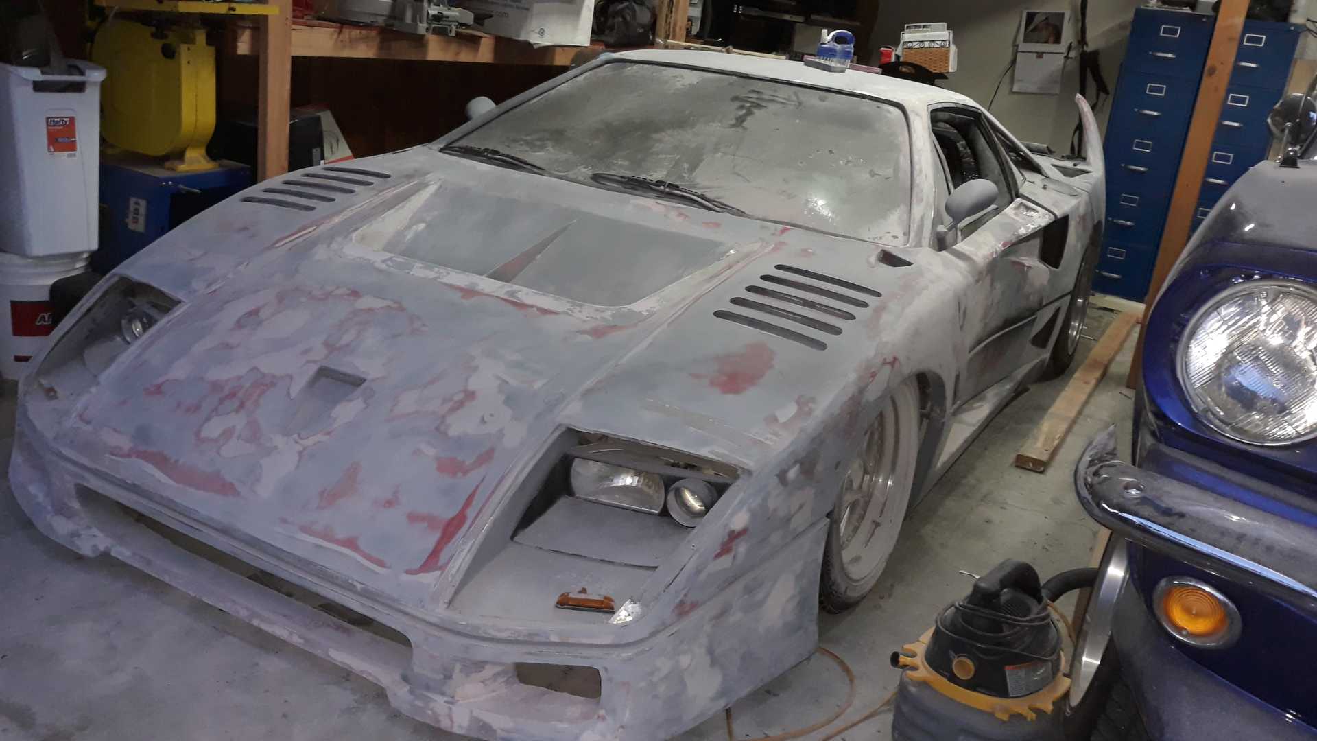

I am being picky but I know ill miss a bunch of things I wont see until its painted. Ill be painting this a few times for sure. Itll be a gudenuf paint job, im thinking gudenuf will be the license plate. Hoods taking a buncha time but coming out really good. Finding and repairing lotsa low spots. Hoods very close to being ready, working the wheel wells now. They need lotsa love for sure. Got the big compressor hooked up, just need some 30wt. Looking forward to painting w the right compressor, shooting the primer w my lil pancake compressor sucked
 Gotta stop playing hookey and get back to work but its going to be tough lol im pooped Rather spend what little energy I have sanding the car lol

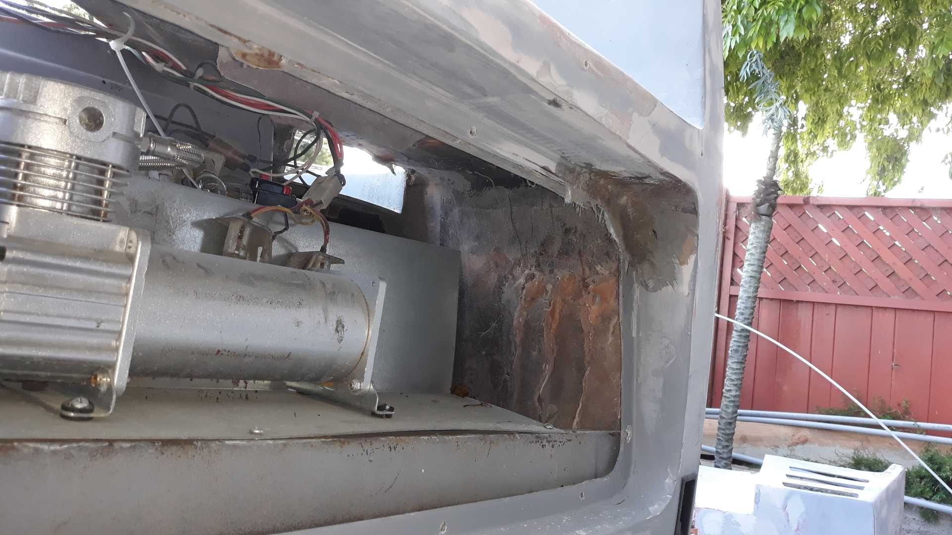

And I did, I spent most of yesterday on the car attacking details I skipped over before. Beefed up the lower hood edges near the latches, extended a scoop, and beefed up the inside of the area I cut up recently. Cleaned up a buncha nastiness under the hood. Did a buncha sanding and glassed a ton of areas. Just one more area to glass and its all filling details.
Had to get at a cupla spots in hyah too
Major love to wheelwells, airbags make for great access

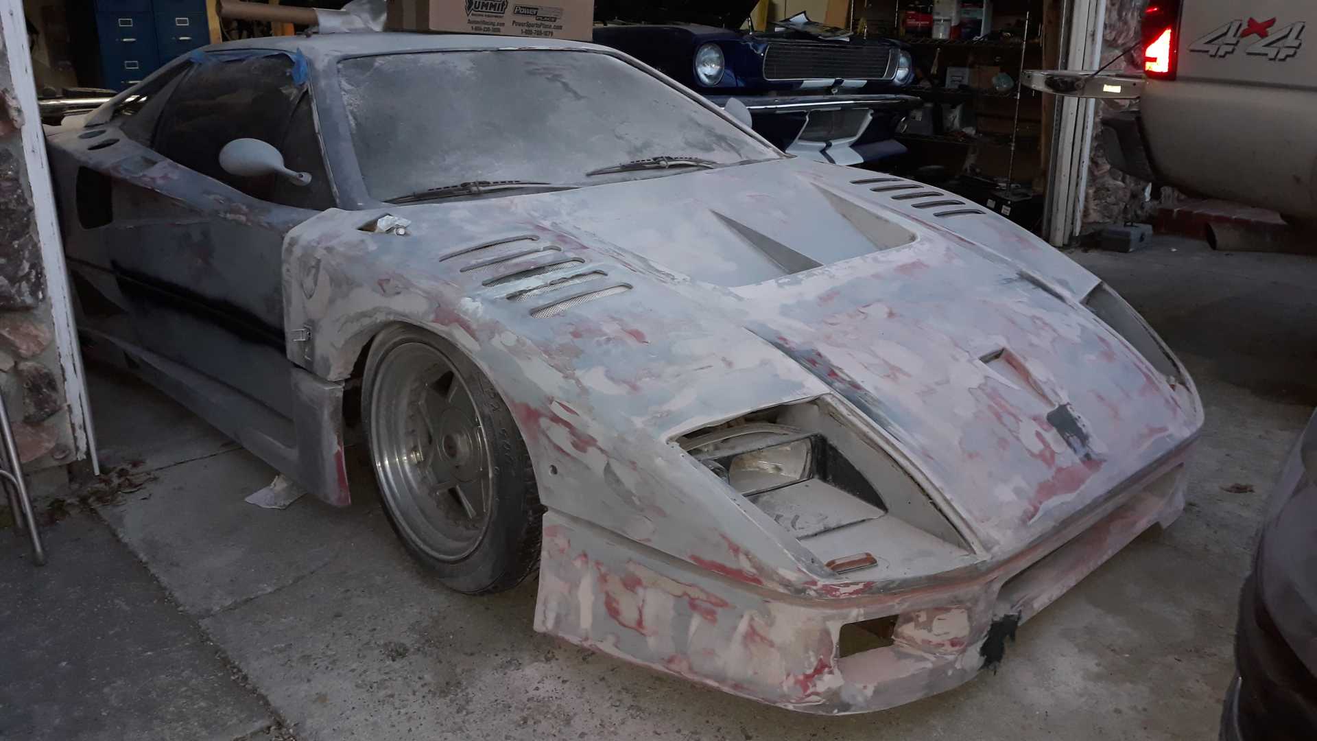

I have maybe another 50 hours in sanding in this week, been going to town. The groove in the hood needed a ton of love, I made a bunch of custom sanding blocks from wood stakes and plywood. For my arch nemesis the rear vents, I sanded down one of my long sanders and its working out perfect
Todays going to be all wet sanding and cleanup, dunno if ill paint today. Def dont wanna paint w the pancake. My cuz nextdoor has another one, maybe ill pipe the 2 together worst case scenario. Or pipe them to the 60 gal tank,options options. Always a million things I fergit to mention but, yeah you get the idear. Have a grate day!

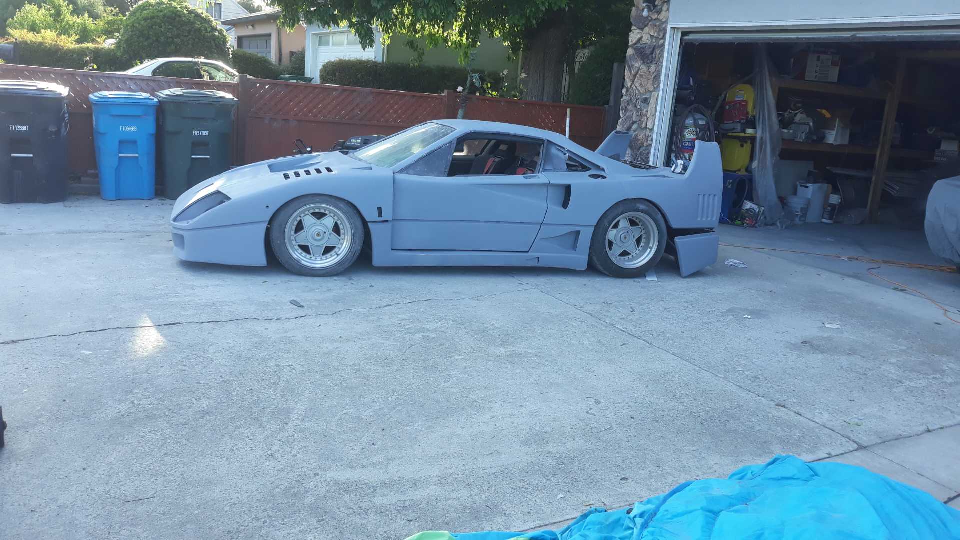

Thank you sage! Almost to paint now. Wet sanded w 320, wiped it off and saw tons of orange peel and a few billion more divots, pinholes, and small air pockets. Lots of em, wow lots of em. Went over it w 120, shot another coat yesterday evenin. Outta primer now and found a few more pinholes but it looks very smooth and even. Going to fill the rest of the holes today and hit it w some 400 afterwards, everythings easier to see when its dark grey and clean. Glassed a bunch more areas around the wheel wells and some other spots, being pretty picky and anxious to shoot the paint. No drips this round, got the gun and me dialed in. Kinda small pattern, feels like im painting w a pencil eraser or lil bigger spray can. Used to my house sprayer, that thing kicks out a ton of paint in a big fan. Im really going to town on this, surprised how picky and detailed im being. And how long its taking! Here it is, in gray, again
 Looking good, all edges are sharp(thatr supposed to be), everything fitting good, cleaned up the thicknesses of panels thatr uneven, lotsa nonsense. Even got my arch nemesees the burr, I mean rear vents(sorry too much moonshiners) looks perfect. unlyke my speling. Every coat I find more thing that dont look good that I take care of and I did a lot of housekeeping on this round. It looks really good close up. Found a neighbor that had the 33gal compressor in the top pic. Thing took forever to fill,I checked it it was at 140something(150 max). It shut off soon after and I closed the garage door and its pitch black inside, I knew I had the lights on- maybe someone shut em off. Checked em, switch is on, maybe the breaker? Yep breakers tripped, turn it on and hear the compressor just trying to pump lug lug lug and the breaker pops. I just laugh, gonna shoot off the tank then run the lil pancake compressor. The air suspension compressors pull way more power at higher tank pressure and trip my cars breaker. Figured that might be the issue w this, tank got low, I plugged it back in, it choked a few times and purred like it should. Didnt let it get over 130 psi and it was all good!
