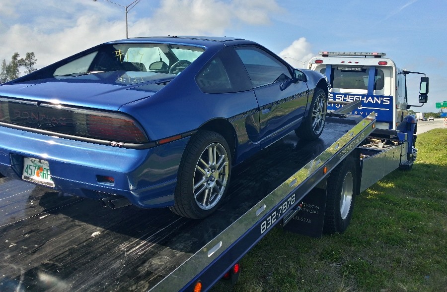

Well, it has been a crunch trying to find the gremlin that has done an excellent job of hiding himself in my car! Thanks to many on the forum, and especially here locally, Dean and Lou, I think we got it! What a NIGHTMARE THAT WAS!
So, hopefully this was the LAST time that I will snap another picture like this.
Headed North bound on I-95 a couple weeks ago:
TXOPIE MAR 23, 01:49 PM
John...glad to see her all put back together...sorry it is on the back of a flatbed...but I have been there B4!
