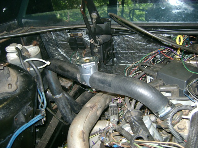

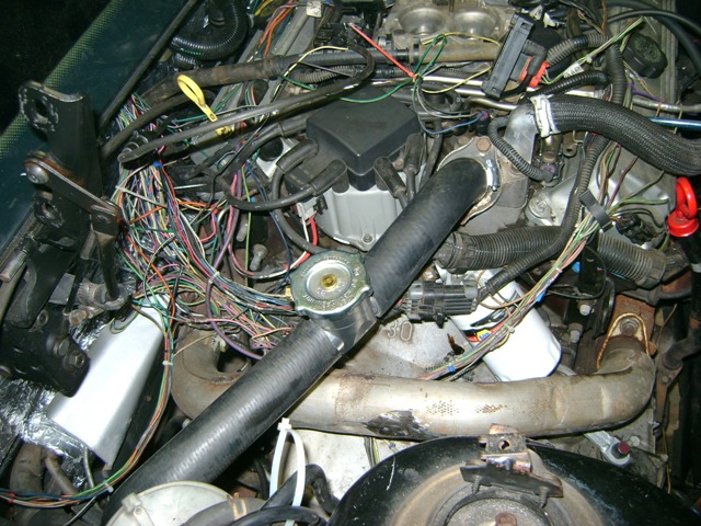

Routed the coolant hoses today. You can not tell it by looking at he pictures, but there is 5" space between the crossover pipe and the inline filler and its hoses. I only had one hose clamp. I'll get four more tomorrow, and a 55 Torx socket so I can remove the two rear calipers for rebuilding. I have the kits and all here now.
Added 3 quarts of Dexron III.
I ran a wire from the starter solenoid to the battery so I can by pass the key switch to engage the starter.[This message has been edited by josef644 (edited 06-13-2010).]

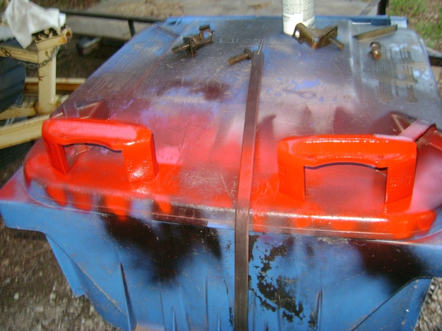

After dinner I cleaned the two rear caliper bridges and used some red caliper paint I had on them. This is the only part that can be seen threw the wheel anyway.
