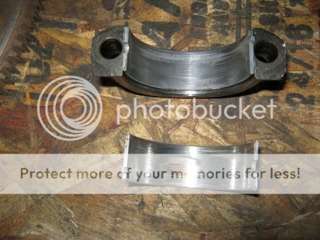

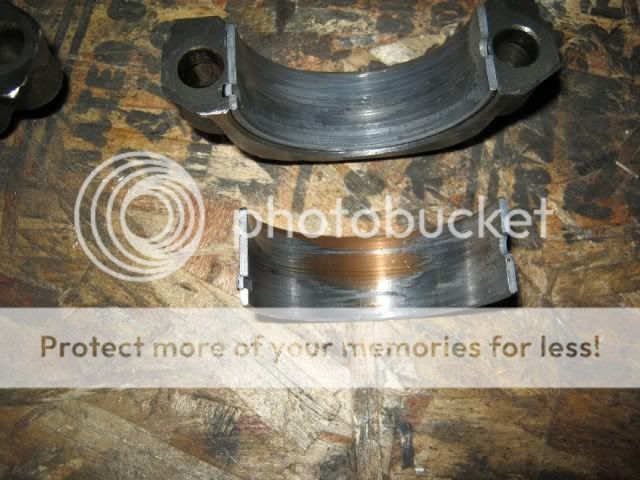

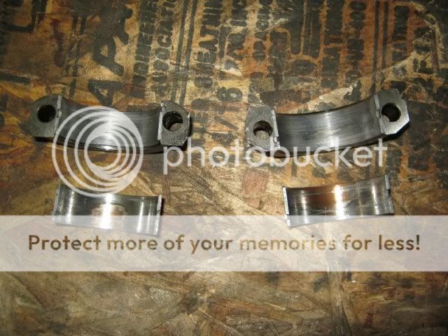

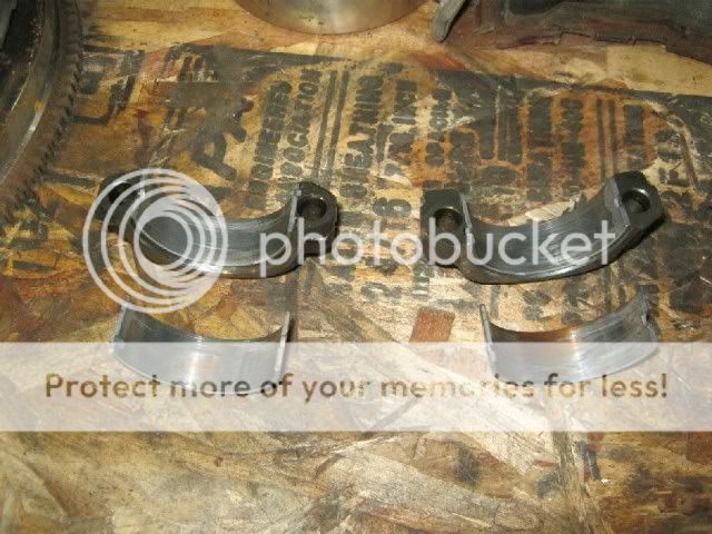

Today I pulled the pan off the 350 out of the Coupe. I was surprized to see it is a 4 bolt - but that's the good news. I pulled the Number 1 and 2 rod caps - sure enough, the bearings are shot and the crank is not good. I checked the bearings - they are 020 over sized! Not sure if the crank can go another 010 or not. PLus whoever put this motor together did a hack job. Looks like a couple different style rod caps - maybe rods. Only a couple had been numbered - the number 7 piston is in the number 1 hole and the number 3 piston is in the number 7 hole plus it looks like not all the rod caps were oreintated correctly. It will have to be torn down and done right - maybe a new crank too! It never ends.
Number 1 on the right and number 2 on the left: You can see why it had a knock. I bet these 2 are not the worst either.

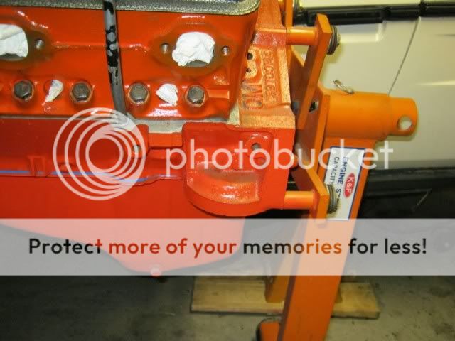

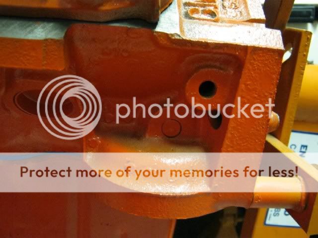

Good thing I have a fresh 350 standing by! Now I have to fidure out how to get this plug out of the block:
This is where the remote oil filter fitting is plumbed into the other motor. It looks like its a "freeze" plug kind of thing. When I get it out, I may need to thread the hole to take the fitting? I'll figure it out later.

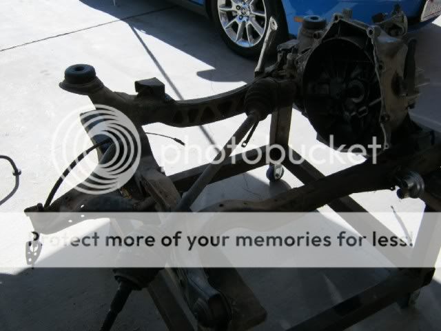

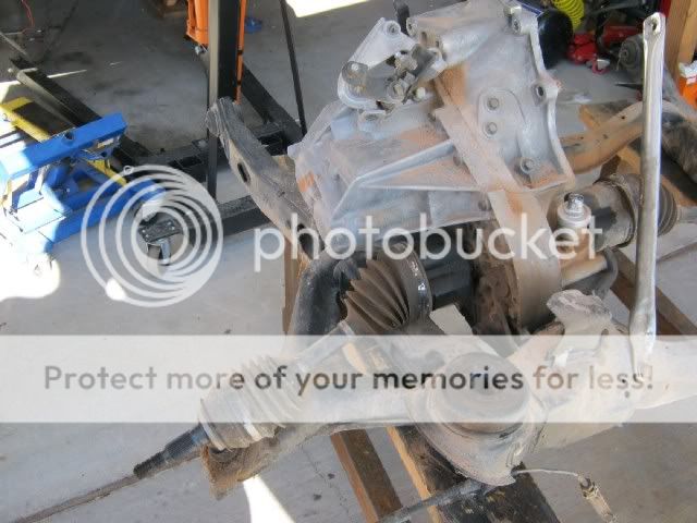

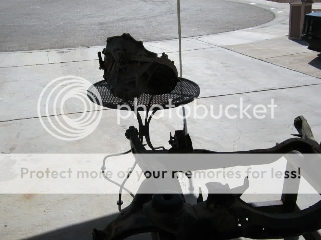

Tinkered a little on the Coupe today. Tore the cradle apart - got the trans removed and just need to take it to the steam cleaner to get the grime off of it.

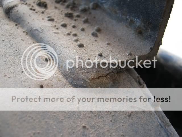

Will have to do a little welding on this one!
More later!
Pat
That plug is where I put my oil pressure switch/sensor. I used a adapter for the remote oil filter that didn't use that hole, it also had no plug in it when I got the block.

| quote | Originally posted by jmbishop:
That plug is where I put my oil pressure switch/sensor. I used a adapter for the remote oil filter that didn't use that hole, it also had no plug in it when I got the block. |
Hey Jim,
I ended up trying several "configurations" using elbows and such right off the adapter but no matter what I did, I had clearance issues with the mini starter. I ended up drilling most of the plug out - it was 1/2" long plug. I worked with a few different sized drill bits until I got to one that was just slightly smaller than the polug itself and it spun itself out. I did have to tap the hole for the fitting to attach the oil filter line too. SHould be putting it all back together this week.
