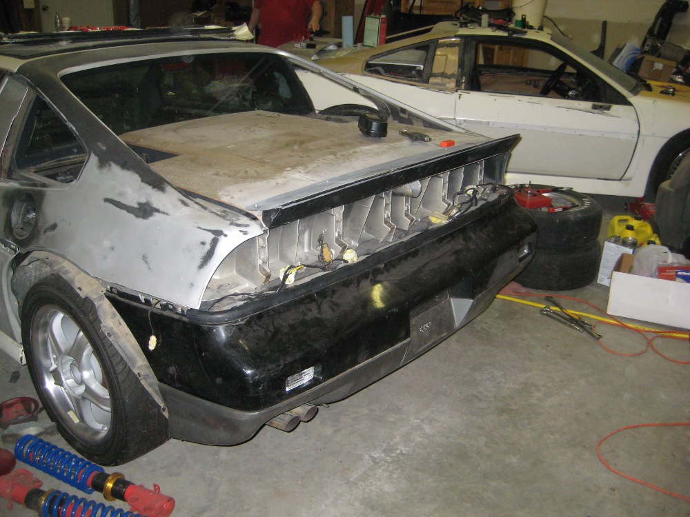

Whadeduck has a lot going on right now so I thought I would post a couple of pics. . . Pontiac filled in with panel adheasive. (This stuff is tough) .
 . . Work that has been done on the rear of the car. (new spoiler and back bumper installed. .
. . . He needs your prayers - his father is very ill.
Without Richard's (Whadeduck) help I couldn't get my car finished. I can't thank him enough.
Thanks, Paul
