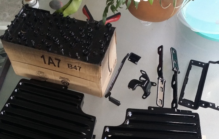

A few weeks ago I got a compressor, and posted a thread asking for help choosing a paint gun, and got a lot of great tips and recommendations.
Well, I painted my first parts yesterday, the engine vents for my Fiero. I used a black Valspar paint made for tractors, and sprayed it with this gun. I have read TONS of reviews on that paint, and all of them are good. It dries with a nice hard finish (Mix in hardener before using). Without the hardener, it will still eventually be a nice hard paint, but it can take over a month to fully cure! I used the mixture of paint, hardener and thinner that is recommended on this page.
Anyhow, I think these came out AMAZING considering I have never used a paint gun before. I did a lot of spraying with colored water over the past week testing and becoming familiar with all of the settings on the gun, fan pattern, pressure and paint to air mixture.

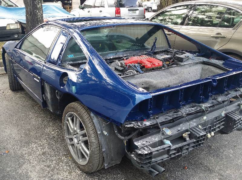

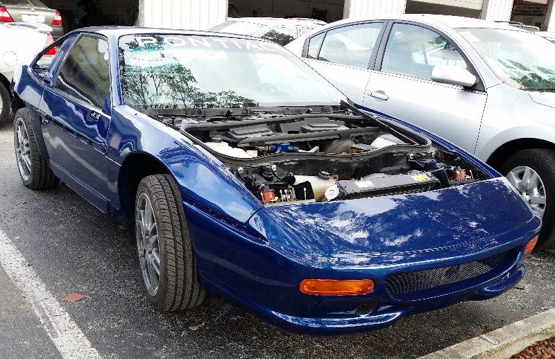

On another note, I stopped in at Maaco today, and they have the main car painted. They also had the undersides of the decklid and trunk painted, and are going to do the other side along with other parts for the car in the next day or so. They say they want to keep the car another week after it is painted, as they want it to cure so they can color sand and buff it out. I am glad they are doing this, as there was quite a bit of orange peel in the paint when I looked at it today. They said they put 3 thick/wet coats of clear on, to give plenty room to cut-n-buff, and still leave a couple coats of clear for depth.
Here are a couple pictures from today's visit: (Note: It was a drizzly gray day here today, and the paint does not look so good in this light, as it reflects the gray color of the sky. It REALLY shines in the sun, and looks a deep midnight blue metallic at night.)

While waiting to get the car back, I have been practicing with the new compressor and paint gun. I have been painting a lot of small parts to put the car back together with. The rear deck lid hinges and cross springs, hood hinges, nut, bolts, interior pieces ect. They are coming out really good so far. I am using Valspar's Enamel Tractor Paint. It has very high ratings for finish and endurance. None of the parts in the photo have been clear coated, that is just the black paint alone.

Ok, I got the car back from Maaco today! WooHoo! Now I can start the tedious process of yet again reassembling it.... side scoops, rockers, sun roof tracks, moldings, markers, lights, hood and trunk hinges, hood and trunk, the cross springs for the decklid (Boy is THAT going to be fun!), gaskets, seals bumpers..... fun fun fun!
Anyhow, some of the main body has been color sanded already. They asked me to put the car back together, and bring it back, so they can then do the bumpers and other parts on the car. The rear bumper is very flexible, and almost impossible to lock down well to color sand and buff it out off of the car. The spoiler has been color sanded and buffed, and it looks like glass!
They burnt through an edge on the fastback clip while color sanding, and completely sanded the entire clip back down, and repainted and cleared just yesterday. So that also has not been color sanded, as it needs to cure for a good weeks first.
