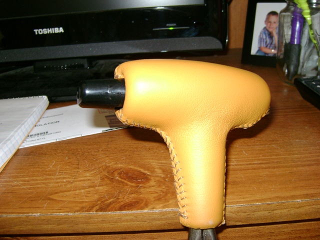

I got this leather shift knob in the mail today. mmeyer86gt/gtp here on PFF makes these, and does a great job on them.

Nice shifter knob - the stitching looks great. Thanks for the WCF shift bracket info - I was feeling a little defeated and I di not like the way I had to "rig" mine to work. I feel a change in the works.

The knob is fine, its just to light in color to use in my Coupe. I put it in the car, and it sticks out like sore thumb. mmeyer86gt/gtp here on PFF makes these. He did a great job.
I need to add that the color wasn't his fault, he made what I requested,

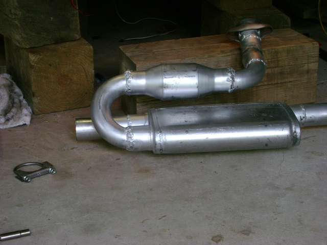

I removed the exhaust and removed about 3" of the 2.5 straight from each end. I am gonna put it back on one more time so I can mark the 90* turns to head out the rear of the car for welding. I am gonna go to Autozone tomorrow to look for a pair of 2 1/2" chrome tips to weld on the elbows before I drop it one last time for welding.

I finished the transmission cooling lines, added the positive battery cable to the car and finished the exhaust this morning before it got hot in the shop. Axles and parking brake cables tomorrow. I have the new adjustable bolts to put in the lower strut holes. Might take the front wheels off of the 10" blocks. The fronts have been up there since late July or early August last year.

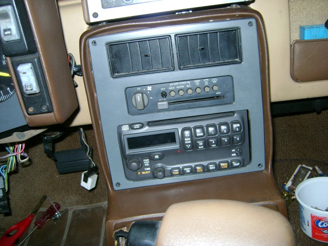

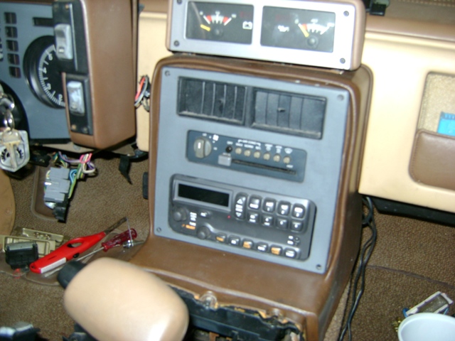

Did this this morning. I still need to cut out the top of the radio opening so the CD's will come in and out:
Went back outside and trimmed out the top of the radio opening for the CD slot and eject button. Looks pretty good. There is a part of the cabin wiring harness behind this radio about 1" around. I am gonna unwrap it so it will flatten out a bit. The wiring connector for the radio hits this part of the wiring and keeps the radio from going in the last 3'16 inch . There is just not any more room behind the radio. I have a good 1/4 " between the HVAC panel and the faceplate. This does sound real good though.
