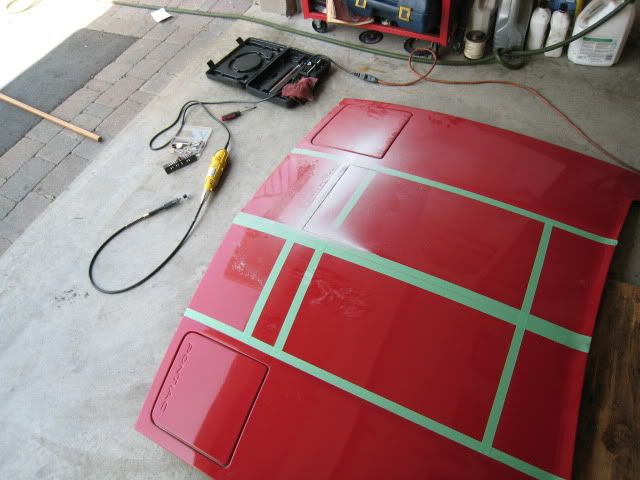

Started marking off the openings and bought some dremel cutting disks for the job.. hopefully they work well!

I'm going to need to cut up the bottom structure to fit vents this long and wide in the hood.
