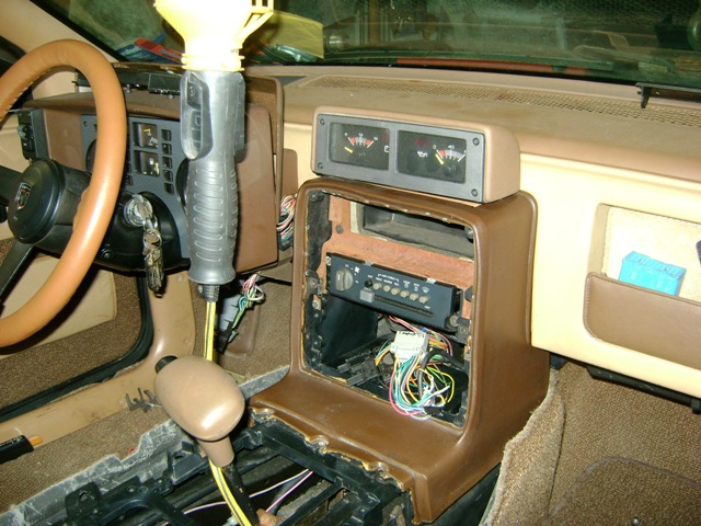

After some supper I went back out to try to get some more of the center dash and console back together. My front pad surround was for a car without the auxiliary gauges. I mounted the gauges and measured how wide I needed to cut and how deep I needed to be. I came up with 3 1/2" deep and 8 1/8" wide. I used a metal hack saw to make the cuts after a wood saw really mangled the padded part. The metal cutting blade worked perfect. I did all of this by hand as the plastic underneath the padding is real brittle. I cut off the padding part with a sharp razor blade. I had to remove another 1/8" on the width for the 8 1/8"measurement.
Here ya go:
and
Looks like it came this way now!!
The wiring connectors are for the radio, AC controls and the fan switch. As these are difficult to remove at times, I am gonna save them for last in case I have to take this all out again. That slider cable fastener is a ***** to get back on the controller and get the screw started.
I want to make sure the gauges work out ok before I screw down the padded surround. bulbs burn out on occasion. I will need the battery gauges idiot light to work to start the alternator to working.

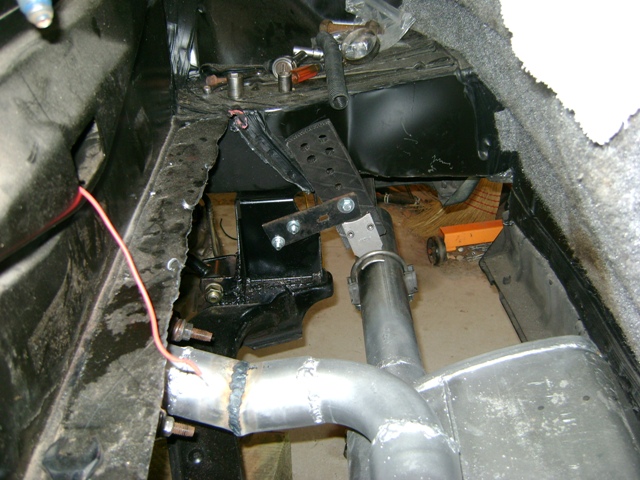

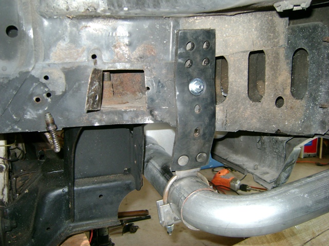

Bunches of little things done today. I made and mounted exhaust hangers, finished adding the fasteners to the console, soldered a new cigarette lighter connector on its wire.

Drivers side:
Passenger side:
I am thinking about changing the passenger side hanger to the same method that I used on the driver's side. I just didn't want to remove the wheel tub on the passenger side. Lazy I guess.

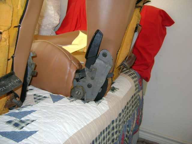

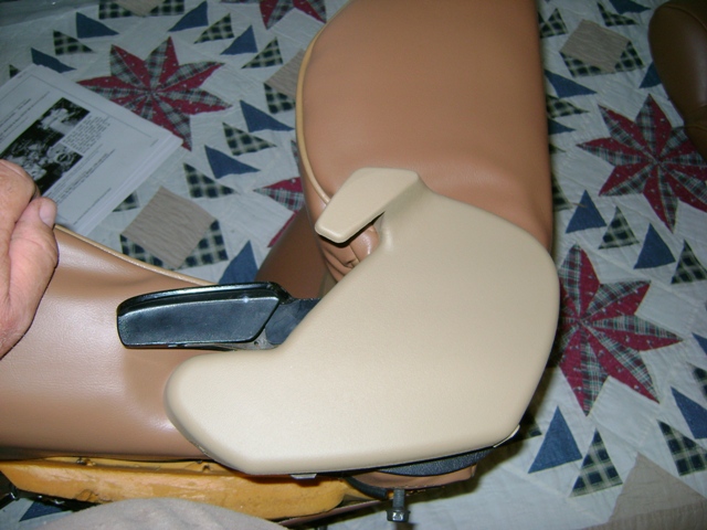

I went out and prepped two seat hing covers that I had purchased from the Fiero Store. They were for sale at a big discount, and unfinished. I drilled the holes and removed the 'burrs' from the castings. Once smooth I flipped them both upside down and put the tan semi gloss on them. I'll spray the top sides with the vinyl spray this this evening.
They cover this:
And installed:
Turned out real well I think. Tomorrow sometime I am gonna clean the seat rails and put some semi gloss black on them.

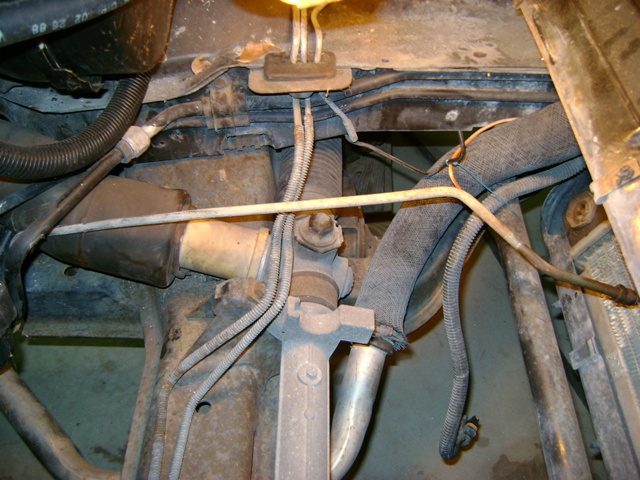

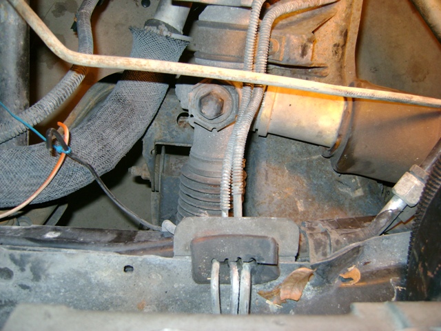

I went tout to the garage to start on putting in the cooler lines. It was a be itch as I thought it would be. I removed the spare tire tub for room and to be able to see what was happening as I threaded them in. At first I had the line on the wrong side of the steering shaft rubber cover thingy:
and close but no cookie:
As the lower pic shows the line is inboard of the steering shaft. I had to take it out and thread it between the frame rail and the steering shaft. Everything lined up pretty good then. Both lines threaded into the radiator the first time real easy. I love it when this happens
