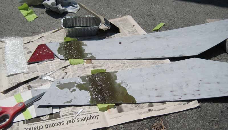

What weight of Fiberglass are you using ? 1.5 oz or .75 oz. ?

Mr. 85LAMB, sounds like you have much more info than me, as weight of fiberglass I just say one yard of that one and one yard of the other ( next time I'll get that info on weight of fiberglass ) I'll still try to do step by step build and showing tools.

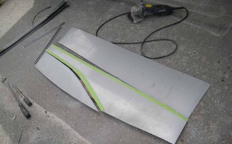

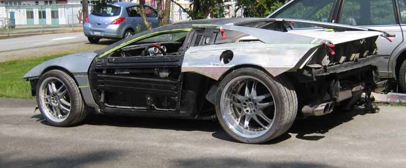

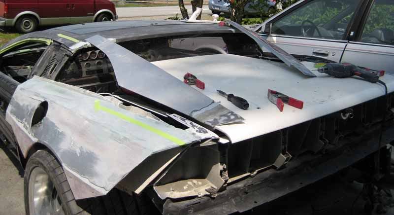

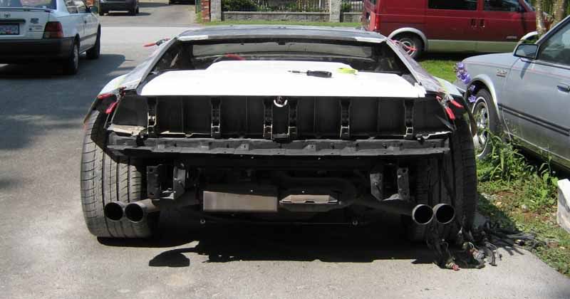

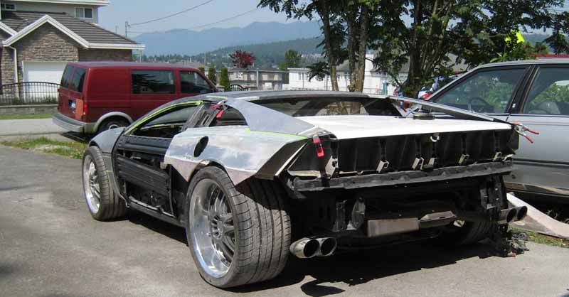

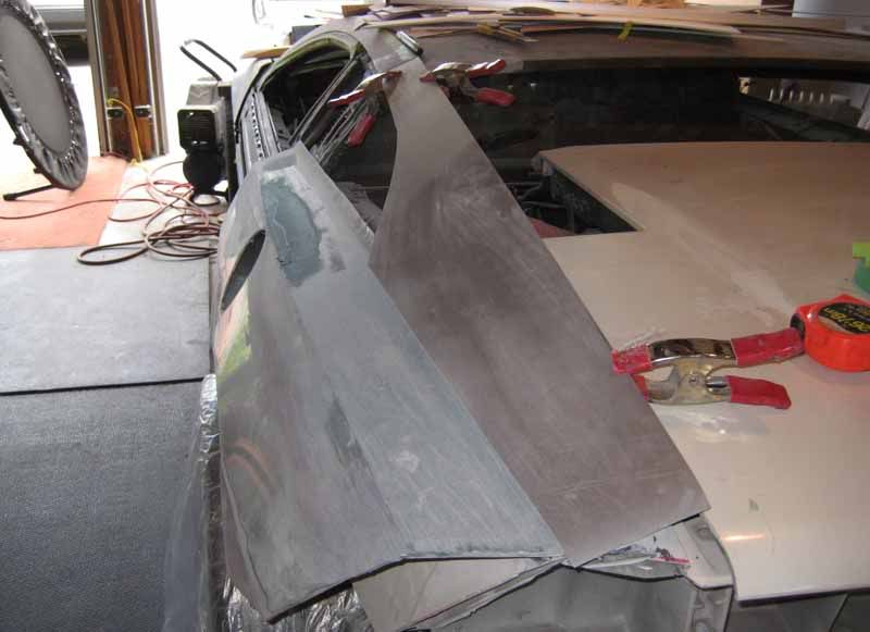

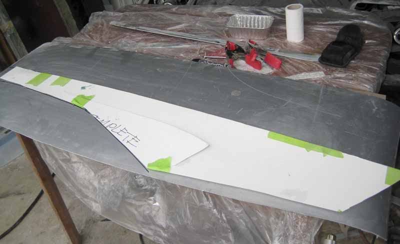

Back today's fun... Started to work on rear pillars, I'm using Fiero roof panel, template on roof panel and ready for cutting
Cut off with grinder cutting wheel
Pillar shown on chopper
Trimmed more off at bottom
That's as far I got today, had a little ouch I shreded tip of finger with grinder, my niece drove me to emergency (now I can't play guitar )
Tomorrow I'll finish pillars if nothing else happens  [This message has been edited by Car-Lo (edited 07-04-2012).]

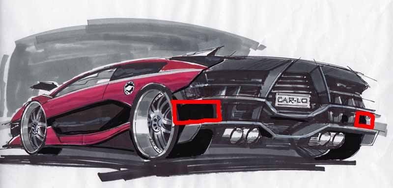

The only thing I have a question about is that space between the rear "bumpers" showing the tire tread. Aren't there mudflap laws in Canada? It seems to me the Police could really give you a hard time about that. Don't get me wrong, it looks awesome. What about a matte black inner wheelwell that goes around the circumference of the tire and also gives an anchor point for all those points on the valance, bumper parts and side skirts for extra strength?

Thanks for asking... Clynt said not to worry, I will be putting back liners just stopping at open area shown on red mark, if there's a problem I'll slide in a panel covering cutout area . The rocker panels and defuser wing will have custom hidden frame holding everything.

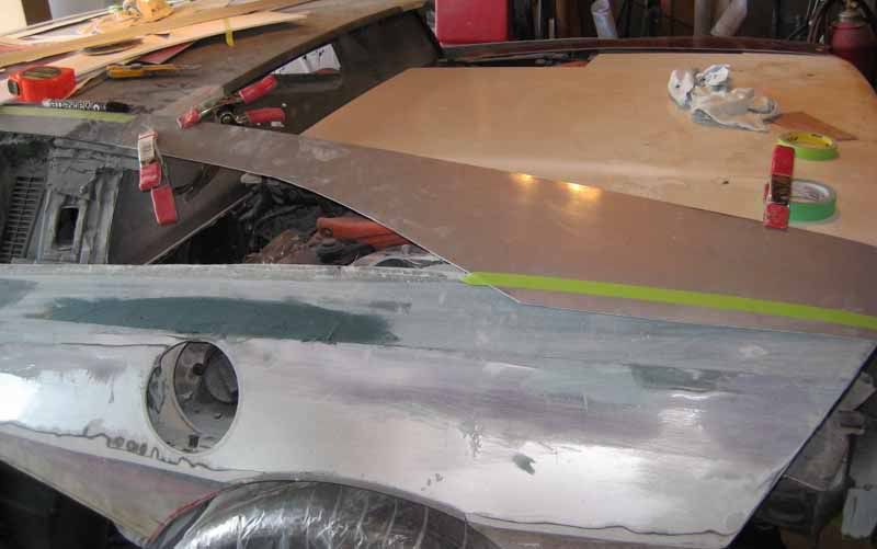

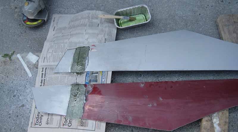

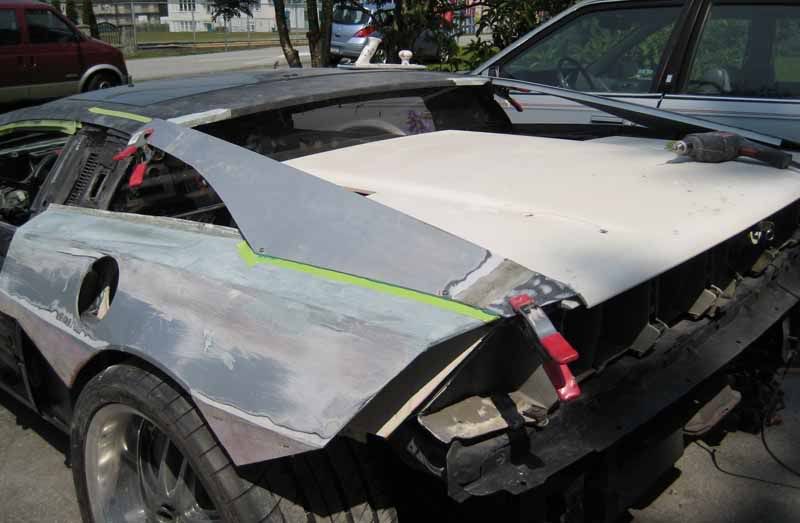

Today's play... Fastback pillars are from body parts (Fiero roof), not enough lengh, so I had to add pieces and fiberglass together.
Fiberglassing back (to much hot sun)
Front (that's better)

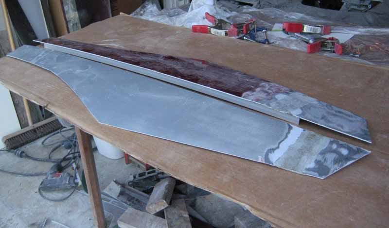

Using aluminum angles bent to shape flowing pillars
Pro-Form to bond aluminum angles to pillars
finished

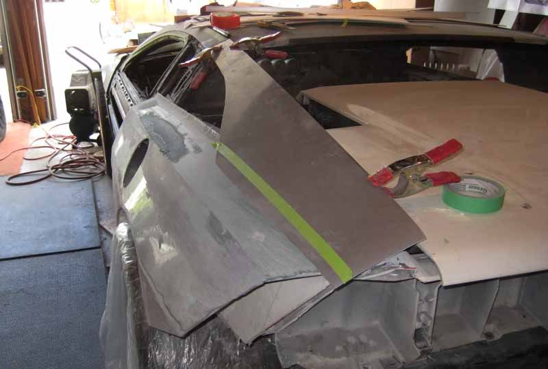

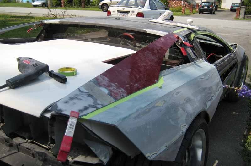

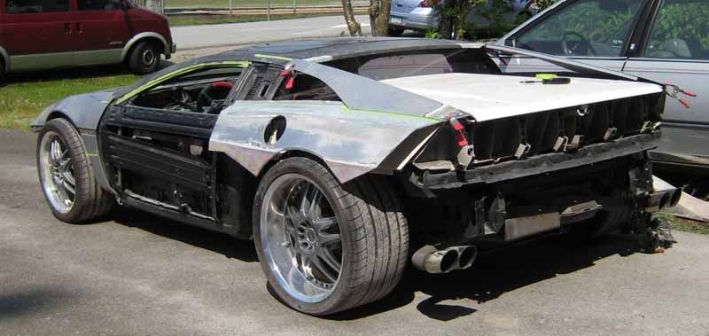

Back to RBS-2 Today my nephew and I installed fastback pillars
Using Pro-Form, had to screw down at bottom, no room for clamps (screws will be removed)
Other side
