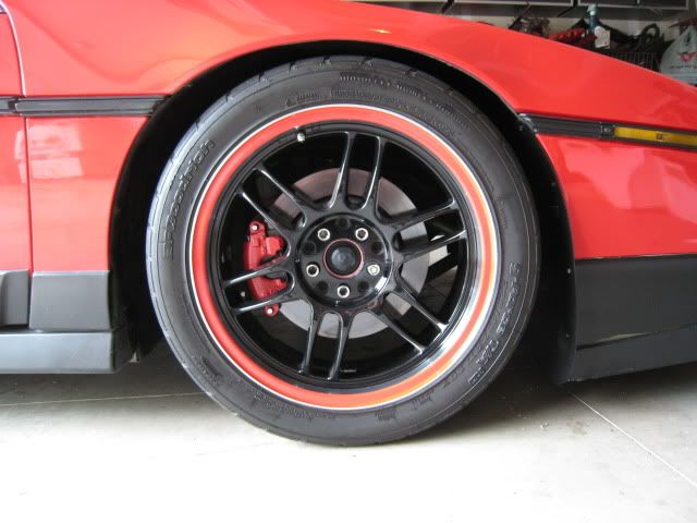

I started to repaint the calipers today, and the wheel wells. Also drew up a design for a little addition to the calipers.
doublec4
JUL 22, 03:31 PM
Finished off the calipers today, removed the stickers from them too. Cleaned off the inside of the rims.
I also painted all of the inner fender liners, looks pretty new again.

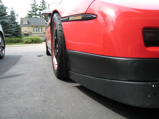

Removed the front "winglets" from the front bumper. They were okay for a while, but I don't like them anymore. Instead, I bought some splash guards and actually placed them in front of the the front wheels. I'm running 225 series tires up front with a 38mm offset rim so they stick out a bit. I've seen these "reverse mudflaps" on some other sports cars. I figured I'd give it a shot, they look pretty good and shield the edge of the tire from air that would create drag on them. Basically they just look cool.
doublec4
JUL 23, 01:50 AM
Took the car out tonight for some fun... I don't know if I'm imagining things, but after installing those "reverse mudflaps" I've noticed a significant decrease in front end vibration at speeds above 100km/h. Maybe they're actually helping a bit?

| quote | Originally posted by doublec4:
Took the car out tonight for some fun... I don't know if I'm imagining things, but after installing those "reverse mudflaps" I've noticed a significant decrease in front end vibration at speeds above 100km/h. Maybe they're actually helping a bit? |
Your reverse mudflaps being in front of the front tires? If so, what you've done is not too far removed from a very old NASCAR trick called a "Gurney lip", and it was done to increase front downforce. I suggest you research this, then mold the flaps if necessary, try to actually end up with real Gurney lips, not just vaguely similar results.[This message has been edited by Isolde (edited 07-29-2010).]
doublec4
JUL 30, 10:21 AM
| quote | Originally posted by Isolde:
Come to think of it, I have heard of gurney lips before. I know I've seen and looked into gurney flaps (at the back edge of a spoiler).
I would like to have something shaped for the front bumper, but I would first need to learn some fiberglass skills. I've never 'glassed before. I might try something similar for the rear wheels as well. Thanks Isolde
