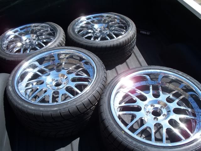

whodeanie MAR 20, 11:44 AM
Look what I just went and picked up from the tire shop!
I can't wait to get home tonight. I will post mounted pic's monday.
Carnut call me when you want to come get your wheels and thanks for the loaners!

carnut122 MAR 20, 08:00 PM
Tires and wheels look great! Since you're a friend, I'll trade you even up for mine!

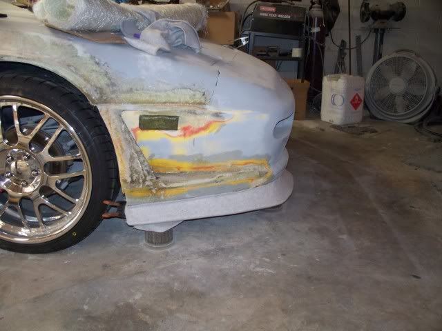

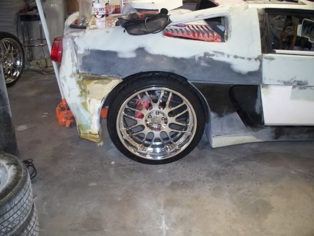

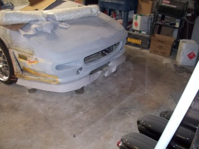

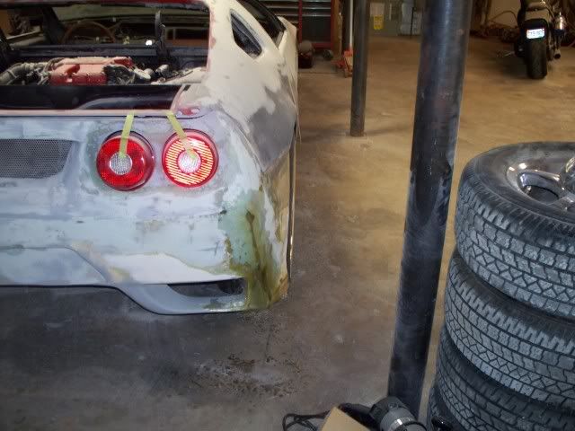

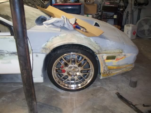

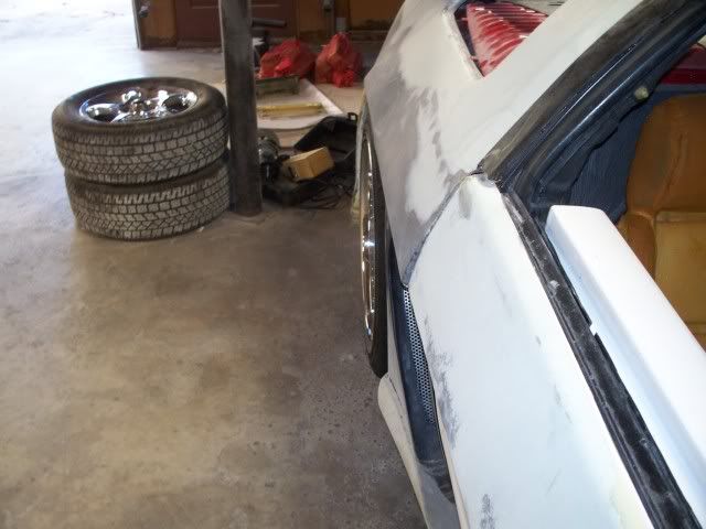

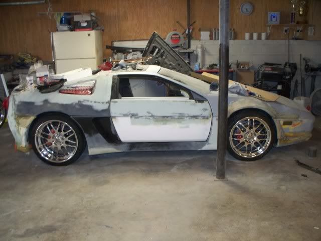

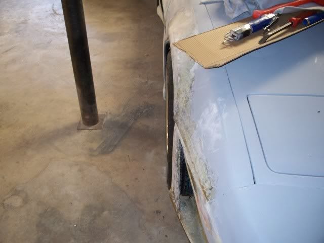

whodeanie MAR 23, 07:57 AM
Ok it's Monday! I know no one likes mondays but here is somthing to brighten up the day.
this last weekend I worked on the car both days and did alot but most of it was stuff that was rather boring to take pics of
I worked on the front lower pannel that took a good part of the weekend and it still is not done but it is close.
while I waited for that to dry I worked on many other things like fitting the rockers to the door jambs better, I made a pattern for my back glass to take it to my shop
and cut it this week so I could send it out for tempering, as well as many other little things that needed done like the glove box in the dash.
once I got my wheels installed I looked over all the body lines around the tires and I had to do a few tweaks the bigest one was the rear bumper
when I built it I made the bottom too wide so I cut the bottom part and re fitted it to the wheel and it looks way better.
I think I have a love hate thing with fiberglass it is easy to make changes on parts but it takes a lot of time waiting for it to setup.
that is why you have to work on so many parts of the car at once.
anyway here are the pic's that all of you wanted to see! the wheels mounted.
Enjoy,
is it just me or does the car look more agressive with the front lower on the 355 nose and the big wheels?
I will lower the car about 1" later to fit the wheel wells beter.
the wheels fit exactly the way I wanted them to they come out just inside of even with the body.
[This message has been edited by whodeanie (edited 03-23-2009).]
Tusch MAR 23, 09:36 AM
Wheels looks great man, can't wait to see this thing complete. Looks like you nailed the wheel measurements.
