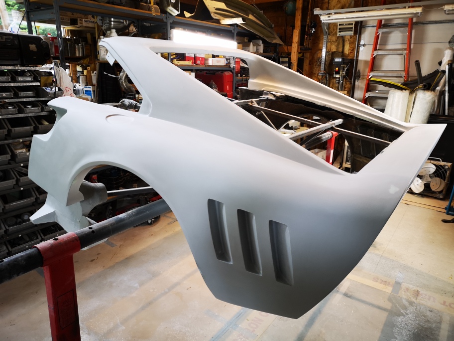

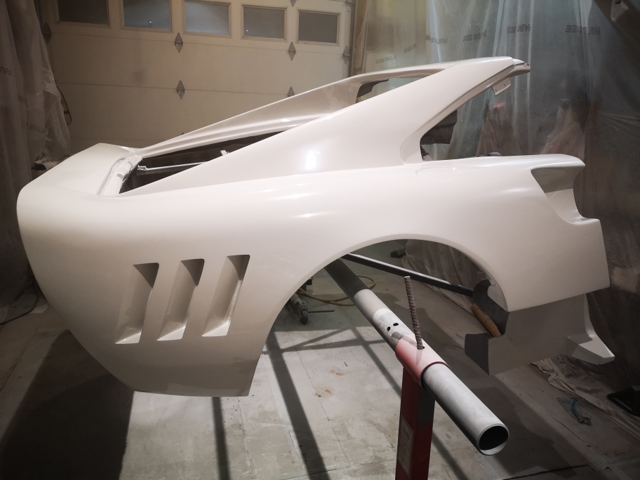

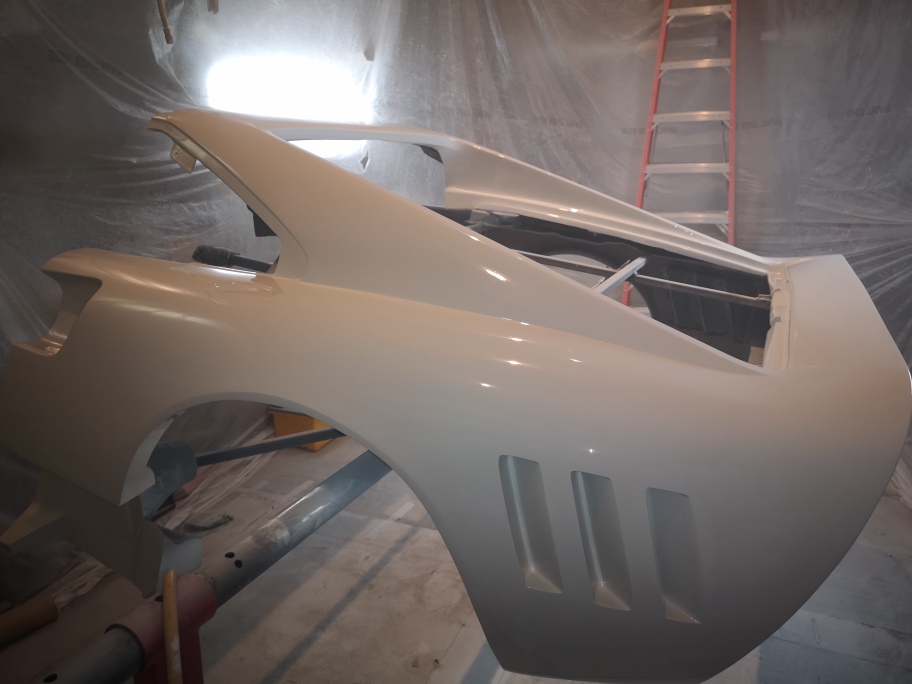

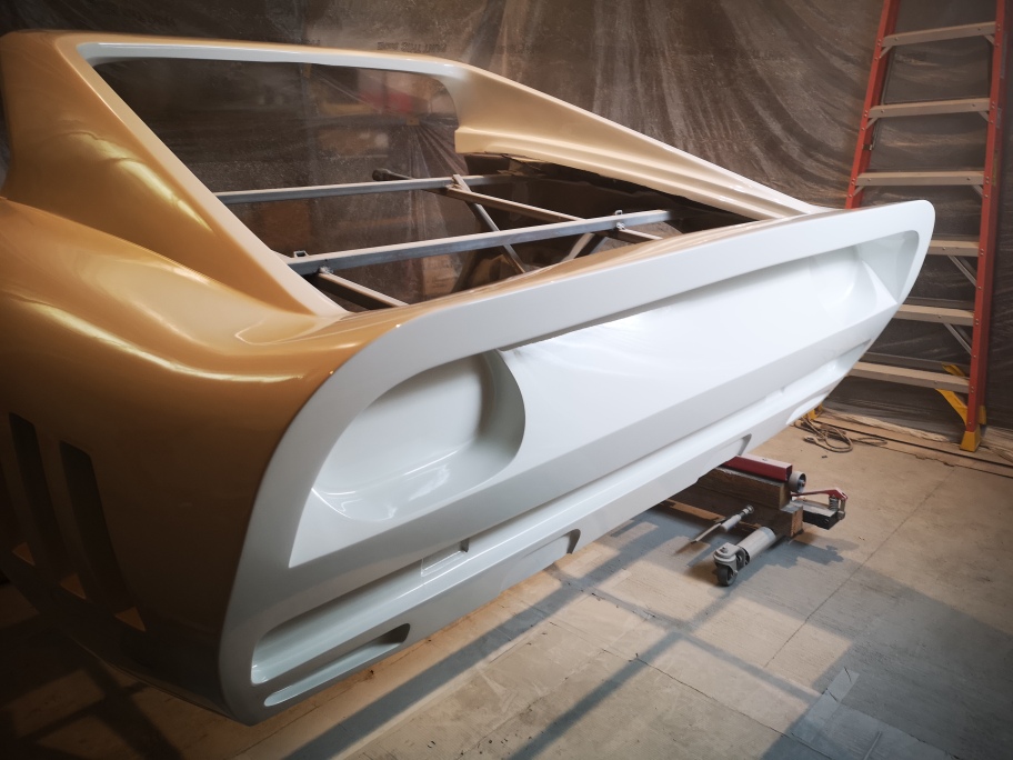

dobie1 SEP 28, 08:37 PM
Thanks Shem, its coming together!!!
I've been busy finishing the back half of the car to get it into paint !!
unfortunately it's the wrong color for now, but It is for the first time one color other than primer gray.
I have to say taking the extra time to get the body perfect payed off , the paint laid down to give me a perfect surface to mold.
I'm hoping to start molding in a few days as I want to give the paint a few days to fully cure.
the first pics are in Primer ready to paint.
and now for the painted version. pics were taken at night so not as good as some Ive posted
Stay safe everyone and thanks for stopping by
Wayne

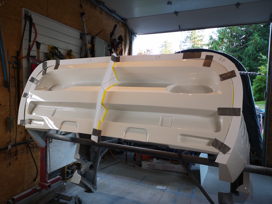

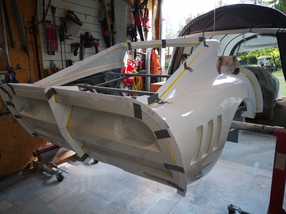

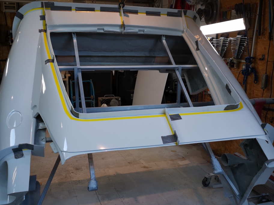

dobie1 OCT 04, 12:05 AM
Thanks Bob, Ted and Andrew for stopping by and the comments.
So I started molding the rear of the car today ,my first step to expedite the process was to make the up the flanges .I attached them to the body to get a visual of what each piece will look like and to ensure they can be removed from the part once it is laid up.
I'll start the layup tomorrow ,I hope to have the mold totally finished in 2-3weeks.
stay safe
Wayne
