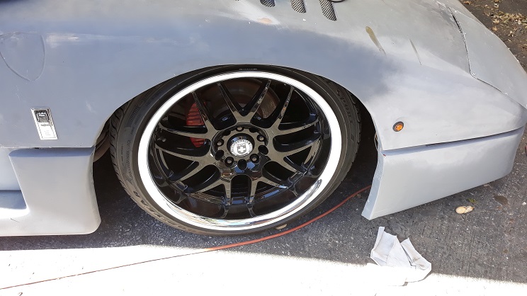

Heres a shot of the hre center caps I got, I like the shield logo
 The silver caps they came with didnt fit the wheels of course so I peeled the emblem off n put em on the caps that came w the wheels.

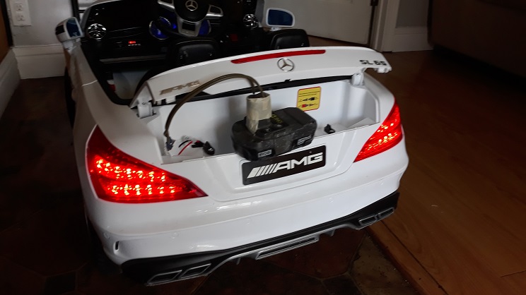

Goofing off quite a bit w the new drones. Got the kid a 12v power wheel w remote from ebay. Installed one o my 18v cordless tool batteries w a simple cable
 Holy cannoli the speed doubled easy! The steerings crazy at 18v tho kid loves it. He cant drive it yet, but I let the neighbors kids use it. Got youngsters on both sides so lotsa toys to be shared. Got em all some cheapo mini drones too lol.

Kicked some arse ta-day! Changed the sender for the temp gauge- working! Got a new alternator installed- charging! Tried my new 2" spacers- phuc! Center bores too small to fit around the rotors flange. Swapped the old wheels back. Played w the oil pressure gauge. Tried to install the new sender, too small. Checked ohmage at the sender and at wires- nada. Figured out my new meter doesnt read ohms very well. Ran a test wire from the sender to the gauge for shits n giggles- I got a working gauge. Its a 3-160 ohm gauge and shows 100psi while the cars running lol. Good enuf. Still need to wire the speedo and get the indicators working. Drove it back and forth in the driveway, rinsed it down

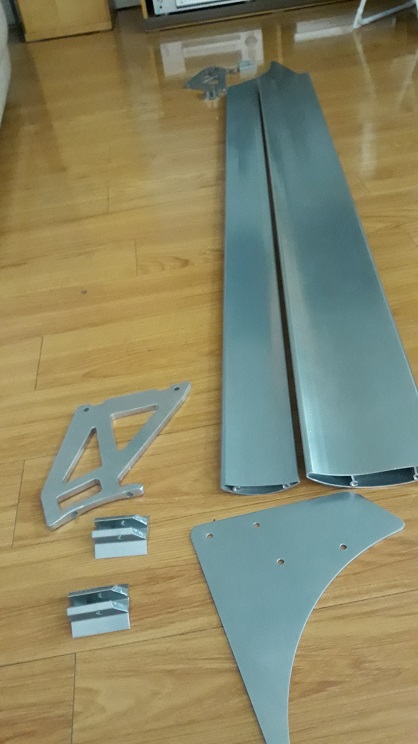

Didnt plan ahead to get the car outta the driveway, too many cars to move and no porking on the street. Told the guy ill bring it this sunday. Ebay parts finally showed, lettering yesterday, wing today. Ordered the lettering a month ago, never heard back from the seller. Retard fedex guy came to my house w the wing, friday, saturday, and yesterday and didnt leave it. Wrote "no access" , then "incorrect address" on the tracking page. I wrote them an email telling them both my house and I were actually there all day, so was my mailbox, and my neighbors. Hate dealing w tards, they abound here bigtime.
Anywho Heres the wing kit, its a bit smaller than I expected (heard that before lol), but Ill make it work. Came w some uber cheesy side fins and wonky looking supports. Pure rice baby

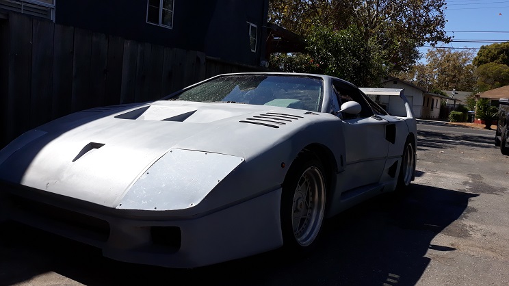

Went to move the cars around this morning(musical cars) before work, and the f%$#ing drivers doors stuck again. Wont open from either end lol. Always when im in a rush. RR bag wont lift but holds pressure. Shoehorned myself in from the drivers side and moved everything around. Played w it a bit tonight, cleaned up a few things and loaded it up w the prep materials I have. Gassed it up. Found a wee airleak at one of the gauge lines at the mani, Rr bag was too smashed to let air in, raised the other side and front and it took air. Got the drivers door opened pretty quick(not my first rodeo), and made a metal brace to hold the handle in better. It was kinda ripping out in the front from the pressure of opening the door. Probably take it around the block tomorrow for a shakedown cruise, make sure its gonna make it to the shop.
shem
engine man
SEP 20, 10:47 PM
that is one thing about a custom car is you need to work all the kinks out and that take time and patients
shemdogg
SEP 21, 04:00 PM
I have neither lol. Fired it up and ran it around town for 10 mins, sounds like a volkswagen bigtime. Ran great, airbags are nice, rears a bit stiff. Remembered to pause pulling into the driveway and hit the up switch before I pulled in. Turned hella heads and broke a few necks. Hooked up the speedo to the low speed wire but it didnt register. Ran a new wire from the ops to the gauge, works. I have 25lbs pressure w koef and 65lbs when the motors running. Engine fan came on at 190 on the gauge, I have one of rodneys custom switches. Got all the turn signals and brake lights working. Washed off the motor and trunk area, off to the shop tomorrow morning.
