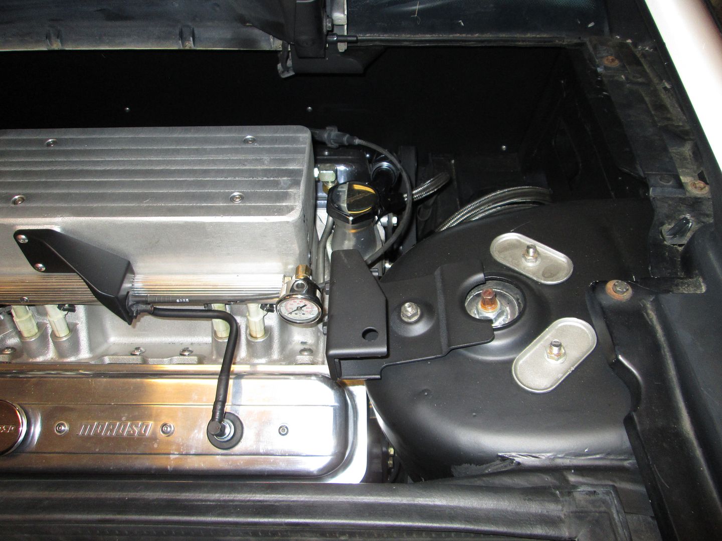

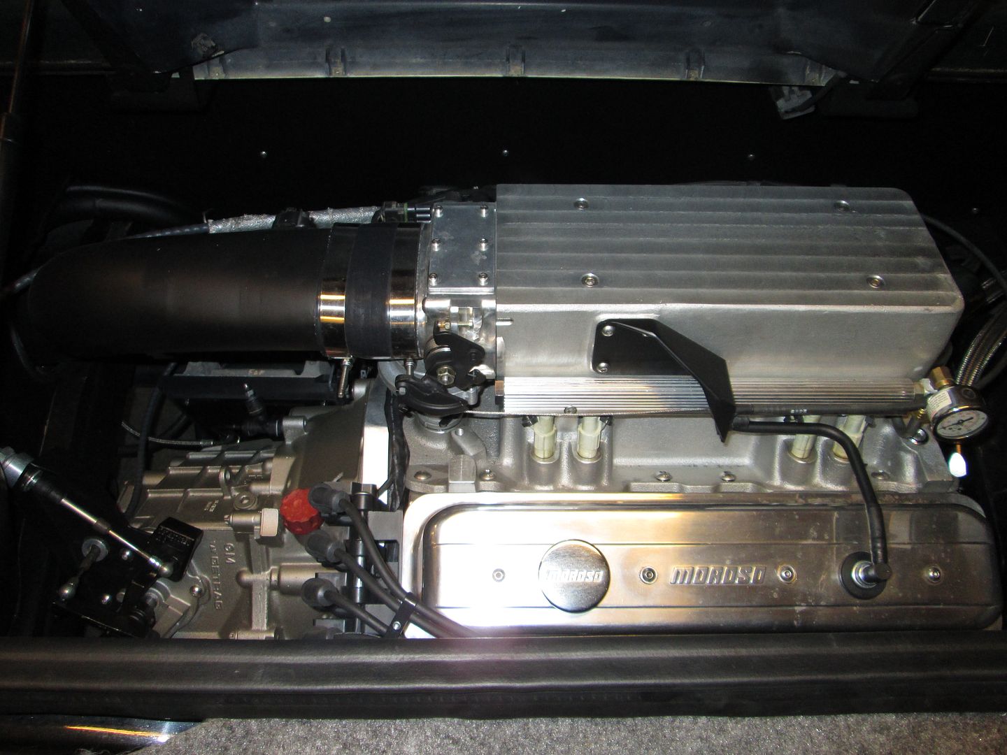

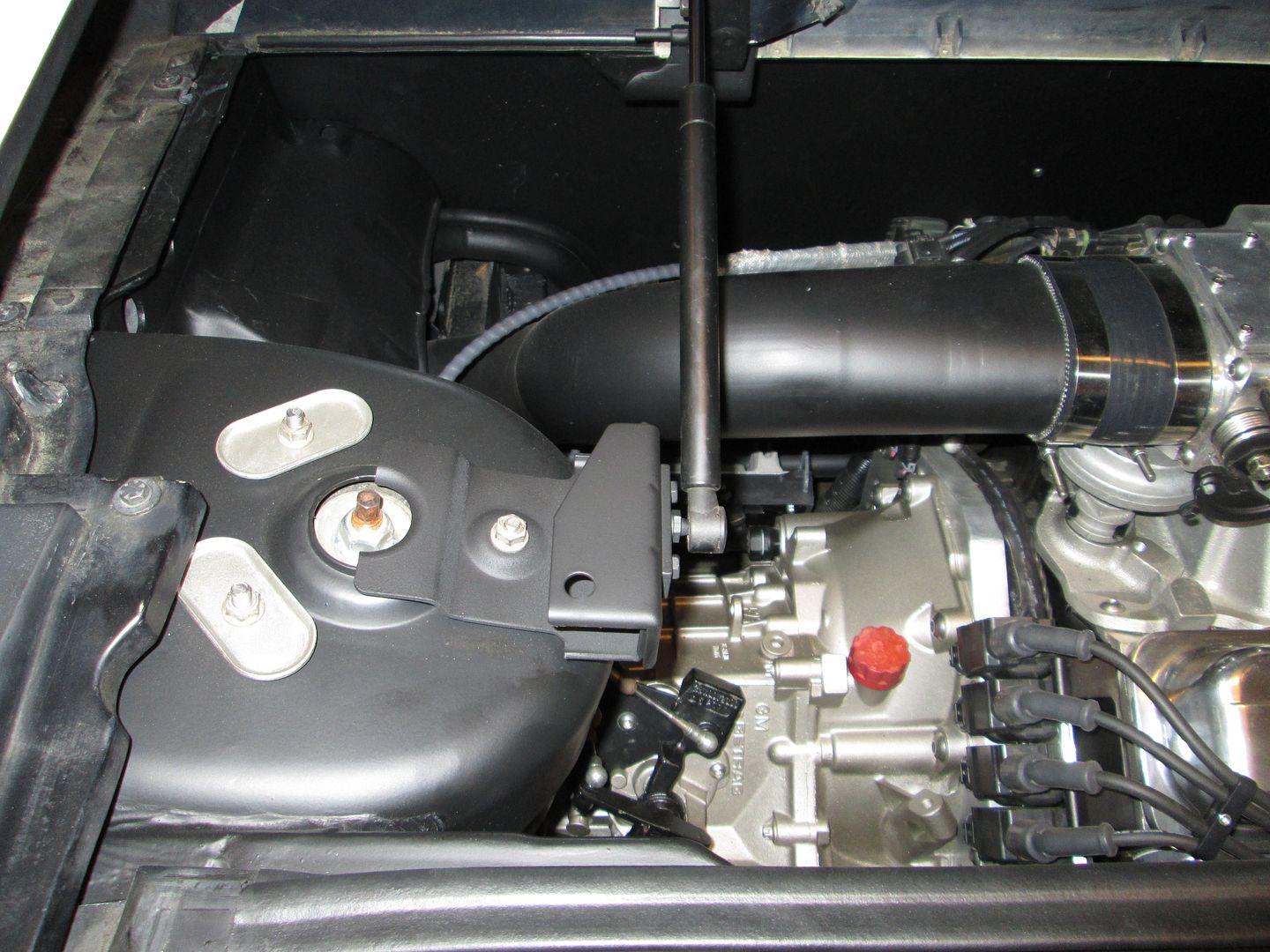

Here are a few more pics I took the other day once I installed the vent brackets and decklid support:
[This message has been edited by fieroguru (edited 06-15-2014).]
Trinten JUN 15, 10:06 PM
It's beautiful!!
And I definitely won't complain about 21 MPG, either!
I might have to buy that nice car cover sooner than later, try to help keep stuff from calling through the vents and making the engine bay look all gross.
