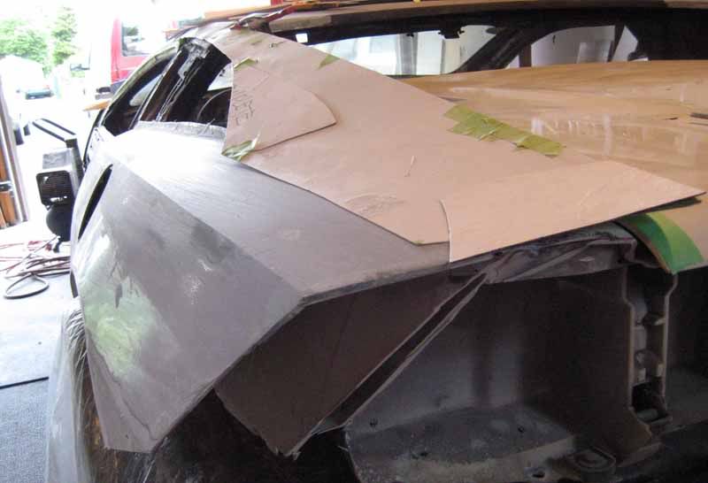

I'm always asked what materials I use...

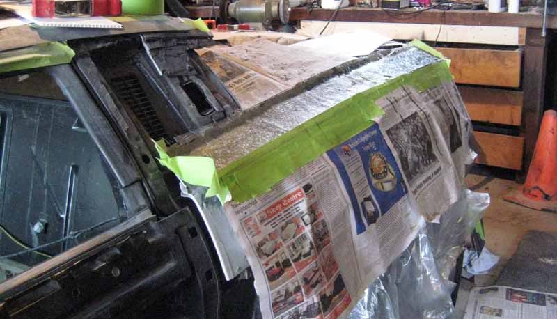

Started to box in top rear panel, using one layer Evercoat SMC fiberglass, then one layer of Evercoat SMC fiber teck
and finished with thin layer of Everglass. Both fillers have reinforced fibers, short stands even kevlar, makes a strong boxed in panel.

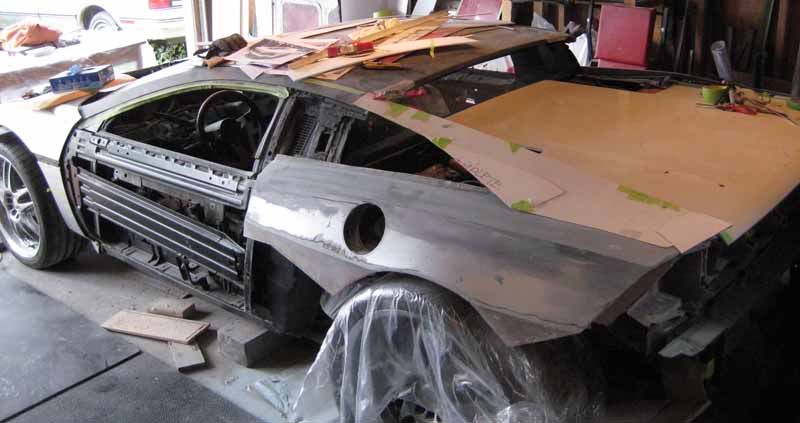

A little tweaking to rear pillars, change design to match front, now it flows better
355FIERO will be happy RBS-2 is on a diet, nice and thin (well, a lot thinner than old RBS)
[This message has been edited by Car-Lo (edited 06-30-2012).]

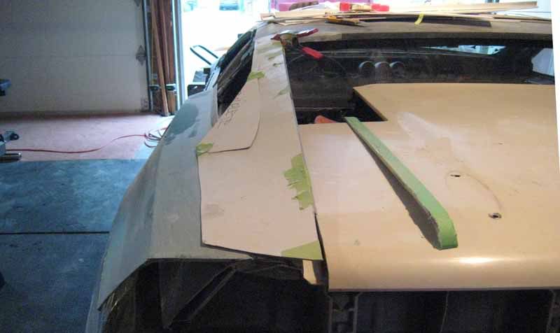

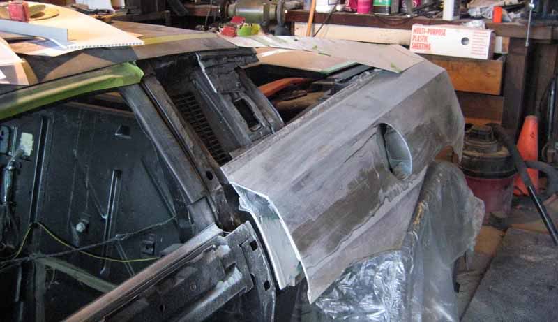

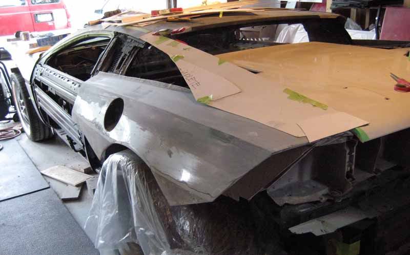

Car-Lo JUN 30, 09:35 PM
After dinner tweaking...

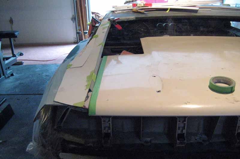

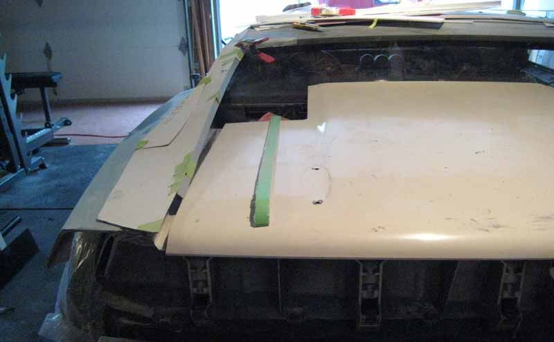

Trick tweak I did with old RBS, cut 1"off rear deck lid at each end and moving pillars inward 1", gives wider fender hip to place your coffee cup
Shown 1" tape mark to be cut off...
Shown cut off end piece and a few views...

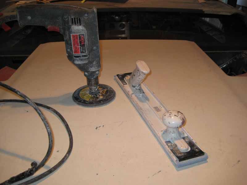

You make it "look" easy
Could you please explain in detail how you go about,
Sanding or "finishing" the panel ?
ex: block w/ 36 , then block w/ 80 grit, then block w/ 180 etc.
and also please tell us what tools you are using
if you don't ming me asking,

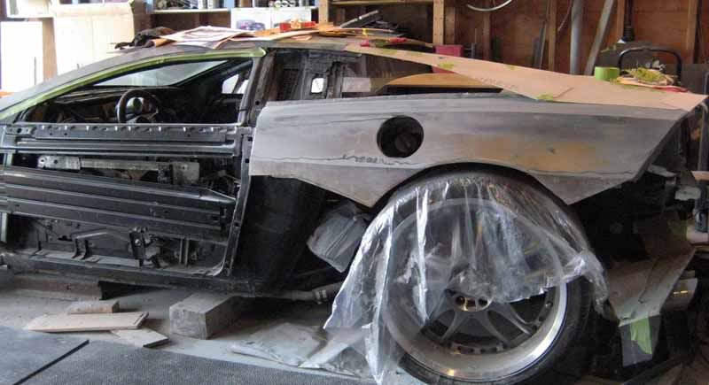

There it is, okay guys don't laugh to hard, just ask the Capt. we don't have much of auto body tools
Long board is most I use, keeps upper body fit. What you see is just 40 grid so far.
Clynt works so fast that I have to say wait I'll get my camera, next time we'll try to post more info as we go along.
