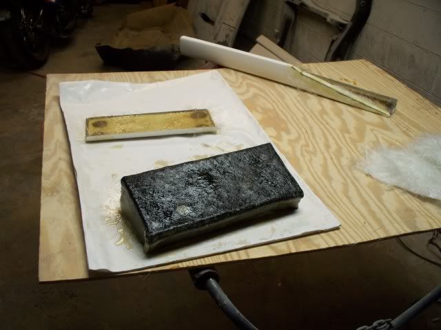

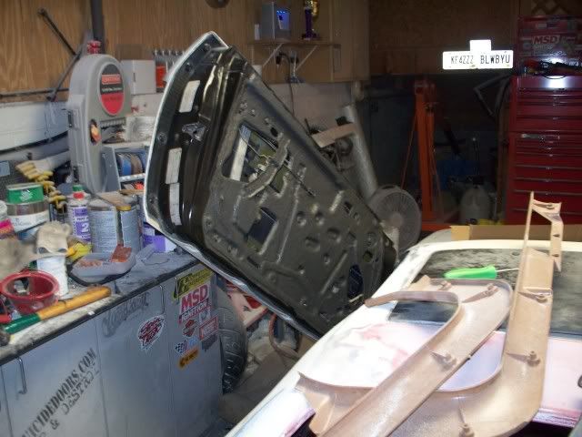

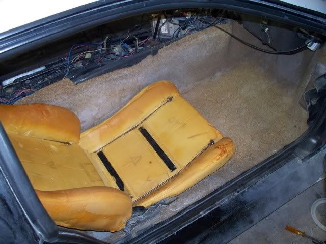

last night I worked on the car for a few hrs. first I worked on the carpet I was able to remove the padding from the carpet without damage so I could re use it with new carpet.
next I made a glove box and did a few other tweaks on the doors that I will get more into later.

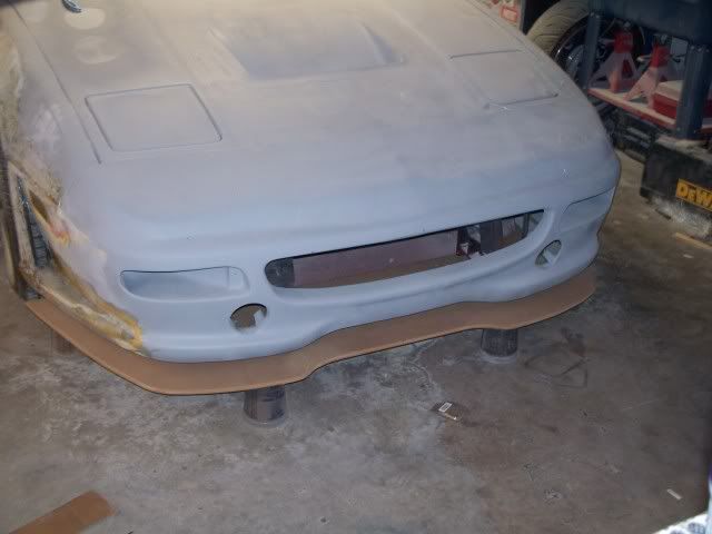

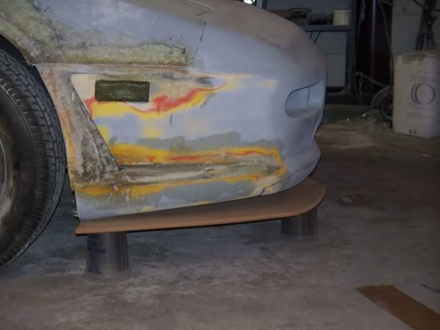

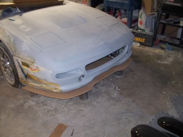

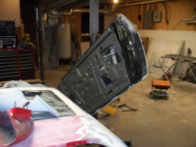

while I was waiting for the fiberglass to dry I worked on the frontend, I know you will all like this one when I get it done but here are some pics from the start of it.
I cut out the MDF to the size and shape that I wanted then I fitted it to the car I don't want to go any farther out or lower with it because I would like it to stay on the car.
a fiero with a real glove box! not that big but better than nothing!
the padding from the old carpet, I will get to that later.
Tusch MAR 13, 08:34 AM
That is going to be hot, can't wait to see where this baby ends up.
exoticse MAR 13, 10:56 AM
Dean,
I really love where you are going with this front end,...the tweeks make all the difference in the world !

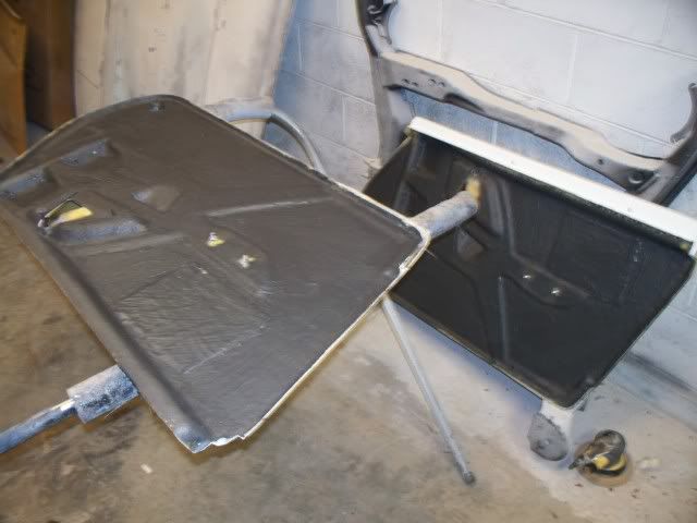

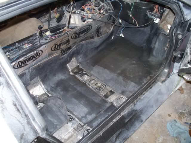

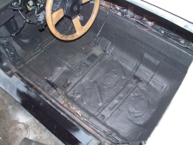

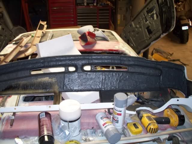

I worked on the car this weekend but I did not get any pic's yet. this weekend I worked on the inside of the car I finished all the Dynamat and on top of that I used a liquid sound dead on top of everything else, I did the underside of the dash and the doors. when I remove the body I will do the top of the cab and the wheel wells as well. I want this car to be as quiet as I can get it. I did not work on the body yet, I am still deciding what I want to do with the lower on the front. I think I will have a little time to work on the body this next week but I will keep you posted.

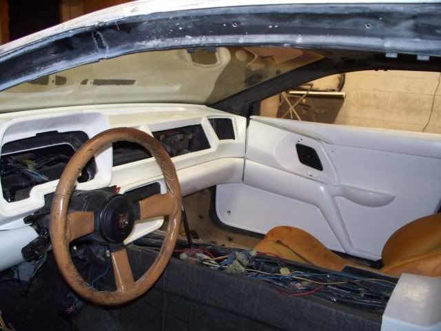

here are some pic's that I took last night.
I finished all the sound proofing on the inside of the car and started test fitting the dash and door pannels
as well as the seats. I am still not sure if I am going to use the stock Fiero seats but I want to get them as low as I can in the car so I don't hit my
head on the roof.
the whole inside of the car has been done in Dynamat and then painted over with the edead.

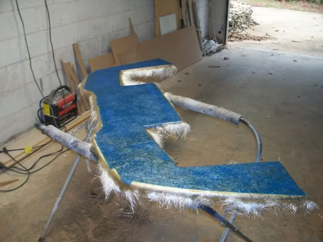

whodeanie MAR 20, 07:45 AM
last night I worked on the front lower. I made a pattern using 5/8 MDF to get the shape then once I was happy with it I took
it and used a trick that my friend taught me if you tape over the wood and then fiberglass it it makes it easy to remove the fiberglass from the wood.
I don't want to leave the wood in because it makes it heavy and the wood would take on water so I just used it for the shape. once the bottom is done I will mock it back up
under the nose and do the top part of the glass. I will make it removeable so if I hit something I can take it off and fix it.
I also have my wheels with me today to get new tires installed I will post pic's of that next monday.
but for now here is the part from last night.
