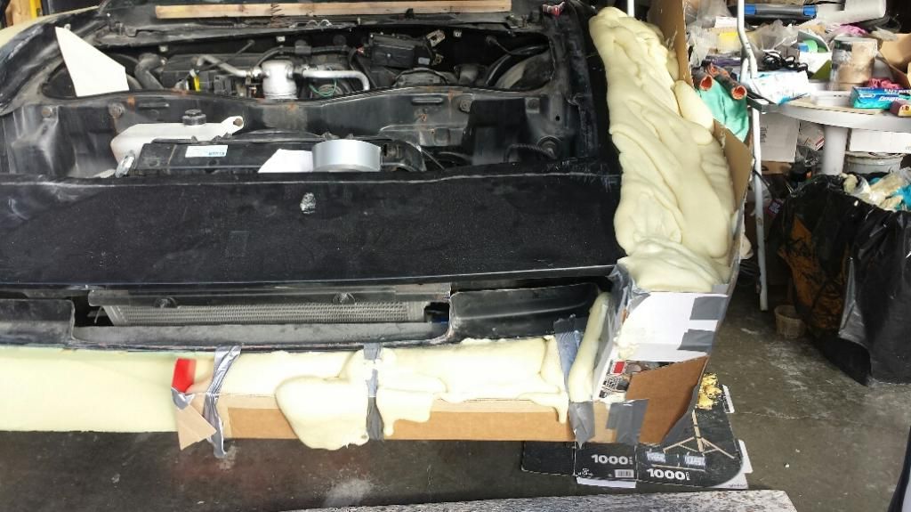

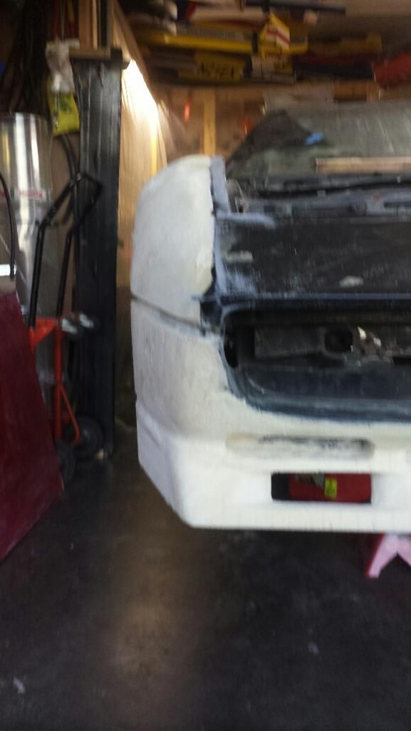

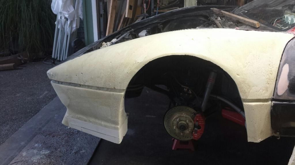

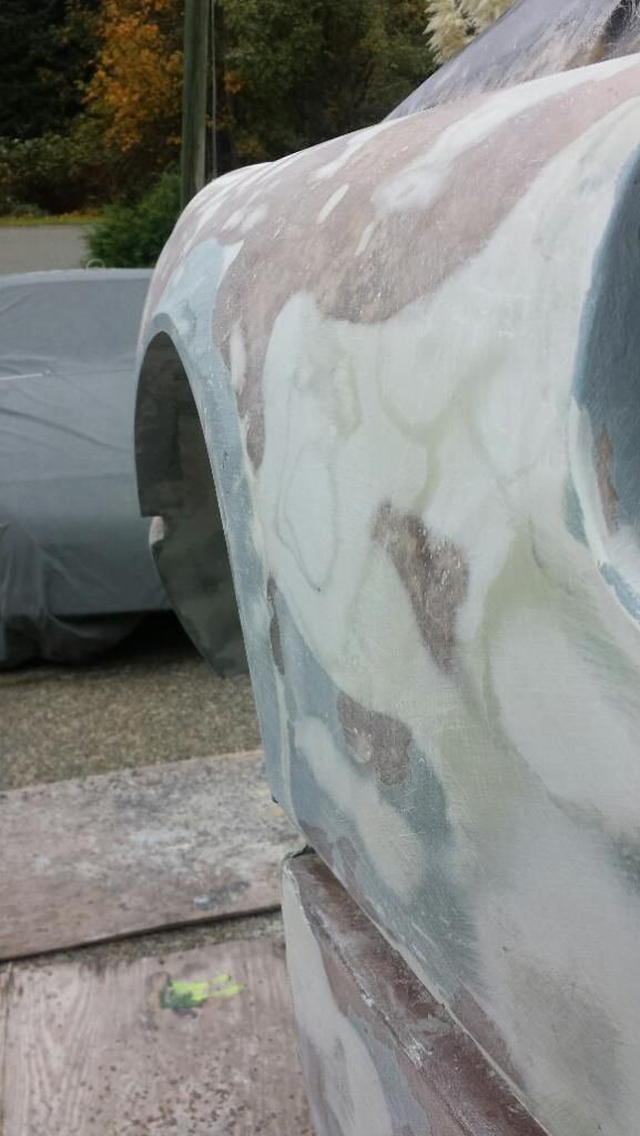

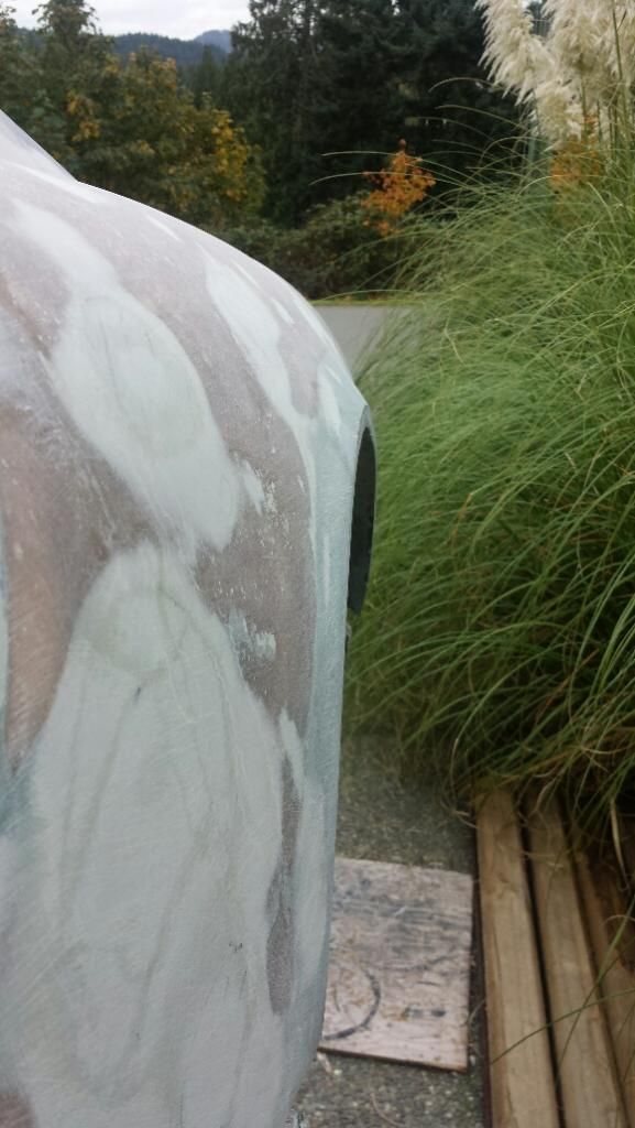

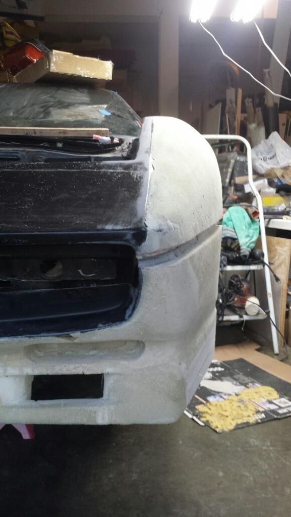

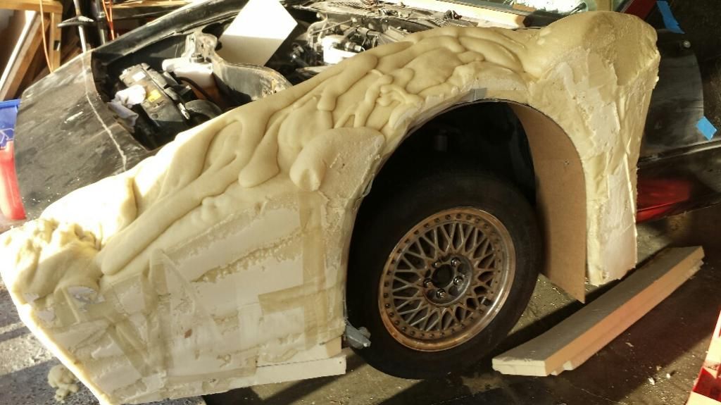

Here is a update to bring those of you that are interested. I finally got the rear clip completed to a point that would allow me to do a high solids epoxy finish to seal the fibreglass, but the weather just won't co-operate. Luckily Don offered up some storage to me so it is in storage for the winter. Giving me some room to work on the front clip.
dobie1
NOV 24, 05:08 PM

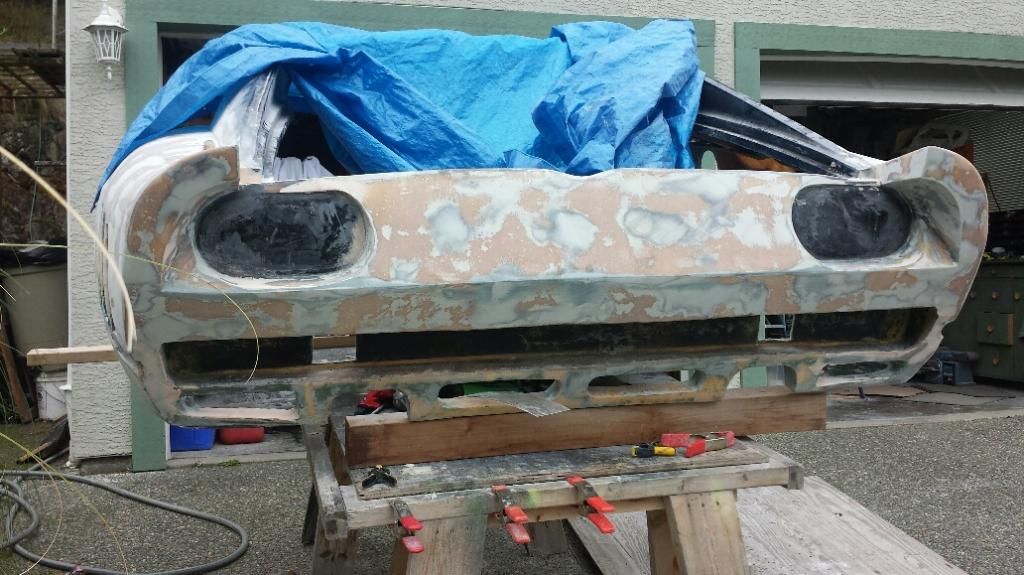

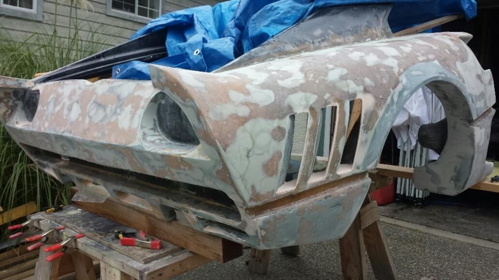

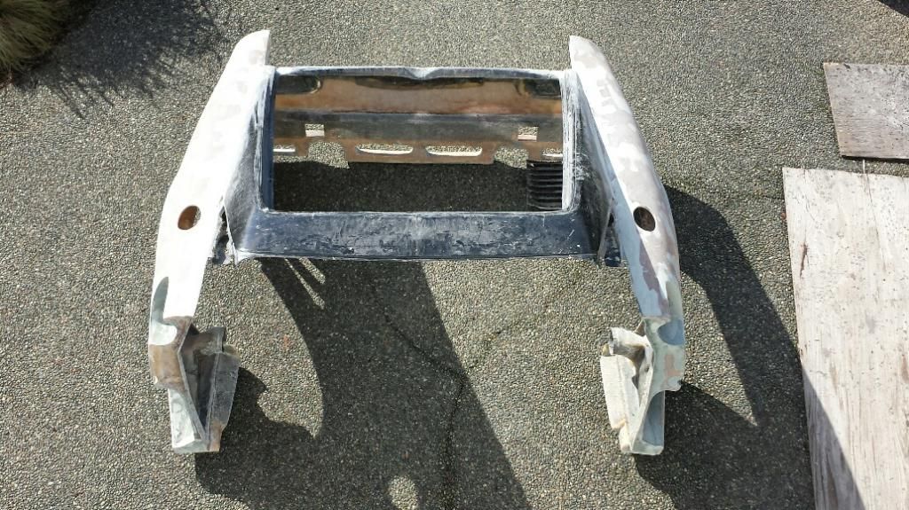

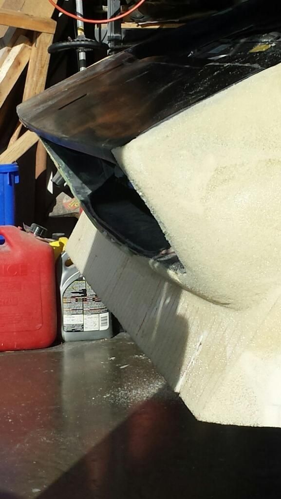

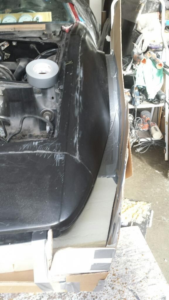

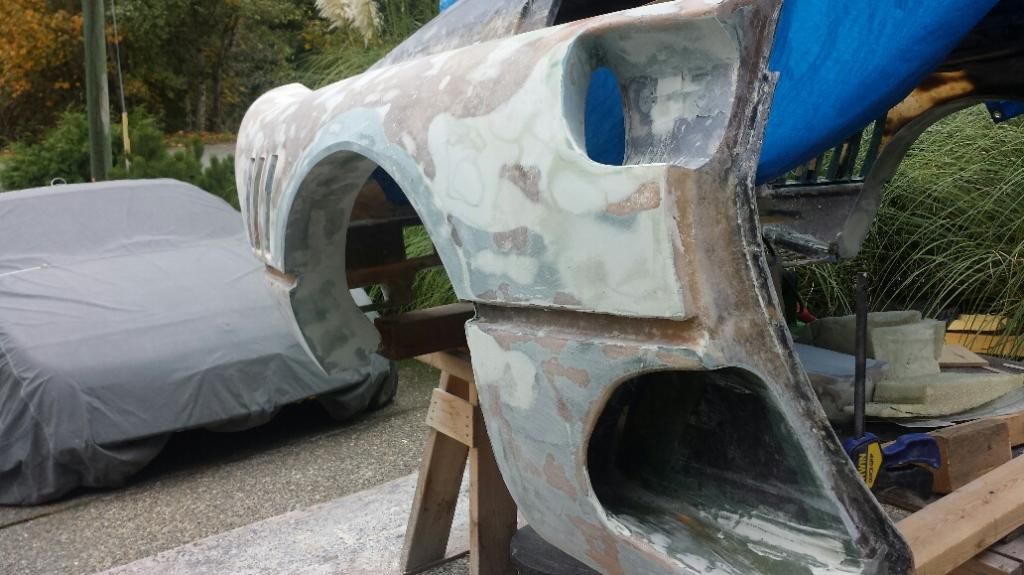

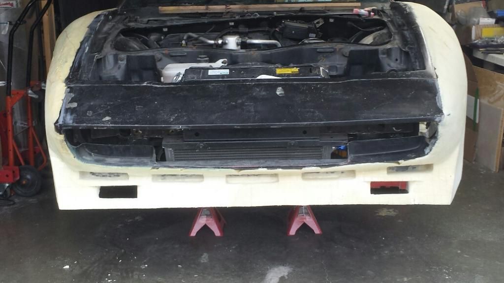

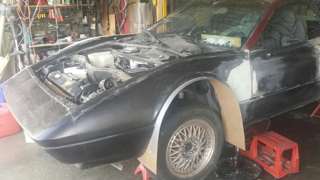

With the car turned around and the rear clip gone I actually have room to work on the front!!! So having done the rear I learned a lot about working with expanding foam the stuff stick to just about anything and once it has finished its chemical reaction is very workable. I had already done most of the passengers side front previously so I only had to do the left (drivers side) and finish both sides to match. I initially cut the vent holes along the chin into the foam but decided to fill them back in for the fibreglassing and then cut them back out and finish off the chin vents. Here are a few pics of the process, enjoy.

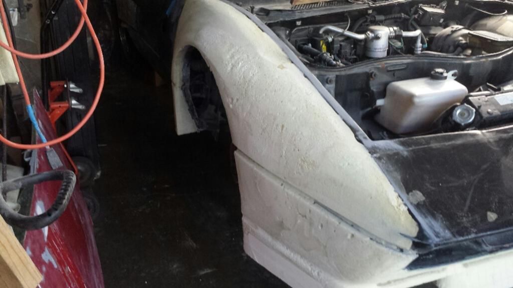

Then on to fiberglassing the the finished foam

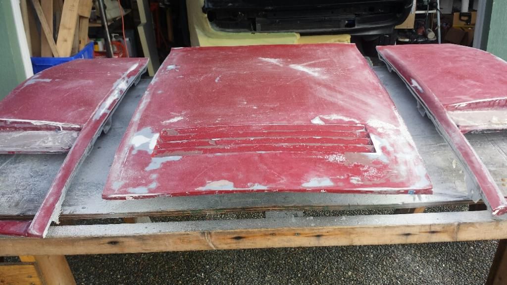

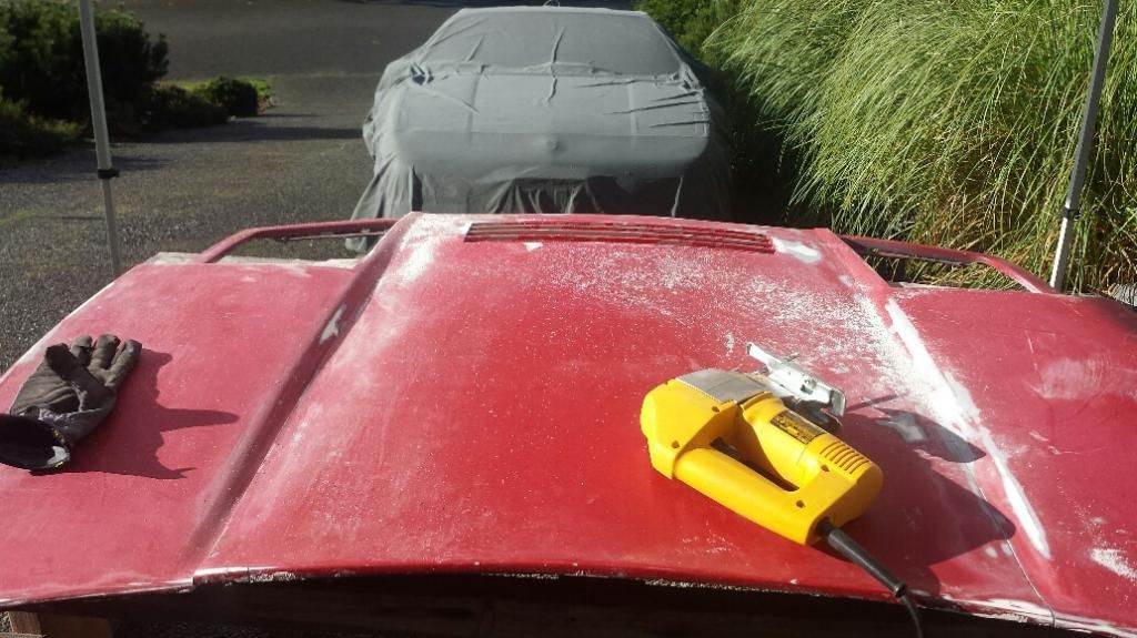

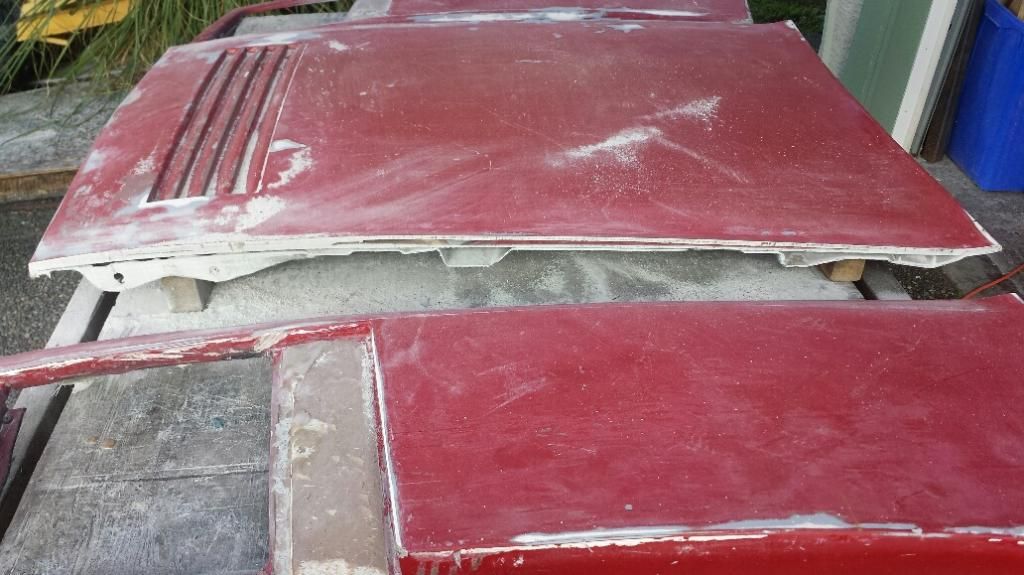

I have finished the glassing now and am currently finishing off the front spoiler vents and chin vents, I hope to have some pictures to post in a day or two. I did spend a bit of time preparing the front hood, as I'm doing the modified Ferrari hood and head lights. Here are a couple shots to give you a idea of how it will go, the side panel will be glassed into the fenders.
