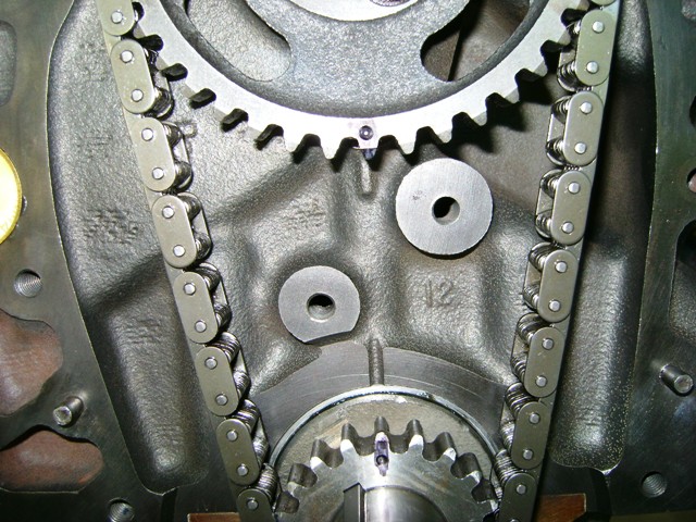

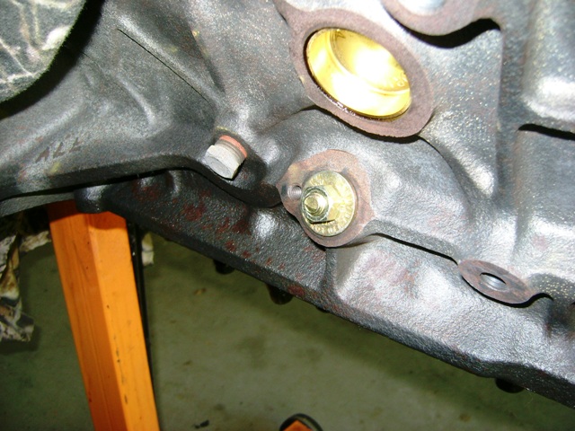

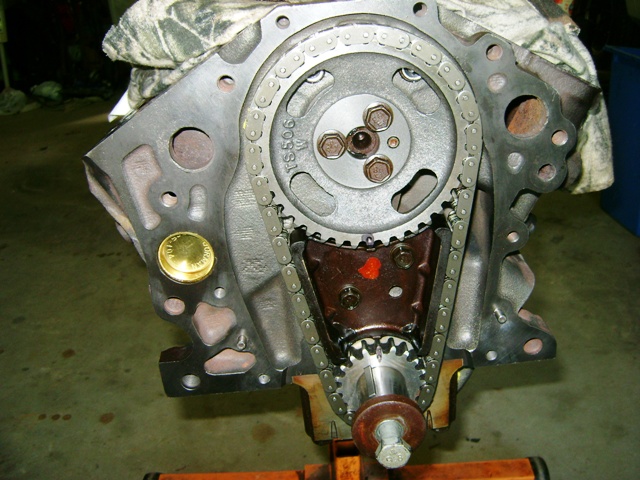

I was able to get a few things done this morning. Installed the expansion plug into the block where the crankshaft sensor used to go:
I marked the timing chain gears with a black sharpie pen to make them a bit easier to see and find. GM was kind enough to cast markers on the block to clock the timing chain and gears. Got all three pieces on the engine block:
And the chain dampener back in it's spot:

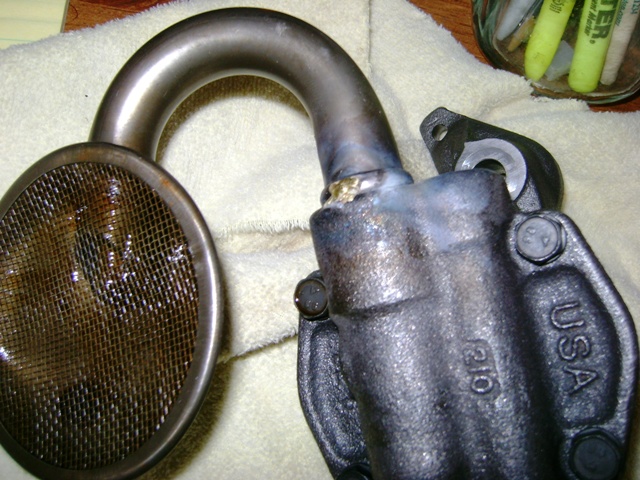

I took my new oil pump to the welder today to have the inlet tube tack welded to the oil pump. Cheep insurance.

| quote | Originally posted by josef644:
Got a PM from Poe last evening. The 2.8 he has for me is ready to come to Lake Livingston. I had a brother in law die Sunday from bone cancer. So we have a funeral to get out of the way before I can go get it .
I am at the point now that I need those parts before I can proceed. Timing chain cover, intake manifold pieces, distributor alternator, starter etc. -Joe |
what size plugs did you use? i have to buy some tomorrow and have no idea what size to get.
josef644
APR 15, 05:32 PM
These are brass Dorman # 565-104, 34.3mm freeze plugs.
The expansion plugs are NAPA 600-4001, The sizes are not marked, but the picture reads true. I just gave the NAPA guy the numbers in the picture and he had two on the shelf.
