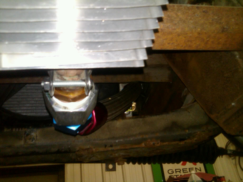

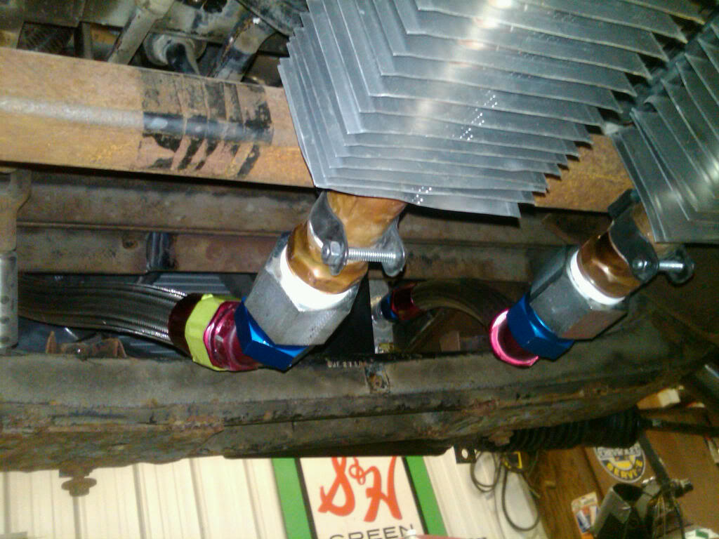

I ordered the radiator lines this week. OMG that hurt! And to add insult to injury, Aeroquip has a backlog on crimped fittings in AN-20 for 36 days. I switched the order to reusable fittings and the lines will be here this weekend. I would have preferred the crimped fittings but what can you do? I'll post photos of the lines in place once done. They better be pretty!

Yep, I looked at Earl's. Aeroquip has the fittings I need in -20, Earl's doesn't. Unfortunately, the backlog at Eaton is killer so I went with the reusable instead of the crimp fittings. There isn't much difference between the two fitting types, I just didn't want that anodized blue on my car. But I'm also not willing to wait 5 weeks. Price is the same either way.

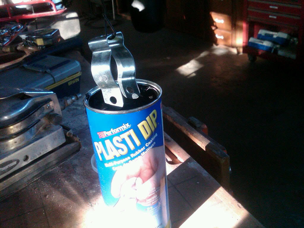

 I figured out how to insulate the hangers from the copper pipe. Someone suggested that I would have a problem with corrosion and I'm sure they're right.[This message has been edited by artworks (edited 07-14-2017).]

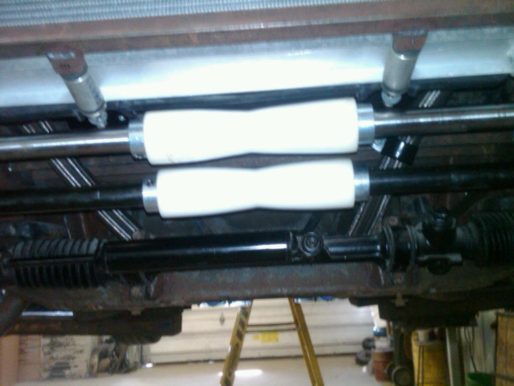

 The radiator hoses are installed! I know, not a big deal, but they sure are pretty.[This message has been edited by artworks (edited 07-14-2017).]

 The lower bar is the antisway bar - 1" solid with splined ends. The upper bar is a 1" piece of cold rolled steel. Together they'll guide the synthetic winch cable under the radiator. Notice the nylon rollers - they've been tapered on the lathe to help keep the cable centered.[This message has been edited by artworks (edited 07-14-2017).]

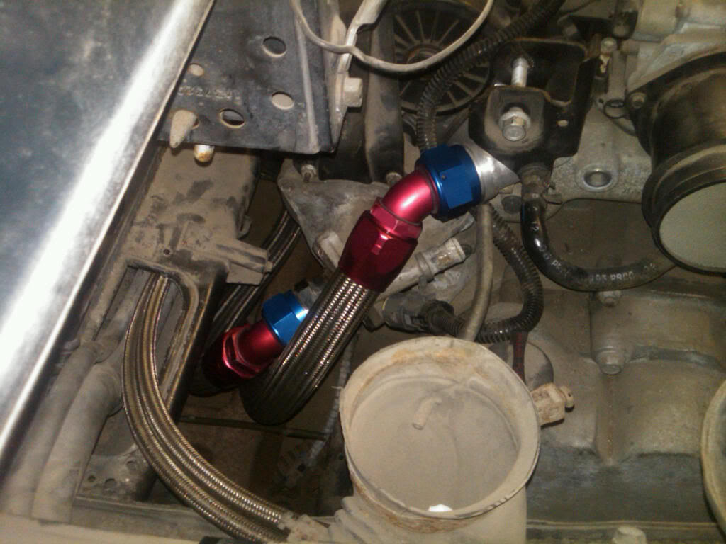

APR 10, 07:42 AM

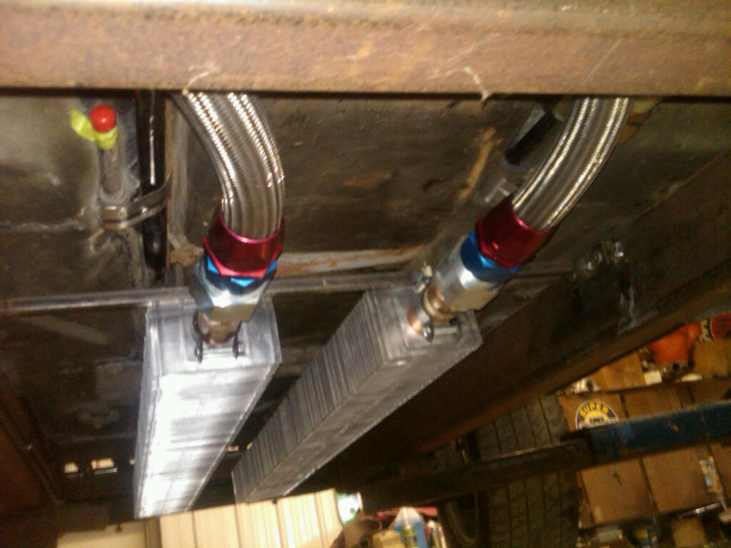

 A few more photos of the radiator lines installed - these from the back of the car. It actually a fair amount of work to make this happen - cutting off the existing hose flanges and welding on AN-20 bungs to the water log and the thermostat housing. You can also see the fuel lines in the lower left corner of the second photo - all braided from the tank to the injector log.[This message has been edited by artworks (edited 07-14-2017).]
