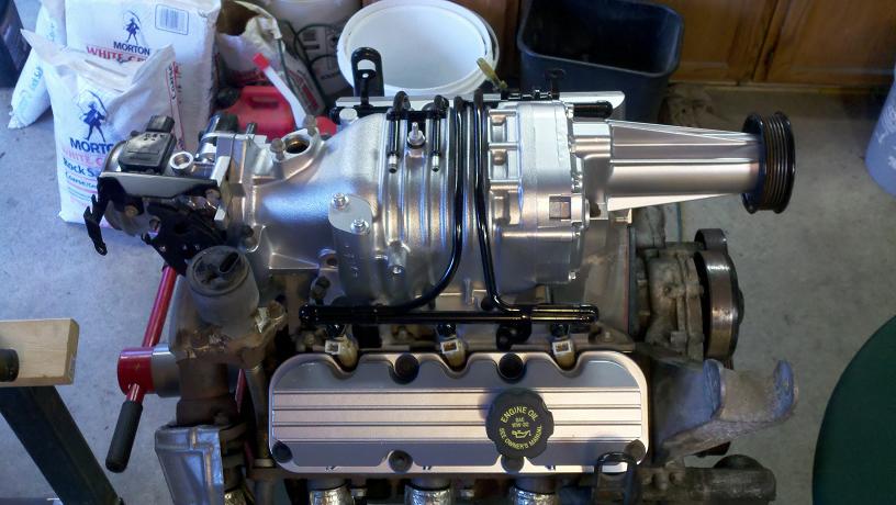

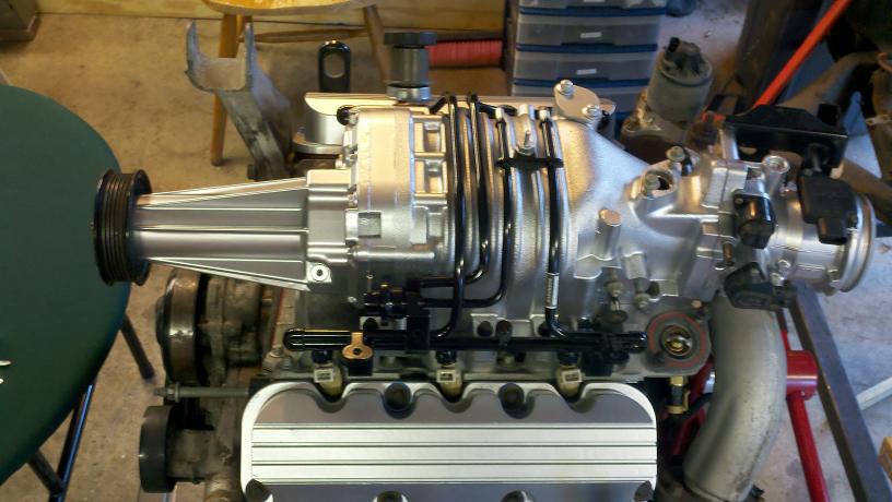

The work i just did on the motor is the cost of gaskets and spray paint and elbow grease.
hercimer01
JUN 01, 12:18 AM
And the fuel rails painted.

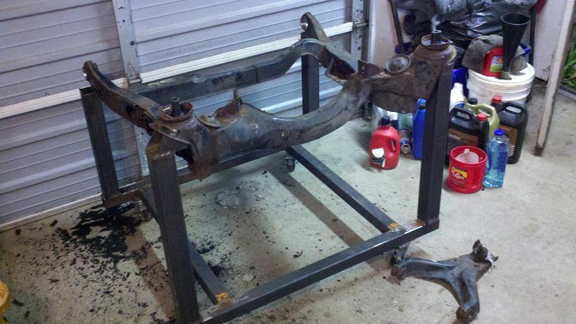

I got the 2.8 engine off the cradle finally. The cradle is in really good shape for a northern Illinois car but still needs to be sand blasted. I found someone local who said he would do it cheap. I don't know how much yet, I will drop it off this weekend. [This message has been edited by hercimer01 (edited 06-08-2011).]
hercimer01
JUN 11, 05:13 PM

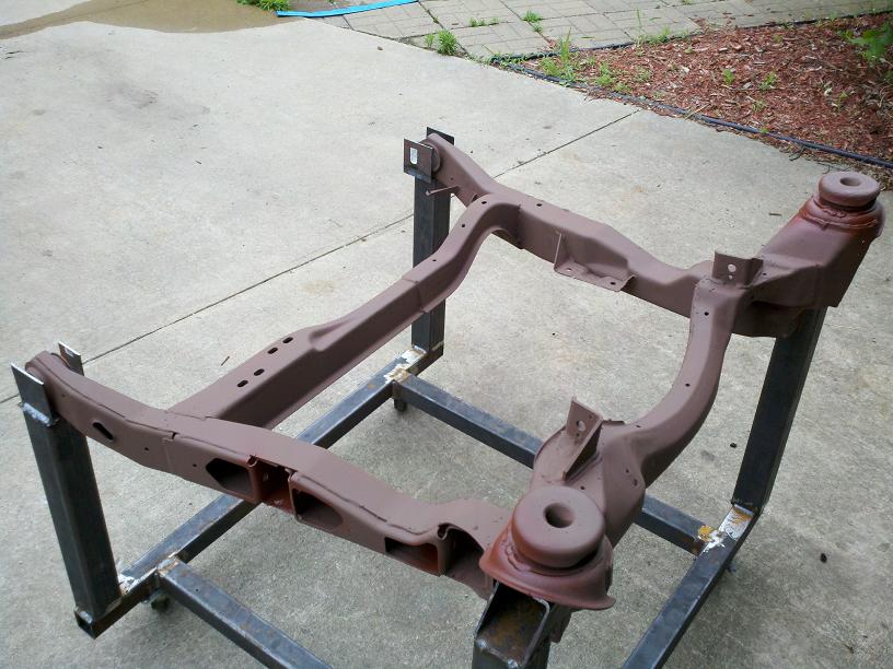

Before
After, primer only($120)
