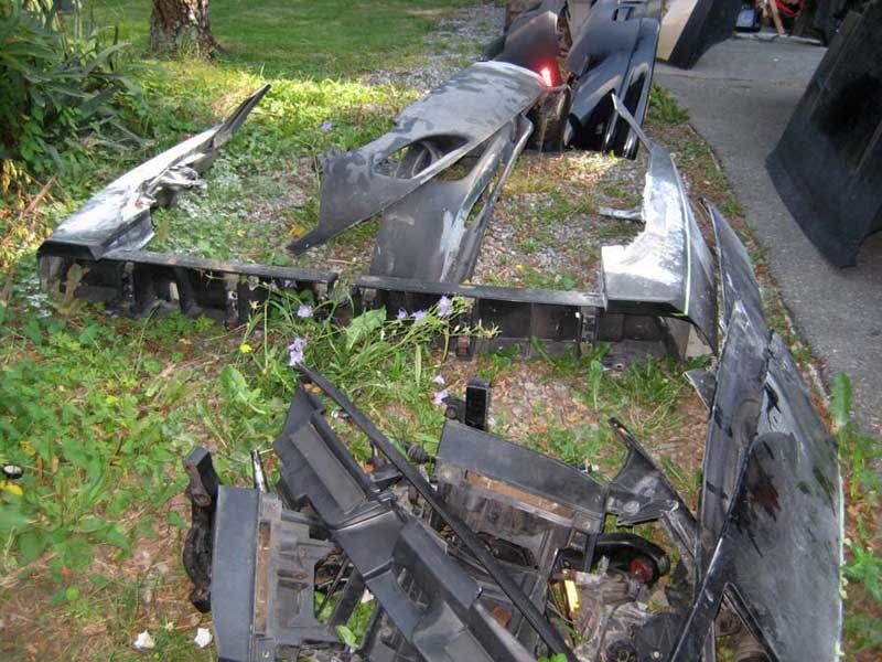

LOL, it's amazing what you can do to a Fiero w/ a sawzall.

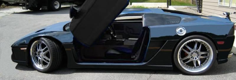

| quote | Originally posted by Letsbuildanexotic:
Thanks Infinitewill, been on this forum for a bit, never knew how to do that.
Hope you don't mind, I like your design so much I wanted to steal some idea's for my chop top, the quarter windows being one of them, from the scoop, down the bottom door sil, up the door and around the window, back to the quarter, it all flows and makes a cool shape that is continuous, only to be broken up by the widebody on the on the top half of the door. But your mind sort of fills in the blanks, I like it. The other que I like is how you extended the tail light corners to make it flow more with the rest of the car and made them more angular on the sides.
I thought about somehow making a scoop on the hip part pointing down, don't know how it would be done yet, like the Gallardo:
You see that small scoop on the sides, well on the top of the hips. Works for that car atleast.
Well, this is a ways away, still have about 14 miles of wire to contend with from the engine harness, since it's my first wire harness I had ever done it's taking a bit longer than if I knew what I was doing LOL.
Keep up the good work, I'm excited to see what's next.
Chris
Thanks for sharing Chris, the extended rap around corners on tail light panel, I used sheet metal cut to shape and rivet on back of panel, fibreglass it, drill out rivets and bondo for the finish. There are many ways to do that I'm sure from PFF pro guys.
What I'll be doing is a MISH MASH of lambos, Gallardo, Aventador and a touch Ferrari

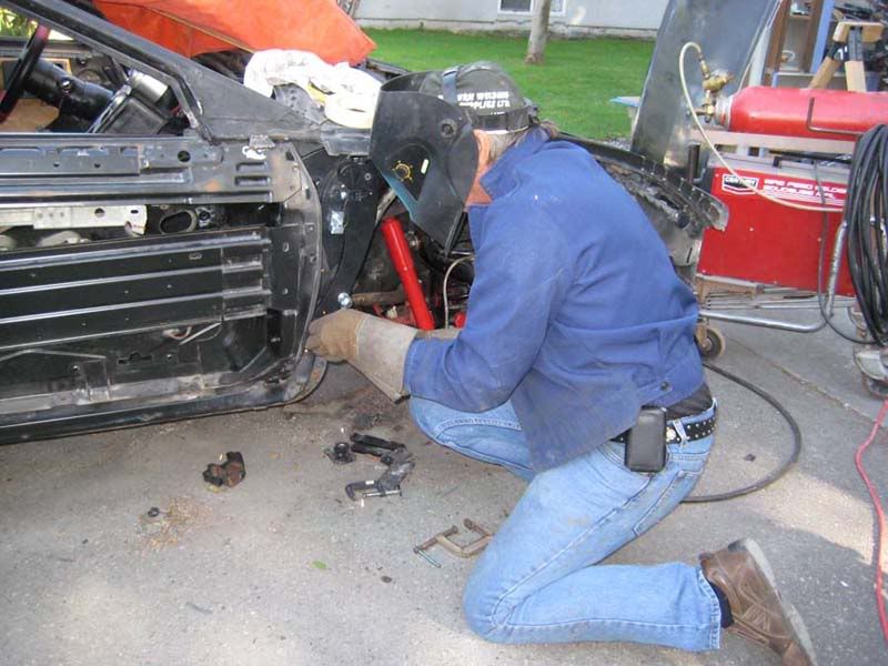

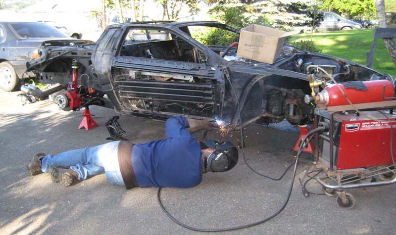

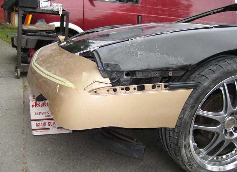

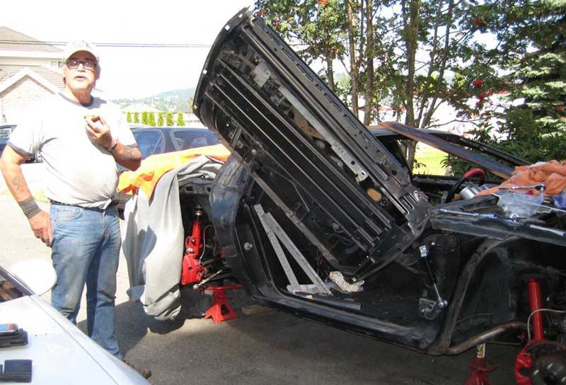

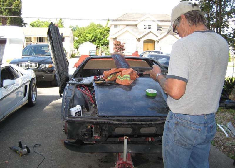

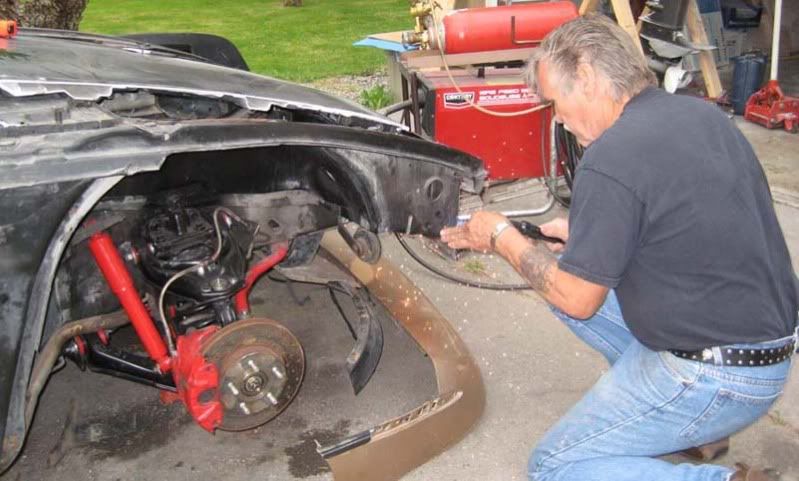

To get that exotic lambo flavor, we lowered the front 2" and back 2", Clynt tack welding front back together ...
Cutting and bending sides down to meet 2" drop...
Difference between stock and new lower nose and hood

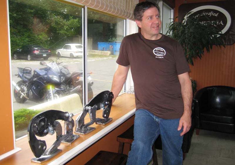

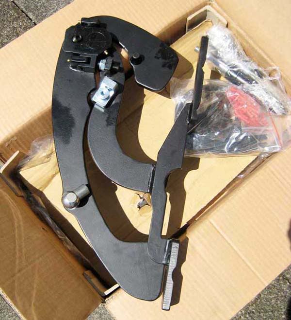

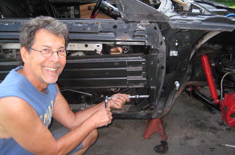

Nice. That is is best because the system includes one single arm. That prevents the top or bottom of the door kicking out with the window is rolled up and down.

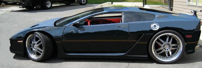

Well, first I was elated to see your thread posted here on PFF. Then I was horrified to see one of my all time favorite (if not the all time favorite) Fieros getting torn apart. Then more horror followed when the Saws-all went to action. I'm anxiously awaiting the resurrection! Please keep us posted!  [This message has been edited by carnut122 (edited 09-28-2011).]
