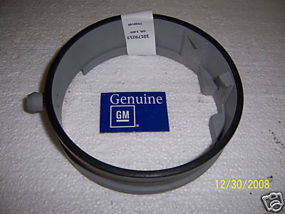

Found this new on E Bay today. I purchased it for my swap. It will allow me to raise the air breather up so there is more clearence underneath:
 $20.00 including shipping. The same guy had a used one for $10.00 more. Go figure that out, new $9.99. used $19.00
Update , got an e-mail this am, it should be here in three days. I'll post the measurements when it arrives[This message has been edited by josef644 (edited 09-08-2009).]

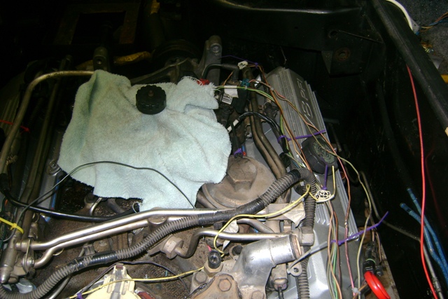

I wired the MAT, MAP, TPS, EGR and OXY sensors this evening. I need to run all of th Pink/Blk wires tomorrow. Once I finish all of the pink/blk I will start with the C203/C500 merging with in the Cadillac Fuel Injection harness.
My adjustable shift cable was in todays mail. One more item in the "To Install Later " box. I have a box I put things in for later. I don't want some thing in the way right now so it will be easier to run some of the required wires up to the brake peddle ect. Converter clutch circut has to be added. Maybe a few others.[This message has been edited by josef644 (edited 09-13-2009).]

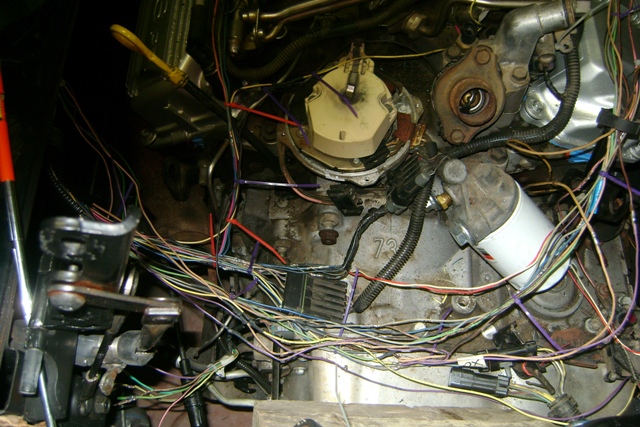

Wired in the VSS wires and the OXY sen wires today. Played in the cabin a bit, trying to organise the wires some. Temperature outside was only 85 today, but the humidity was 100%. Here is the way it looks right now in the engine bay.
I plan on clipping the wires from the ECM leading to the ALDL tomorrow. After a chat with Dodgerunner yesterday, I am going to wire ADL position "M" into socket "E" in my ALDL. This way my 'Dodgerunner' cable might just work with the TunnerPro software. Worth a try. If it will work I am gonna also connect it in to the "M" socket. If I ever use someone elses cable it will still display data. I am going to get the wires togeather that merge with the C203 in the cabin, ignition, power stearing lead etc, and have them ready to solder in. I also want to extend the large ground wire with the 4 ECM ground leadsinto the engine bay, and ground it to the engine block tomorrow.

Do you plan to install an engine oil radiator ?
On one of your pictures, it looks like you cancel the oil radiator hose fitting.
