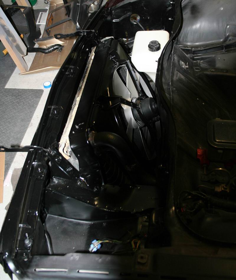

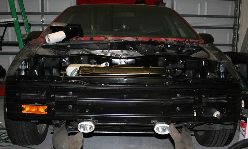

JimmyS MAY 04, 05:44 PM
Progress has been slow cause I have been doing 3 things...
1st - hours have picked up at work. I only have a part time job and my girlfriend works there also. We normally team up and do the work together. We picked up a few more stores so hours have picked up.
2nd - Taking my time and trying to not look over any details. I re-wired the whole front end.
3rd - Procrastinating. I don't know why but I seem to have lost motivation. I am working on it slowly but surely.
A before pic...
After...
The front portion of the front end is almost completed. I still have the spare tire compartment to paint and the rails where the fenders attach.
All of this stuff used to be located in the headlight bucket area on the drivers side. I moved and re-wired it all to clean up the areas that people actually see.

Rolling Thunder MAY 04, 05:58 PM
I've got a suggestion. Those fog lights look out of place. The last owner of my Fiero put some rectangular ones in that almost look stock:
I really like this idea! Might just have to do something similar on my blue fiero.
JimmyS MAY 14, 11:30 AM
The only problems with this idea is... If one of those relays goes bad, it will be a lot harder to change.
If you decide to do this, be prepared to cut, extend and solder a lot of wires. Don't take the short cut of using butt connectors. Use solder and heat shrink tubing to save future corrosion problems.
Also keep in mind that some of those relays you see in the pic, you will not have. I have the Munson headlights so that added a couple extra relays and I also have driving lights which added another relay and a fuse.
[This message has been edited by JimmyS (edited 05-14-2009).]
