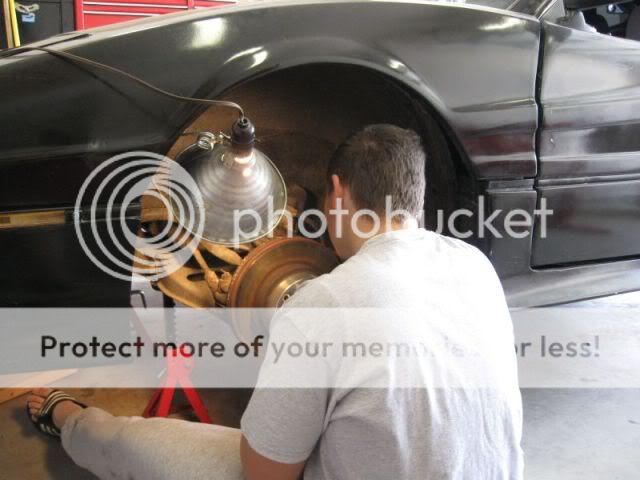

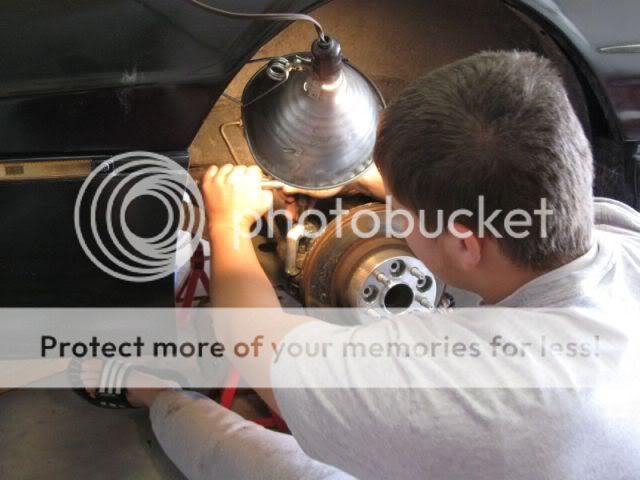

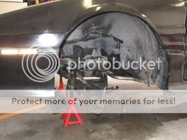

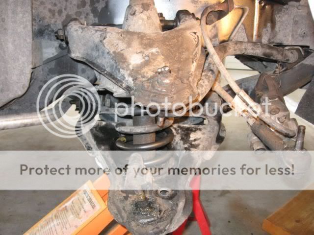

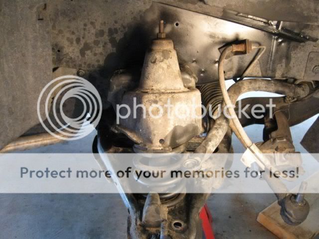

Weekend update:

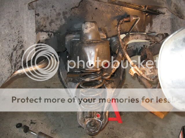

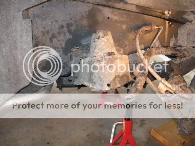

Was time to tear the front suspension apart. I did the right side and the boy did the left. Now we have to do a lot of clean up, burn out the old bushings, grind off the old ball joints, paint and reassemble.
Here's the right side coming apart:
Had to torch the shock off - the only thing that was too rusted to remove with a wrench:
 Took me all of 45 minutes........

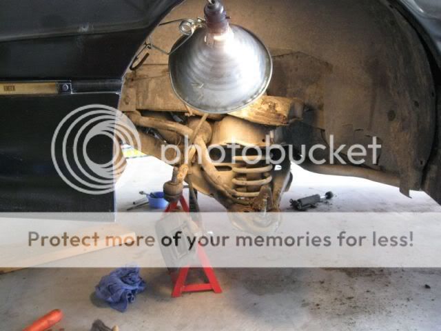

And the left side:
 Took him 1.5 hours to get this far - now I have to finish it. Teenagers just do not have a great attention span.
I also have to remove the inner tierods from the rack. Should have it ready for reassembly tonight.

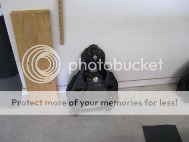

Thanks for the heads up on the light - it has one of those rough service bulbs but I'd bet if you hit it with any type of fluid it would blow. Sorry for no pic.....here it is! The plastic bushing has three "tabs" inside the rack tube. I can get them all squeazed in but can't get the bushing to pull out - it will spin but won't come out. I ordered the replacement bushing from RD. Hoping he has some instruction on removing the old bushing. I really wanted to get it out before the new parts get here - to install RD's new bushing, I have to polish all the rust off of the rack shaft. Any help is greatly appreciated.

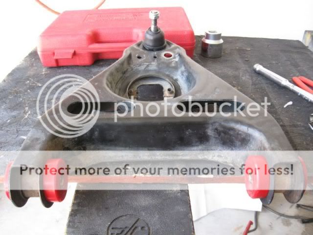

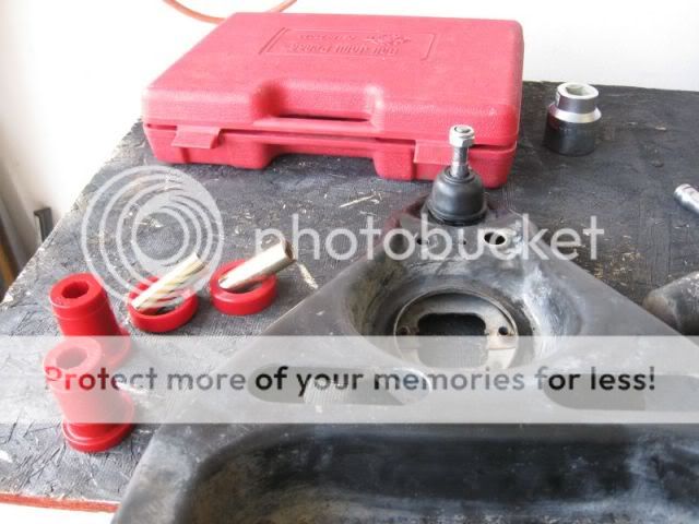

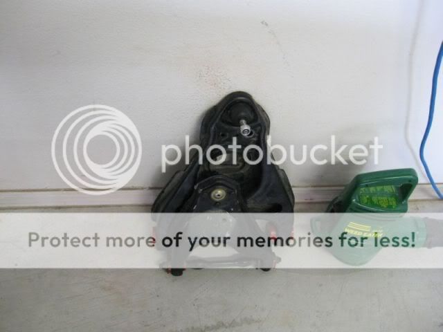

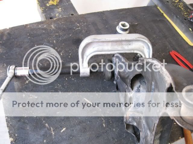

Got all the bushings out of the A Arms last night - started drilling them out but broke 3 bits and a knuckle or two so I resorted to burning them out. What a freakin PITA and mess. Took longer to clean up the mess then it did to get em out. Also knocked out the lower ball joints.
Today we ground off the rivets for the upper ball joints and got them off. Was a little worried how I was going to get the new lower ball joints back in. I do not have the tools to do it. Dodgerunner gave me a swift kick in the buttocks and reminded me that I could probably get a loaner tool from somewhere. I went to AZ and they had one. So I got the lower ball joints pressed in and the upper ball joints installed along with the new poly bushings.
I was reading some threads on the front poly bushings and there seems to be some debate over whether or not the thrust bushing should be trimmed, wedged in or left out entirely. I checked these out - held them up in place on the car and do not see where I have to trim them or where I would have to force/wedge them in - it is tight but I could pretty much push the a arm into place. Maybe they are slightly different on pre 88's?
So anyway, I am ready to start the reassembly process. I also got the new rack bushing and zero lash sway bar links from RD today. I'll probably get that taken care of before I stick the suspension back together. RD's instructions say that I can do it in car but I am kickng around the idea of taking the rack out so I can work on it on the bench. That's it for now - back to the garage!
Way easy when you have the right tools!
 Ball Joint in - now for the Poly.
 Tada!
 One set done!
 And the other!
