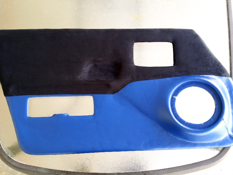

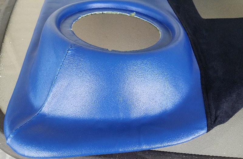

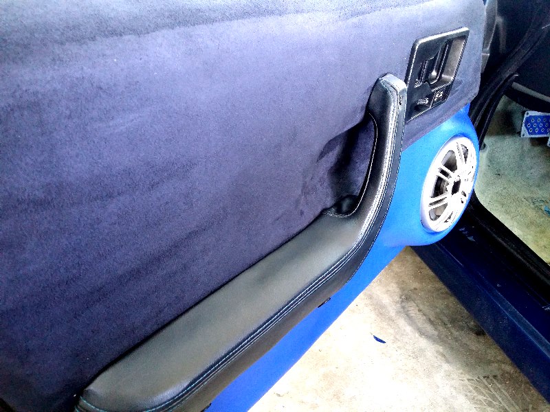

I picked up my door panels from the Upholsterer yesterday. They look great! I went with black micro-suade for the top, and the electric blue on the bottom to match my seats:
He did a bit of nice stitch work to prevent a pleat around the speaker housing:

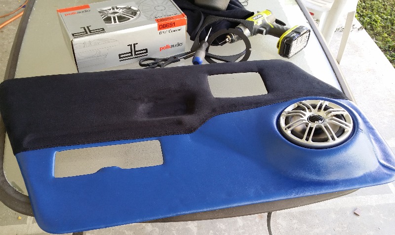

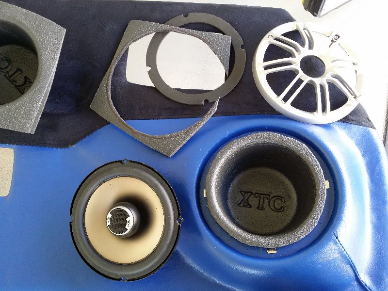

Here is the speaker, baffle and all hardware ready to attach:
Speaker mounted and installed into the door panel:
Here is an angle from inside the car. He matched the color of the seats perfectly!
Lastly, here is a close up of the panel on the door. I still need to add the caps and hardware to cover the screws.

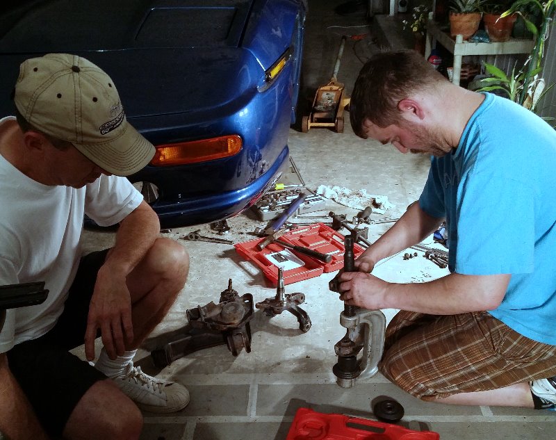

Pressing out the bearings and sleeves proved to be a ROYAL pain! I had to take the upper and lower control arms to a machine shop to get them to do it. It took us over an hour to get one of the sleeves out, and I was not about to do that 7 more times for just the front control arms alone! The rubber bushing is no problem, the sleeve is next to impossible!
Andrew (on the right) and Dean working on getting one of the bushings and sleeves out:
Andrew is here through Wednesday night, and then heads back to what looks like 8"-10" of snow on the ground, and -6 low on Friday

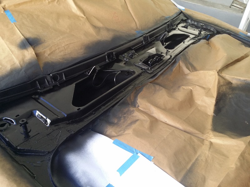

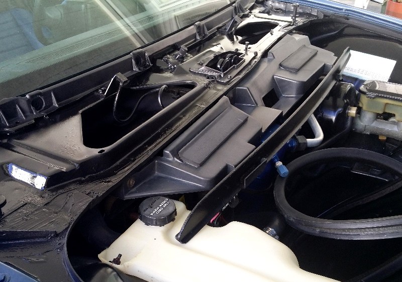

Now to some pictures. A few days before Andrew got here, I was touching up areas on the front of the car. I removed the cowl screen, and sanded and painted to protect it from rusting:
After the masking was removed:

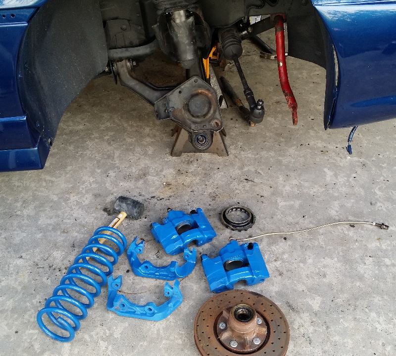

Here are the Grand AM brake calipers, Brackets all painted up and ready to install. Stainless Steel brake lines and the new front Sway Bar also in the picture. I did not get a chance to paint the Sway bar.

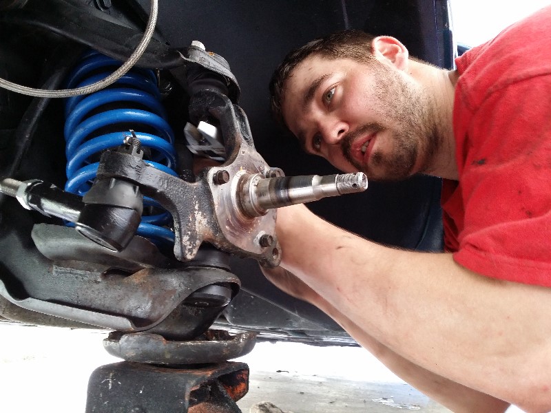

Andrew installing the Spindle and putting everything back together:

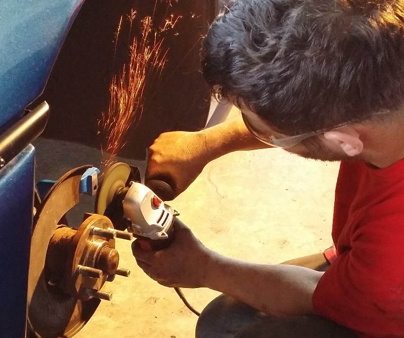

After we bolted everything back up, and went to install the Grand AM brake calipers. It was then we realized the rotor was rubbing and a tiny bit needed to be ground off of the caliper bracket.
The rotor was rubbing:
