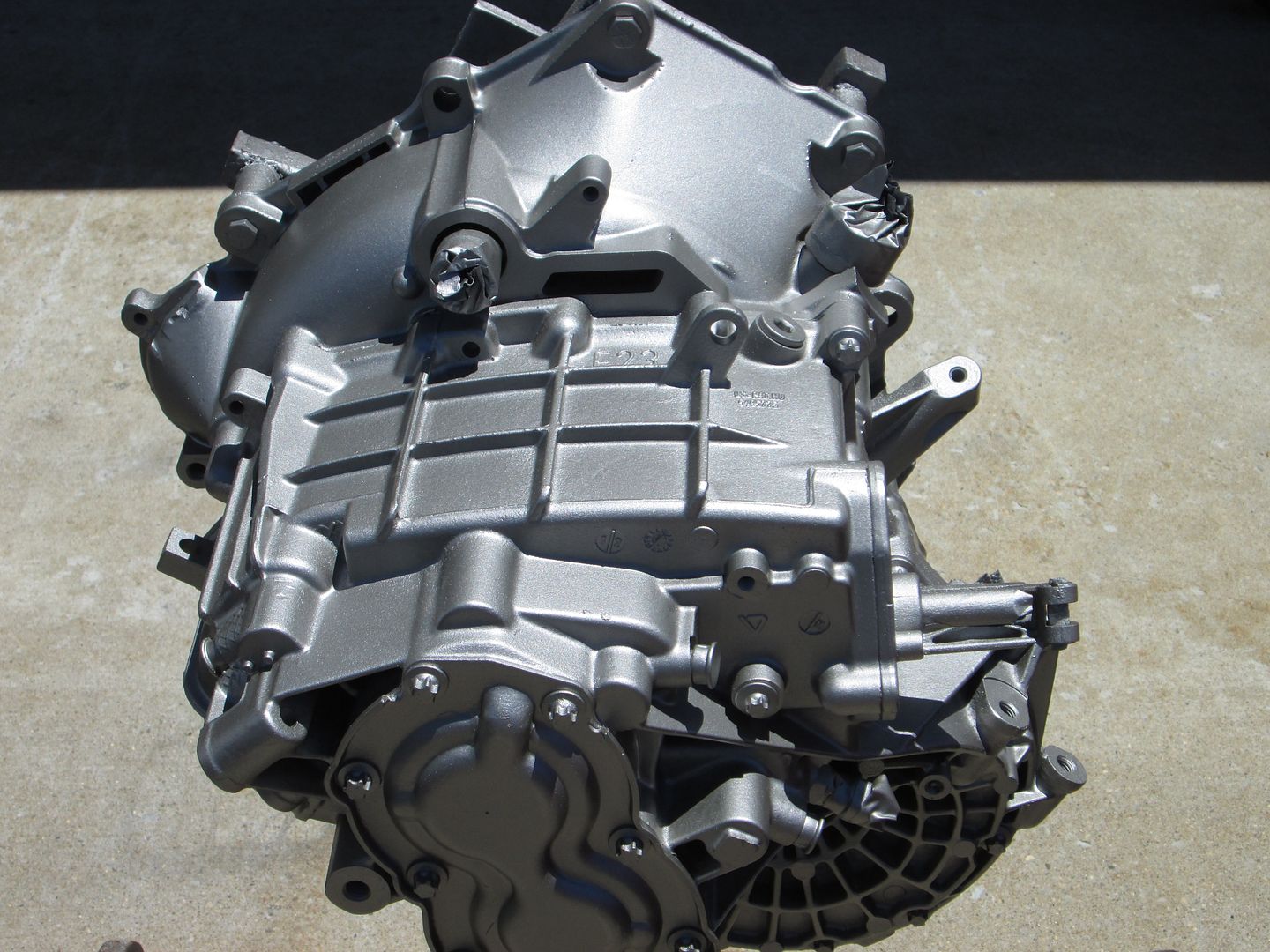

Back from yet another business trip... at least this one was while the transmission was at the shop. My wife picked up the transmission for me on Friday and today I cleaned it, removed the excess case sealant and then painted it again. My goal is to have the car running again by Tuesday.
Transmission soaking up some sunlight as the paint dries:
