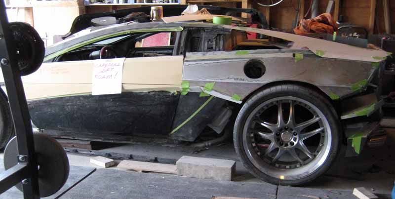

Back to RBS-2...

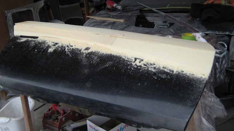

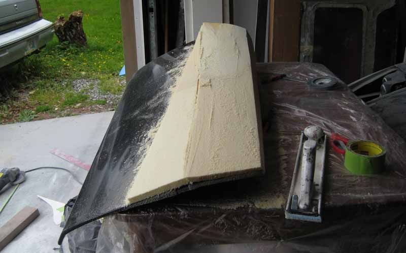

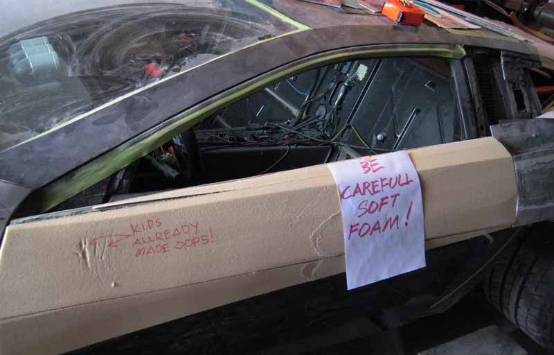

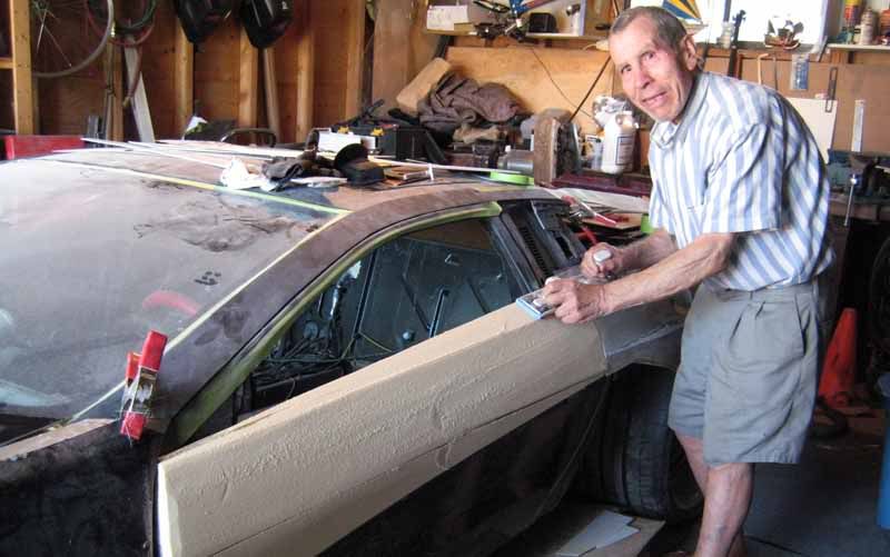

Today I started on other door shaping away
Those grand kids
[This message has been edited by Car-Lo (edited 06-27-2012).]

Where do you get this type of foam?
Also, for the process, I want to make sure I understand the steps:
- You'll lay fiberglass over this to form the mold
- Then coat the inside of the fiberglass with something to prevent sticking
- Then lay fiberglass inside this to form the actual part, adding brackets or mounting tabs as needed(or do you put these on after removing from the mold?)
Maybe I'll just sit back and watch the process. This is very exciting.
Car-Lo JUN 27, 01:00 PM
You can get foam here...
http://www.fibreglast.com/p...Foam_Sheets_440/Foam
This is a one off, no mold I'll be laying fiberglass over foam and that's it
serrata JUN 27, 10:13 PM
Nice. So will you be taking the foam out and then mounting the fiberglass, or are you bonding it to the panels as you go and leaving the foam in place?
I have no fiberglass experience, so this is fascinating to me. Lots of possibilities...

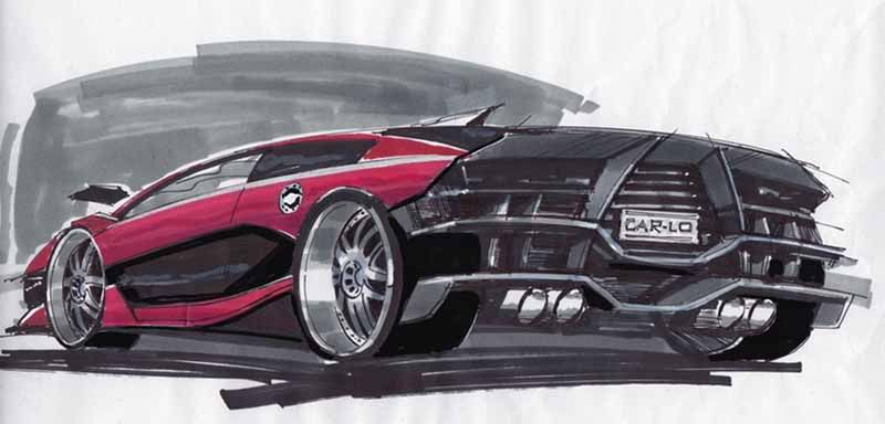

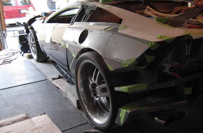

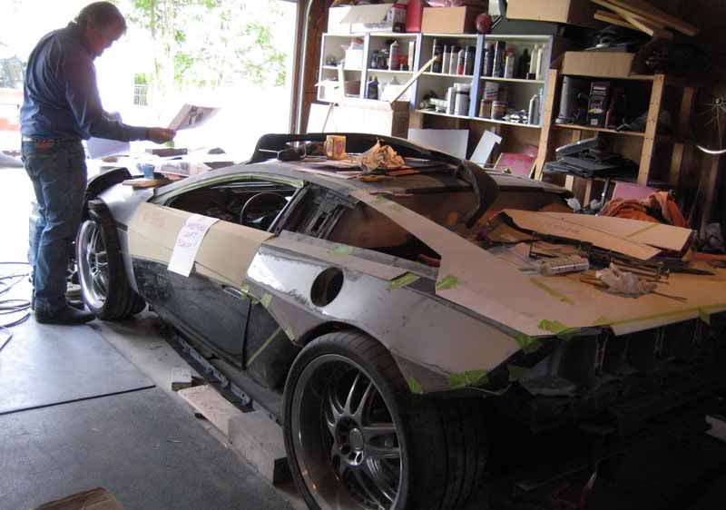

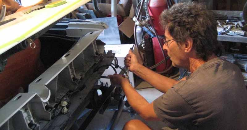

Rough concept sketch...

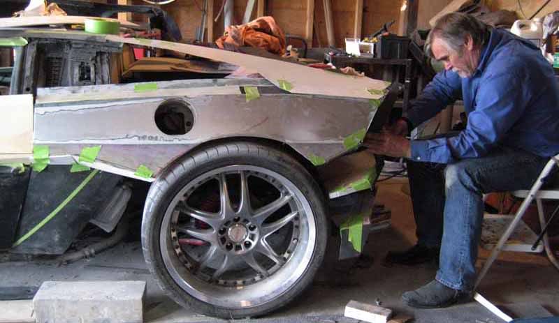

Clynt and I started to play mocking up rear
Clynt already having fun

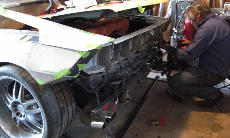

Removing s.m. shelf
Moving harness over so we can work better
Nice and clean
Clynt looking over concepts

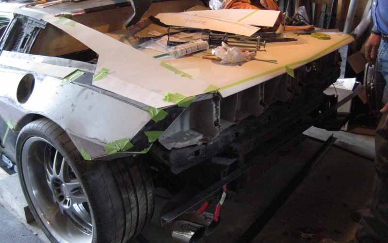

Cutting angle for wing
Exhaust pipes to be moved inboard
It's a start, very rough mock up, design will change to fit
