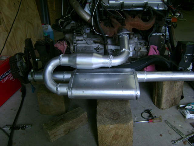

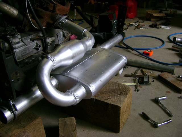

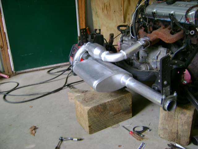

All of these mandrel bends, hangers, clamps,converter and muffler assembled and welded:
I have about $235.00 in the exhaust system as it sits right now.
I left the tips off so when I have this raised up in the car I can center the tips in the exhaust opening so it looks good. I am pretty happy with the way she has turned out. I'll do some other small stuff tomorrow so I can get it back in the body this weekend.

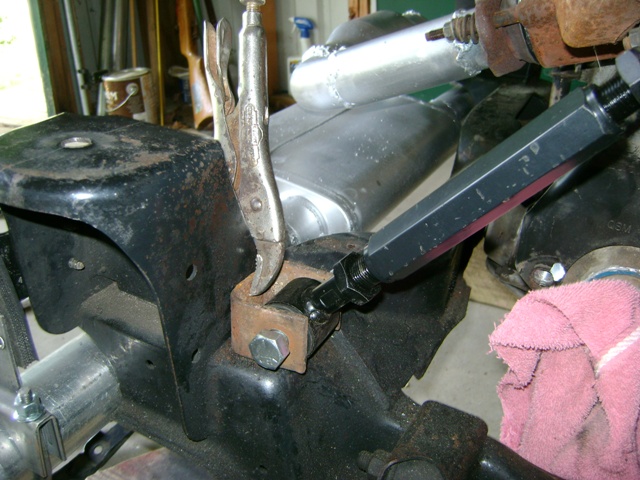

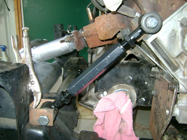

I found one more thing I needed to do before I remount the cradle. I had forgotten to get the mounting bracket for the torque rod welded while my welder friend was here a few days ago. He is coming back tomorrow afternoon to weld this on the cradle:
I am planning on stuffing this back in the body Tuesday morning before the humidity gets to high

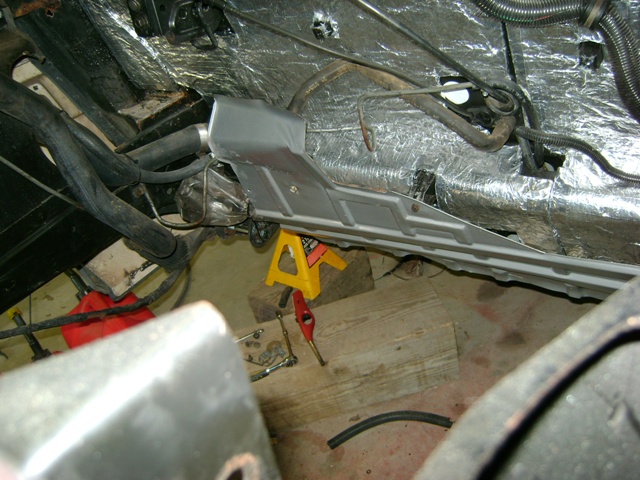

Now that I have my my transmission and the shifter working together I am finished with the shifter cable. I removed the ECM and its tray and installed the shift cable in the car. Replaced same. I patched over the open hole where the second of the stick shift cables went threw. I added the Fiero heat shield to the engine bay:
I still have to turn the vacuum port on the throttle body for the brake booster, and to put the AC compressor back on the engine. I will paint the new weld this afternoon. So looks like back in the car tomorrow morning. My punch out list only has three items left on it to do before reinstall.

Today I got the Cadillac compressor oiled up and mounted it back on the engine. Replaced the belt, and got everything there happy. Added a 9/16 3" long bolt to the torque strut, and the other end to the head. Everybody happy there too. I forgot to add one bolt to the exhaust hanger before closing up the garage for today. I'll do that first thing in the AM. Engine is going back in tomorrow morning while it is cool in the shop. We are supposed to have an Ozone Alert tomorrow afternoon after 300pm.
