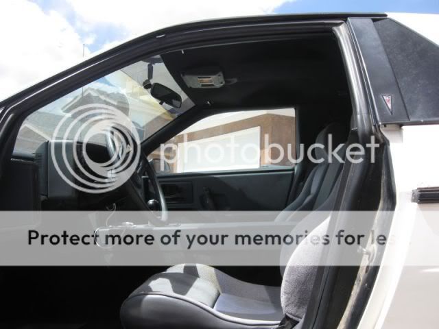

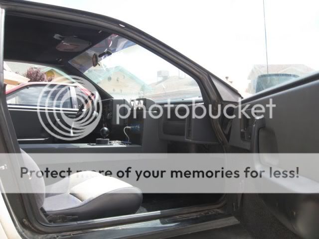

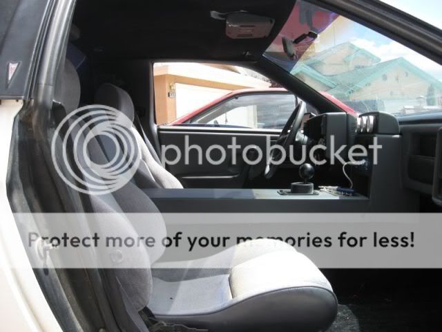

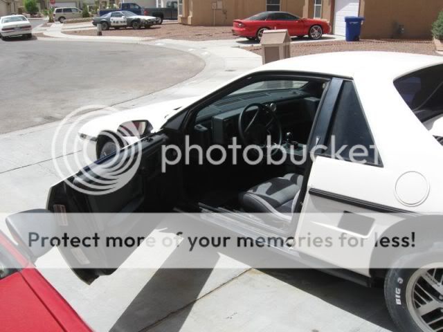

Finished up the door panels today. Turned out pretty good for a toy!
Frizlefrak MAY 02, 06:28 PM
Turned out very nice Pat. Sorry couldn't join up with you guys this weekend....I'm just starting to feel human again....but I'm WAY behind on what needs to get done before San Antonio. I've gotta do some Bonzai wrenching this week.

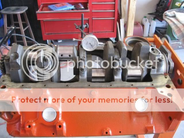

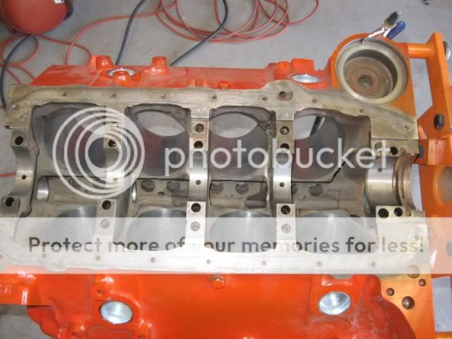

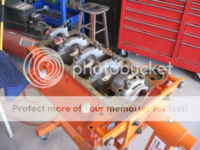

Fresh from the machine shop - bored .030 over:
I went through and ran a tap through all the main cap bolt holes and then cleaned out all the oil passages - I was surprised at how clean it was from the machine shop. They did a great job cleaning the motor - hope thier machine work is as good - this is the first time I have used this machine shop - so far so good!

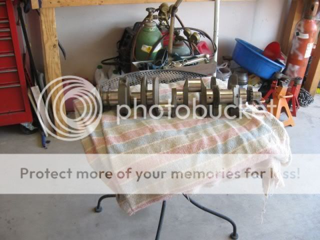

I installed the main bearings and torqued the mains down then mic'd the mains in the block and on the crank - the crank was turned .010 under. All within spec.
Next was to intsall the crank with a new double lip hi perf rear main seal - used lots of assembly lube. Then once it was all torqued down, I checked the end play - within spec!
More this weekend!
