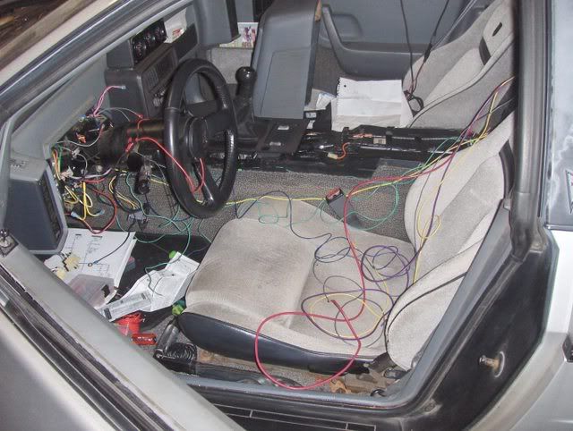

bmwguru SEP 21, 11:35 AM

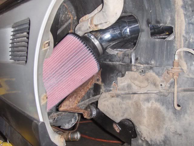

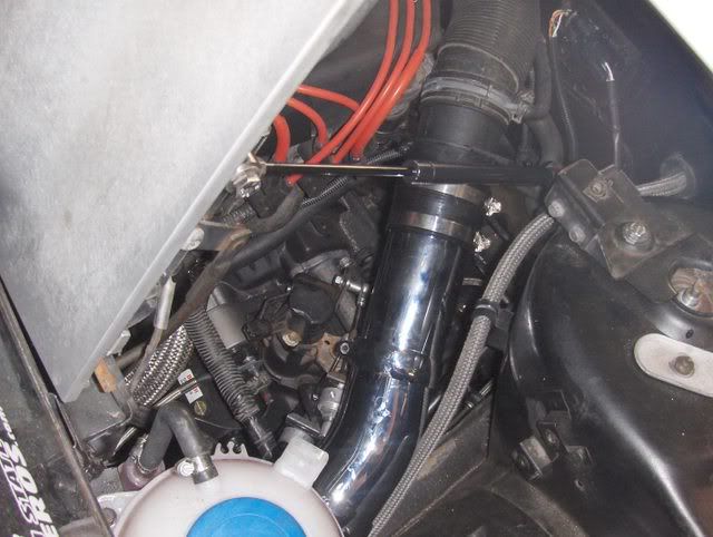

I installed the CAI and the gauges. The intake was pretty simple once I found the parts. The air filter is a little large, but I'll probably change it out for a slightly smaller one once I install the new quarter panels.

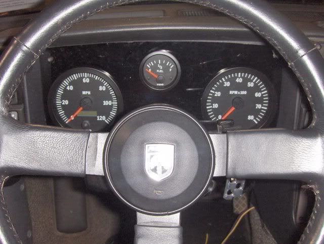

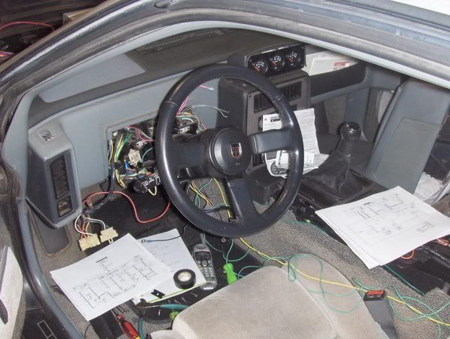

The gauges were not as bad to wire up as I thought they would be. The oil pressure switch was tapped from the oil filter housing. It has two unused ports and all I needed was a 10mm to 1/8" adapter and it was fine. The coolant temp sensor and fan control switch was installed in the pipe that fed the radiator (at the engine). The tach signal I took right from the ECM wiring to the cluster. I was able to fine tune the tach by watching the tach and the rpm reading on the VW laptop. Same for the water temperature.
The speedometer is all that is left to calibrate and then the gauges are done.
The car is still a few months from completion, but it is coming along nicely.
I was having issues with an extended crank and found the starter switch to be defective out of the box, so I replaced it and the engine fires right up.
Dave

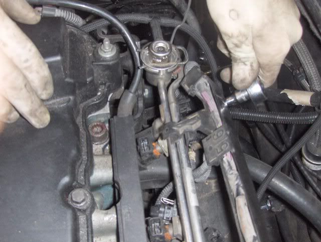

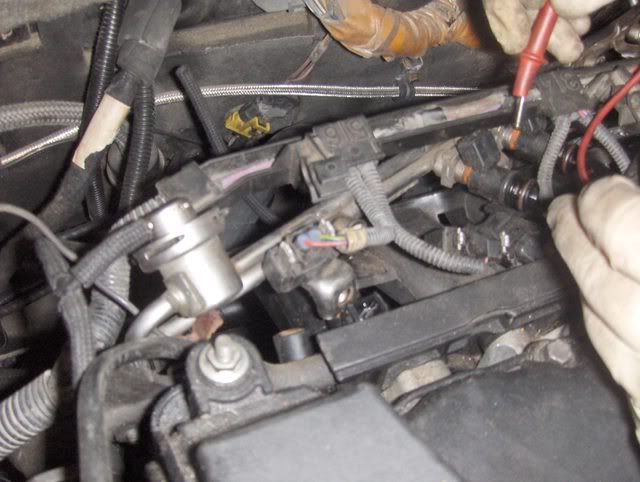

Found an injector problem during the initial testing, so the upper intake and fuel rail had to come out today. No Biggie.
