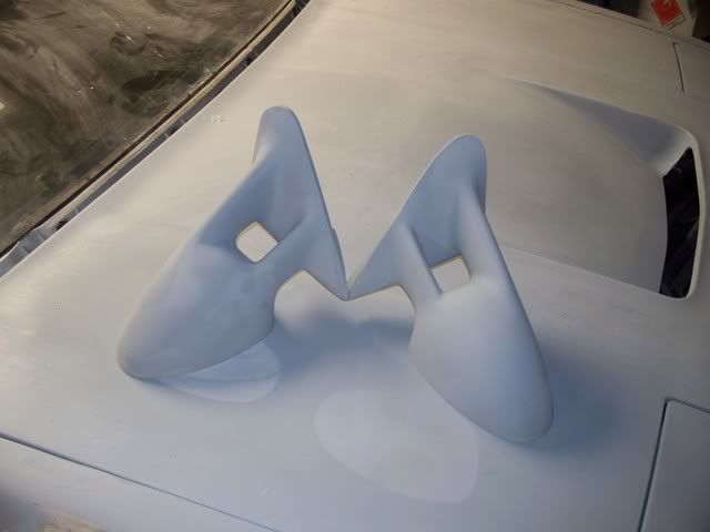

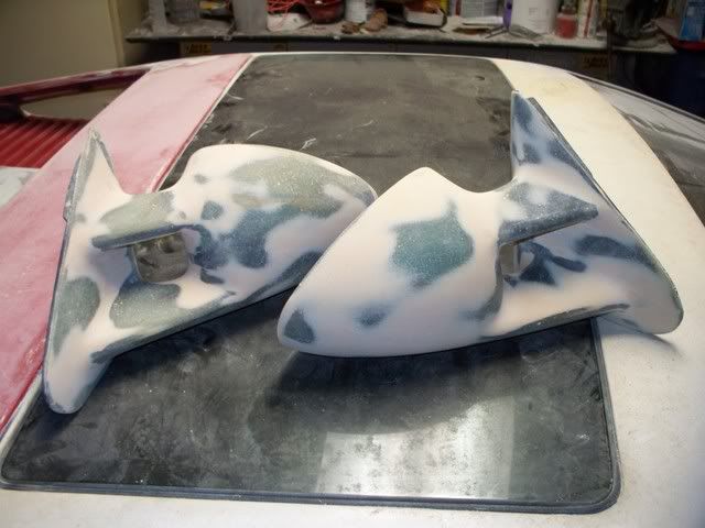

I am still sick of bodywork so I decided to work on other things. first off I did do a little body work on my Mirrors and got them in primer.
I have taken the stock Fiero mirrors and pulled all the guts out of them so I can make my new mirrors power using the stock Fiero parts. plug and play!

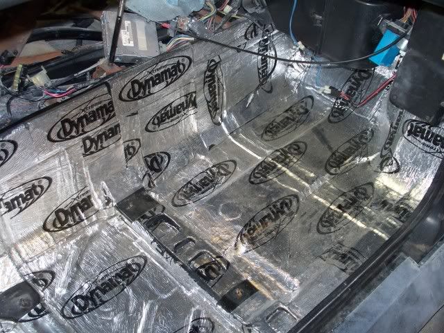

after I got tired of body work I decided to work on the inside of the car. first off I plan to do a sound system in the car and with space being what it is I cut the back wall behind the seats to give me a little extra room. I then boxed them back in and started installing the sound mat on the inside of the car. evrey surface on the inside of the car will be done
as well as the back side of all the trim and dash as well as the doors I will use one layer of Dynamat on the doors but I will also cover the inside of the door skin with the supperlite
mat. I want to keep weight on the doors down but also keep the rattles away.
here are a few pic's from this weekend.

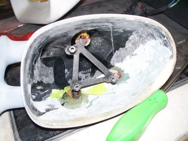

just a little update... last night i worked on the mirrors I took the guts out of the stock Fiero power mirrors so I could install them in to the new mirrors.
I used a dowell rod to mount the plate to and fitted it into the housing then I used a 1min. epoxy to set it in place. I will also glass over all of it later to finish them.
I amusing all the stock Fiero guts so it will be plug and play as far as the mirror itself I will use the stock backing plate but I will cut it to fit then install a mirror that I will have
to cut and fit by hand but for me this is no big deal because I own a glass shop and I do this every day. I will post a pic once photo bucket gets done with the update they are doing now.
here is the pic....
