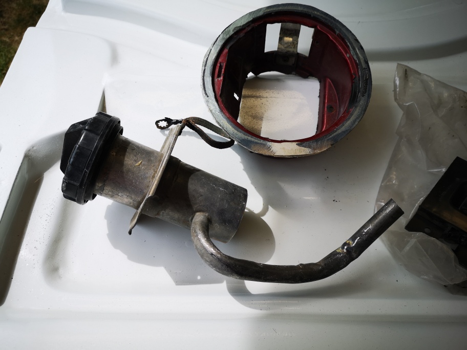

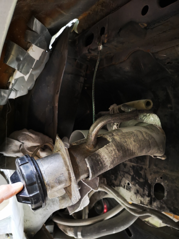

Hi Wayne. Got a question for ya... You may have seen my stuck with the fuel door and filler tube.
Curious if you have any pics showing what you are doing??
thanx,
Bob
dobie1 AUG 10, 11:05 AM
Hi Bob
Yes I saw your post, and yes I do have a work around. Let me find everything and I'll post some pics.

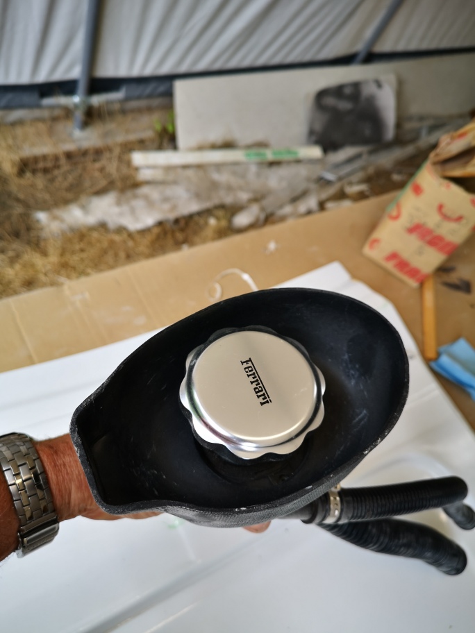

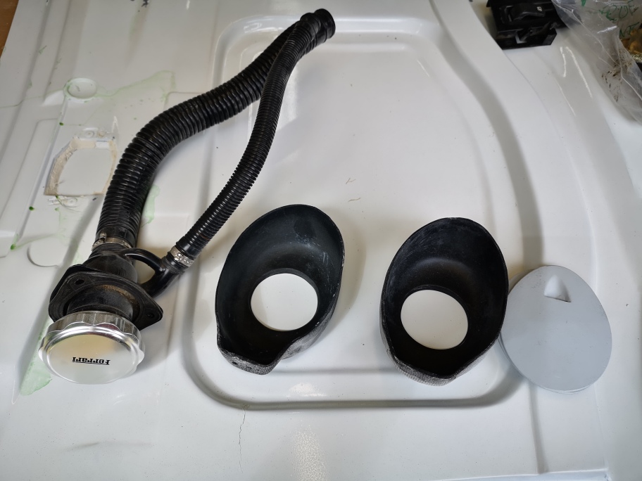

So i'll post a bit on the fuel filler for the benefit of RCR (BOB) I originally used the Fiero fuel lid and fuel pot. I cut the filler pipes and installed a fuel safe rubber extension with a couple of stainless steel T-Bolt clamps. I installed it on the 308 kit much like your kit BOB.
RCR if you want these pieces for your build your more than welcome to have them , PM me with your address.
Also Don O. Is going to take a bunch of pics of his setup for you as well.
I've now gone in a different direction with the GTO build with the dual fuel doors (only one is actually for fuel ) the other will be for something, just not sure yet.

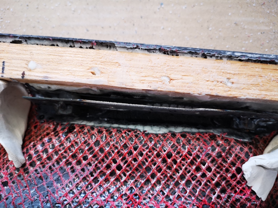

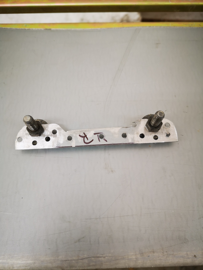

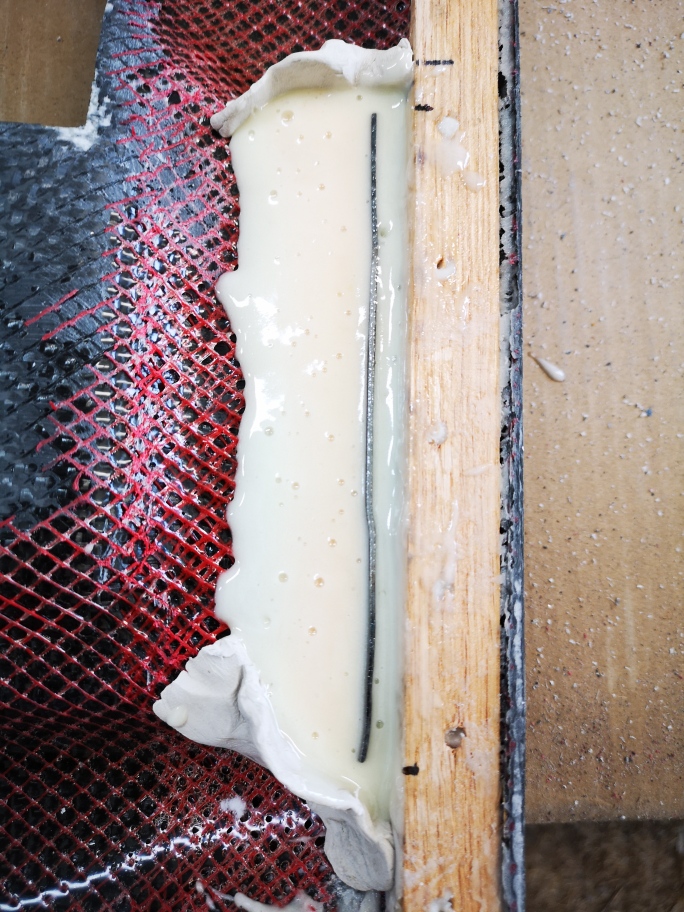

I made up some plates the I welded nuts too, then drilled a bunch of holes into the plate to allow the epoxy resin to flow all around. The epoxy will solidify the entire area giving rigidity over a wider area for the hood hinges.
Clay dams to keep the epoxy slurry in the hinge area
Some of you may notice the red flow media is still on the part, OK I screwed up I forgot to put peel ply down first . Luckly it is inside and will not effect anything.
