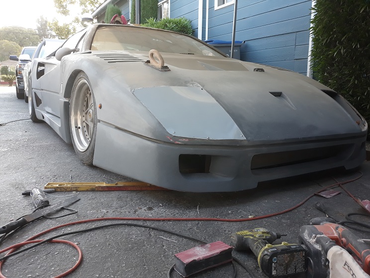

Thanks man, looks much better in person. I thought about making molds but dunno whod buy em n I dont have space for stuff that size.

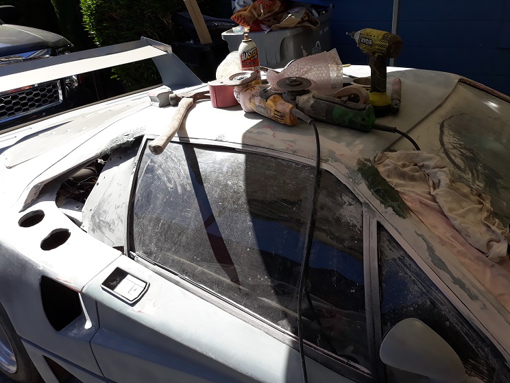

Got a round of kitty hair in several areas on the pass side after it cooled off
 That stuff stinks! Its like fiberglass strands in resin and uses bondo hardener. Super strong and great fill

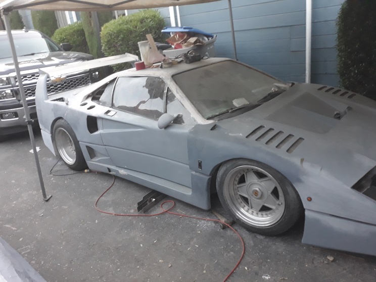

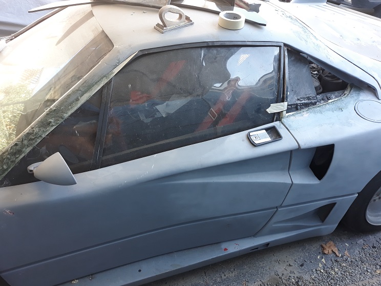

Got a lil bit more done yesterday evenin after work, added more kitty hair on both sides. Sanded down a roof area by the top of the door edge that was sticking out. Did the ds side good awhile back. Got the edges cleaned up, that kitty hairs really strong, Im always worried an edge will chip after painting.

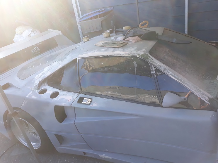

Lil booger snot on the ds pillar and lower quarter window edge
 Should be smoothing out some bondo n finishing up those areas tonight. Buddy came by this mornin I havent seen in about a year n a half, didnt believe me its the same car lol.

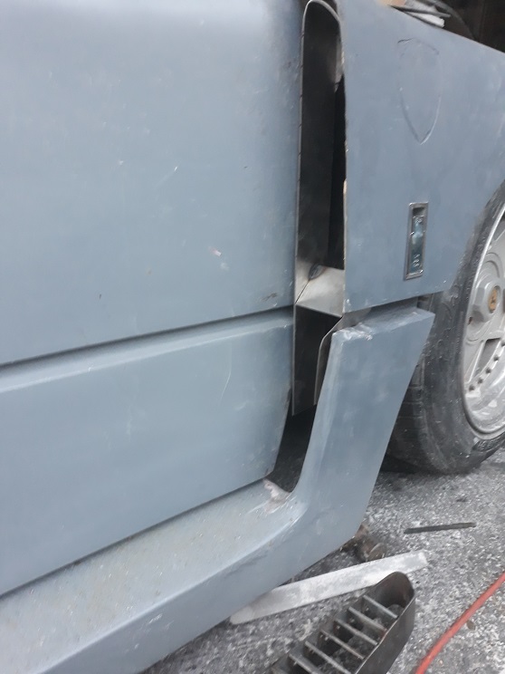

No free time, got a lil bondo on the a pillars n almost ready for round 2. I made a door vent awhile back outta some 1/8" steel, came out too thick n heavy. Ugly as phuc too! Hit my buddy shop and got some 1/16 steel and got it shaped and one vent welded in. Ill finish it at the shop where I can use the shear to cut even pieces.
 Made one for the ds and its too big, will hafta move the hood outwards on that side. This cars defnintley symmetrically challenged.

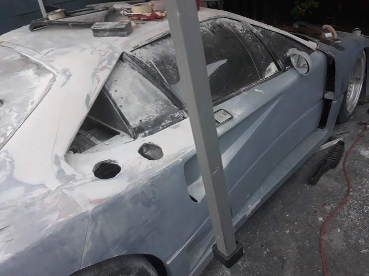

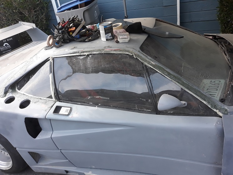

Got mosta round one sanding done, about ready to cut the trunk from the roof again
Also ordered wheels yesterday and adapters today and chopping for tires. Prolly getting goodyears. Pretty antsy

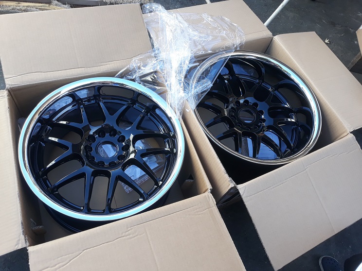

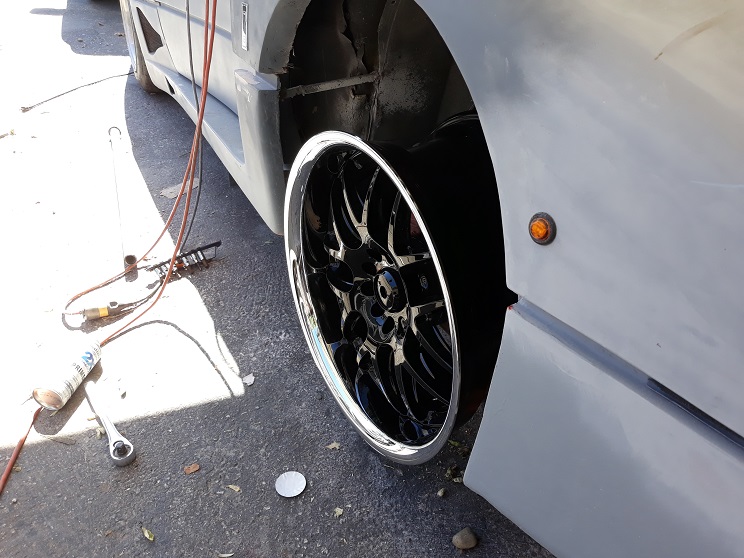

UPS guy showed up at 630 last nite, wow friggin wowsers. Fronts have a 2.75" lip, rears 4.25"
 adapters showed today
Still sanding...
 cut the roof from the trunk on both sides test fitting wheels later

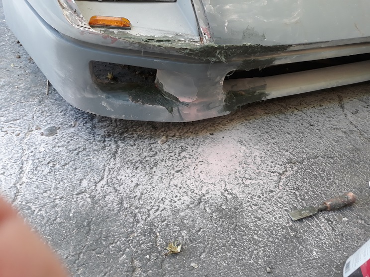

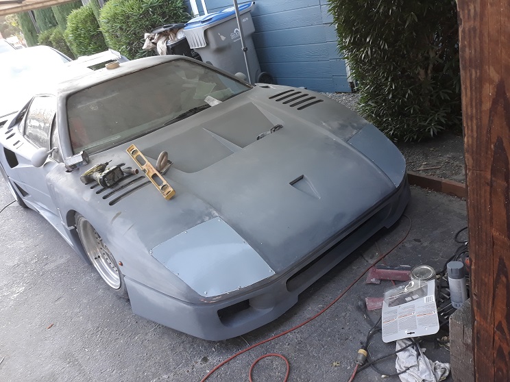

Hit up some spider cracks in the front and sides, and made a template for the headlight lenses. Ill pick up new material for those tomorrow. While moving the car last time I ran the front into a flower pot and made a few cracks in the front.
Test fit the wheels in the front, poifect! soitnly!
All this time is beefing up edges w fb n final details Gonna be a bad mofo by next weekend

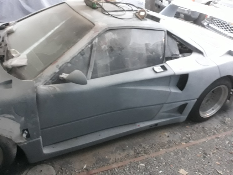

Works too busy didnt touch the car all week, had to finish a brick job yesterday took out a yuuge chunk off my finger. No room in the truck to pick up the wheels from the tire shop, n theyre closed today. Got most of the sanding done and touched up, made the lenses. Looks schweet!
 Did the ps first, and made the screw holes, removed it and copied the shape and holes exactly, and made it fit in the ds side
 What a difference! I love the look!

Going to get the wheels n tires later today
