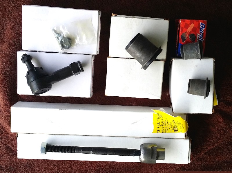

Here is the rest of the suspension stuff to be replaced. Hopefully I have everything. I have 2 of each rubber bushing (right and left).

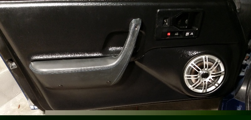

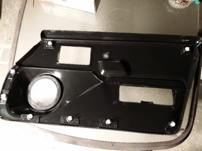

I received my door panels a couple days ago from the Fiero Store, and I have to say I am impressed with the sturdiness of them. The Fiero Store had donated a set for the Daytona Show to be raffled away, but in all the chaos of the show, I did not really get a good chance to look them over or review them. The panels are made of what appears to be a solid ABS plastic, and are quite thick, and do not bend at all, just the way you would want them to be, nice and solid!
I am eventually going to upholster the door panels, but wanted to test fit everything before doing so.
I have a set of Polk Audio speakers that I bought quite a few years ago to go in my Eclipse, before I totaled it. When I was looking at the Fiero Store panels, I remembered I had those speakers, and dug them out of the back of the closet, thinking I had a fat chance of them being the right size. Low and behold, they are 6.5" speakers. Next, I thought they still will probably not work, as the panels require a shallow mount speaker, 2" depth. Again, I was shocked to find that the speakers I had, once again, were the correct size!
Anyhow, here is a look at the back of the panel, with the "Christmas Tree" fasteners in place. They are supplied with the panels.
I put the door panel in the door, and everything fit into place easily. The panel lines up perfectly around the door, and all the clips pushed in easily. Placing the arm rest and door handle / lock mechanism lined up and installed easily as well.
Overall I am very happy with the thickness, quality, and fitment of the panels. This is a great item that fixes a known problem with the Fiero, where to put decent speakers! Kudos to the Fiero Store for making these available!
I will post more pictures here when I get the panels upholstered and completed.
