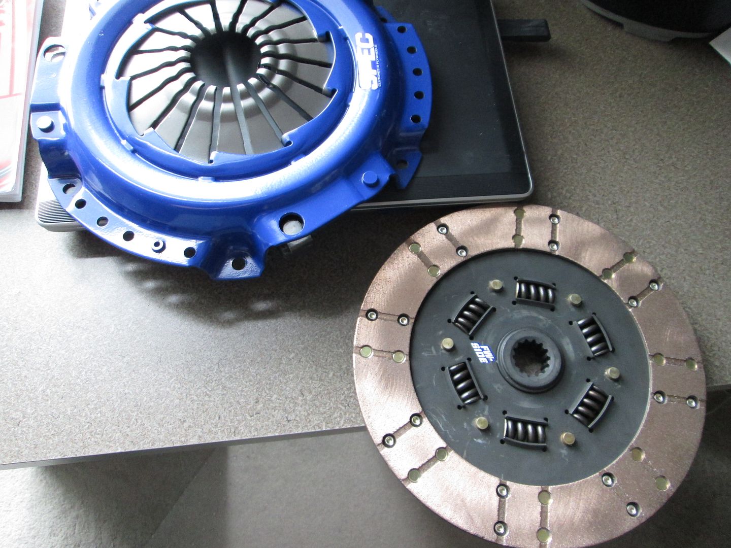

Back from my most recent trip for work and the new spec clutch was waiting for me.
Comparison between the two:
Once the new clutch/pressure plate were bolted to the flywheel and measured the height of the clutch fingers: 2.112"
Then I measured the range of motion of the HTOB w/o any spacer. 2.776" Retracted 1.899" Extended
So if I just installed this like it is, there would only be .213" for release and .664" for wear... no chance this will work w/o a spacer. Now this combo is unique in that the flywheel is about .200" further from the transmission than a stock fiero due to the Archie flywheel and adapter plate.

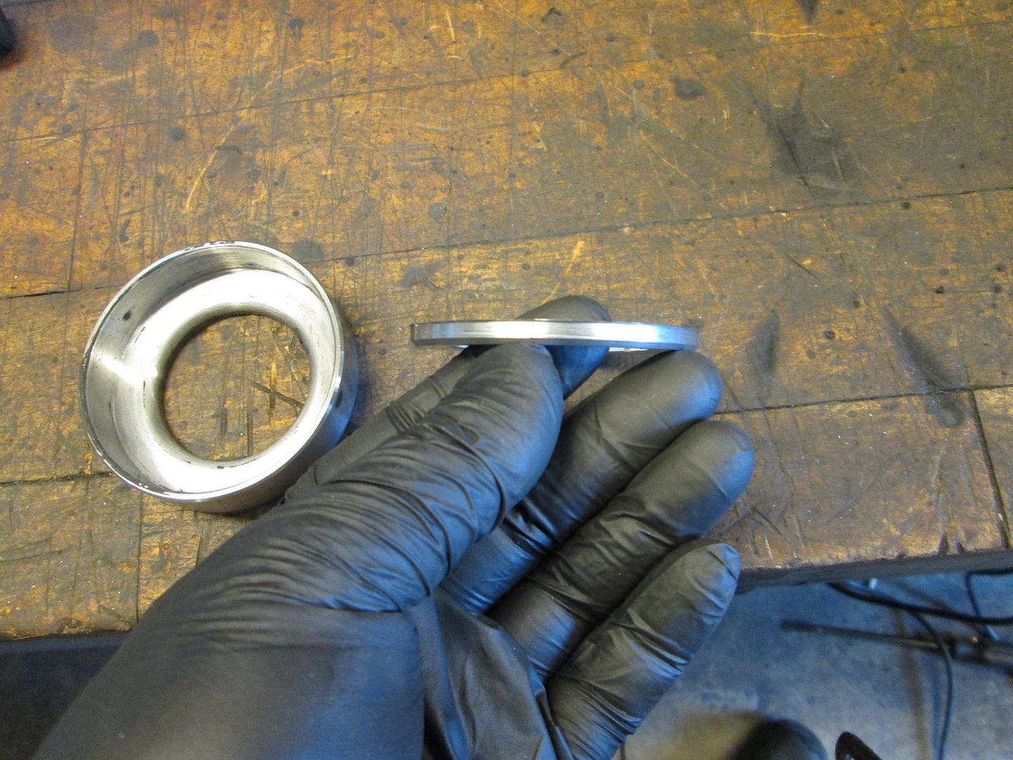

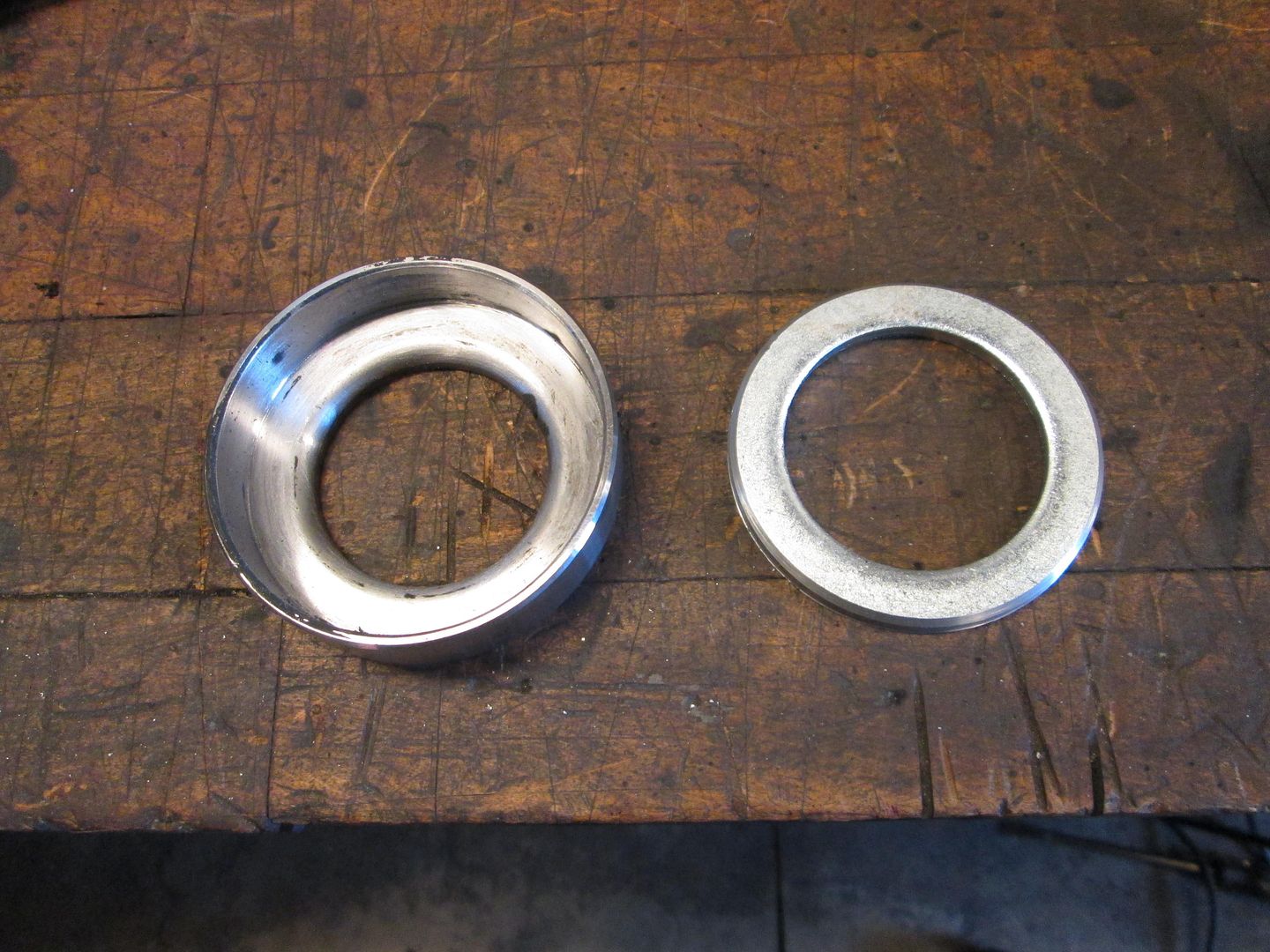

This car did come with a HTOB spacer that is .250" thick. So using it with this clutch the release will be .463" and .414" for wear. Even with the spacer, there is a very good chance the HTOB will over extend. The HTOB spacer needed to be thicker, so I turned a very larger washer down for a tight press fit inside the HTOB spacer.
With the washer inside, the HTOB is now .437" thick. So now there is: .650" for release .227" for wear
And this will work just fine...

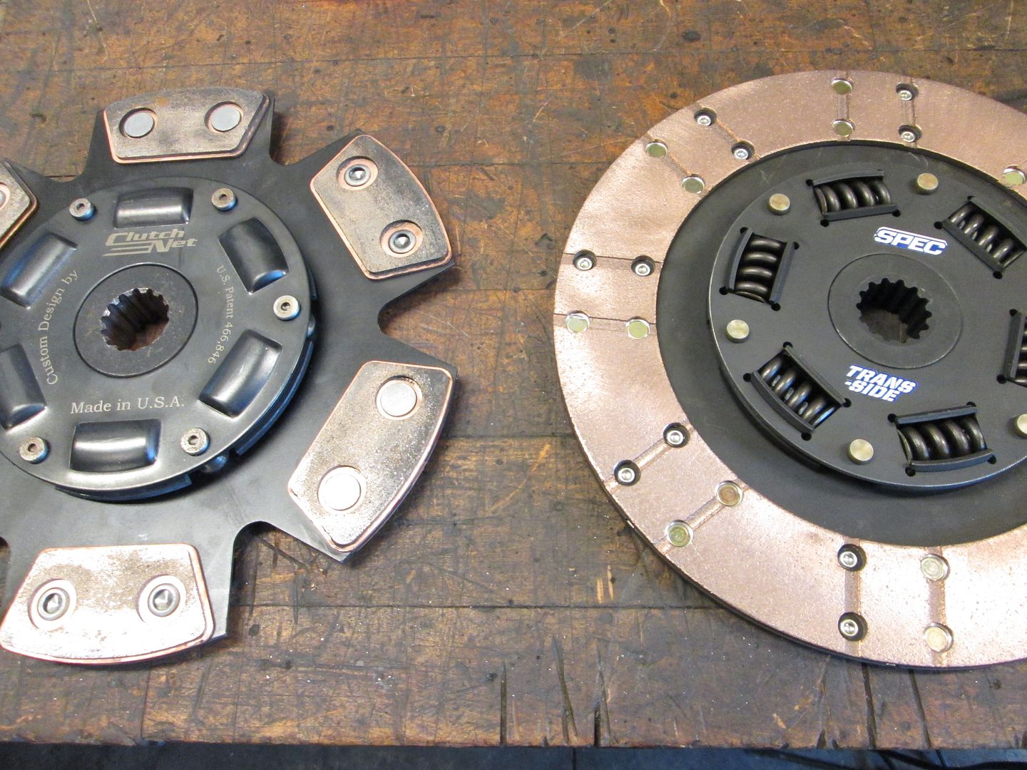

That pic of the clutches also showed me something else that changed with Clutchnet, my original clutch from them, the springs were fully enclosed - not the best for knowing when a spring broke, but would definitely keep broken spring parts from jumping out and tearing/jamming things up (it was one of the things I liked... now if it's a bad idea, that's my ignorance showing).
But this new clutch from them, not enclosed. So, another mark against them in my book, as it's another difference from "Give me the same thing I ordered before."
Either way, I'm super glad the new parts showed up and were correct, and that FieroGuru was able to cook up a fix to make sure the spacing was right!! Thank you again!

| quote | Originally posted by Trinten:
Looking awesome!!

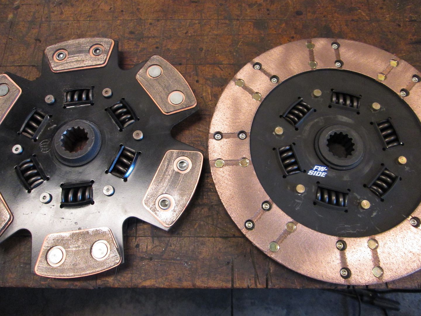

That has always just been a sales gimmick, as they only enclose one side of the springs - only the front side that is visible when the clutch is installed. The new disk does have the front side enclosed, but as you can see the back side is just like the Spec setup. Even comparing the thickness of the metal in the spring opening, they are the same thickness. Here is a front side pic:

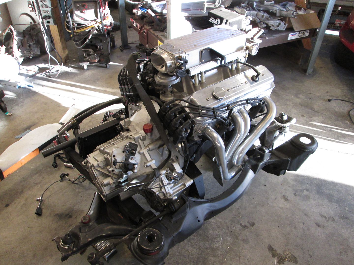

Vince's SBC swap is back running again!
The vibrating of the intake is much less, but it still changes sounds when I put my hand on it... eventually it will need some kind of sound deadener or top plate. It doesn't sound abnormal, but since I know its there it still annoys me.
The A/C clutch was still vibrating, so I removed it from the compressor the time being (its nice being able to swap it out with everything installed!). I will buy a new one and I hope it doesn't vibrate as much. The good news is that once this was removed, the rest of the engine/exhaust wasn't making any other annoying or otherwise distracting noises! The V-bands are now leak free too and while the engine was out, I checked the header flange gaskets for black soot and they appear to be leak free as well.

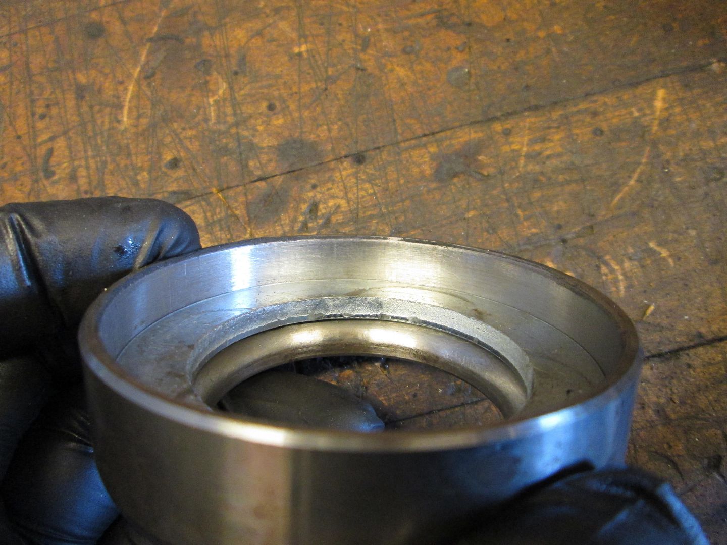

I am pretty sure that while reinstalling the axles, I figured out the source of the gear whine that gets worse with vehicle speed and the excessive backlash in the drivetrain as you transition between on/off throttle. This car has a quaife limited slip, so there are no spider gears and the tripods snap tightly into the limited slip unit. When I was installing the DS axle, it only went in about 1/2 way and got in a bind, when I tried to pull it back out it moved slightly and made a heavy metal thunk... That caused me to look into the noise further and found this:
So it would appear the differential bearings are toast... I am going to drive the car a little this week to fine tune some other aspects of the car, but will pull everything back out this coming weekend and drop the transmission off at the rebuilder on Monday so they can open it up and see what it going on inside it.
