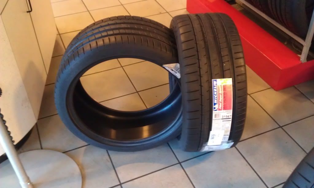

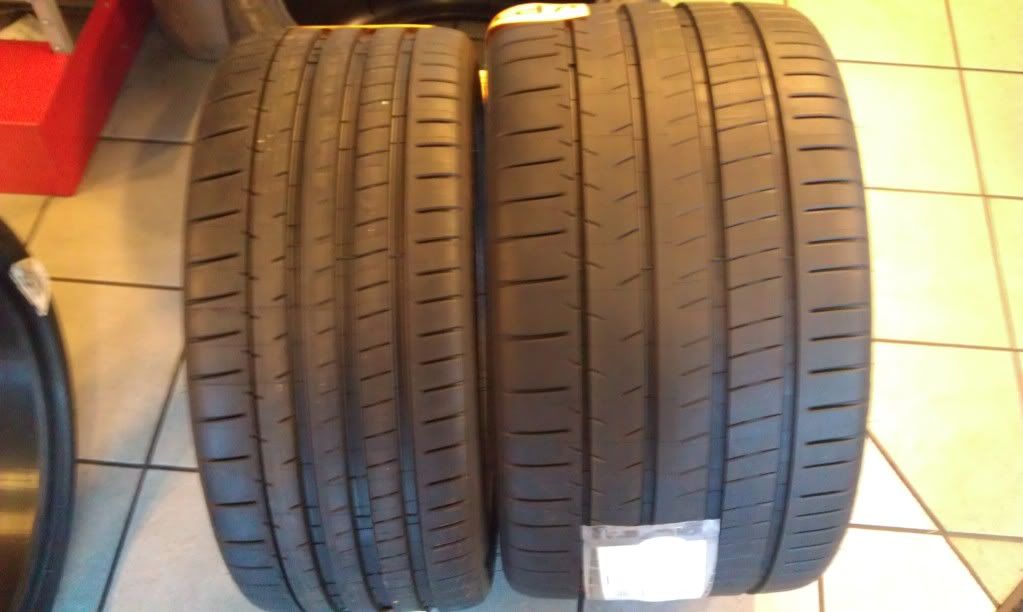

Wheels are due in this week. Tires are already in.
Here's the fronts.

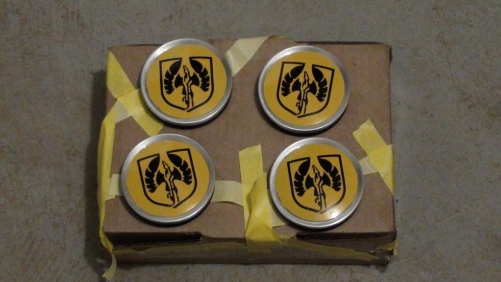

I picked up the centercaps for my wheels from the paint shop yesterday. They were painted to match my car. I decided to put the decals on now.

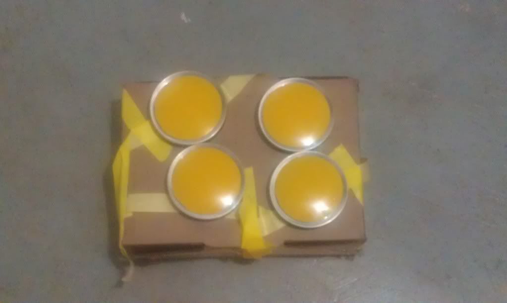

With tape removed from exterior ring...

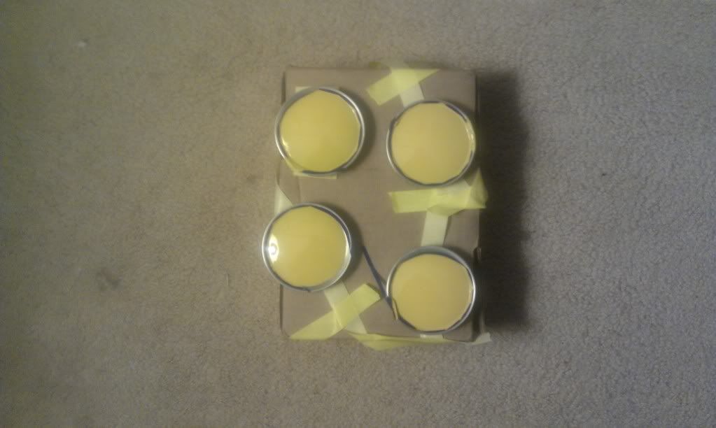

With decal applied.
