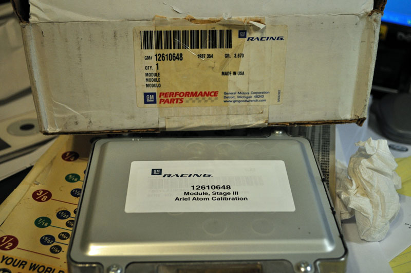

I have an ECU from Brammo via Gale Banks around here some where that I need to sell. I've heard a lot about the heat soak problems and worked on getting a butt more cooling capacity in my car.

Which version of the Brammo tune do you have? I think they had a stage 2 and 3. PM me about the ECU, I would be interested if the price is right. From what I have gathered, the heat soak problem can be solved by adding a larger heat exchanger (down low in front of Fiero cradle might be a good spot), adding a surge tank (available from GM called "option B") and upgrading the intercooler to a dual pass endplate. I have also read that it is a good idea to upgrade the valve springs on the LSJ in stage 3 trim, the stock ones are only good to around 6800-7000 rpm.
ccfiero350 APR 24, 02:47 PM
I have a spot for a BIG radiator for the inter cooler up front and all the bits for the upgrade. Need to finish body repair first. See http://www.fiero.nl/forum/Forum2/HTML/098086.html
Brand new, still have the original box. Stage 3, if your in the business you know how nice it is to have one to exchange with, and one to hack. Make me a reasonable offer.
