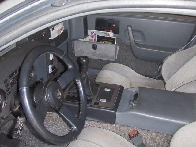

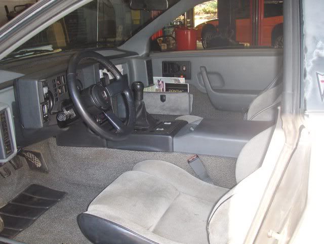

I had a few free minutes to assemble the interior to 100%. We officially have Joey's approval of the interior, but the shifter may need some getting used to...and I'll probably shorten it an inch or two. I've been playing around with the adjustments of it and I have no problems finding any gears.

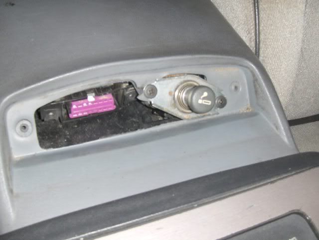

Here is a shot of the OBDII connector mounted in the Fiero's stock location. The VW computer is mounted in a fabricated plastic carrier similiar to the stock Fieros. All diagnosis and programming are done with the VAG-COM or factory VW laptop.
If all goes well, the exhaust should be completed with the Porsche tips by tomorrow. After that is begins the fine tuning and the gauges should be installed by next week.
Dave
ps...Any request of pics or how I did what? I can answer them as best as I can.

P.s.: I like the OEM location ODBII connector. Makes it look like it's always been there.

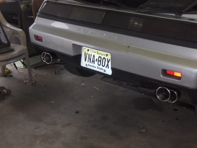

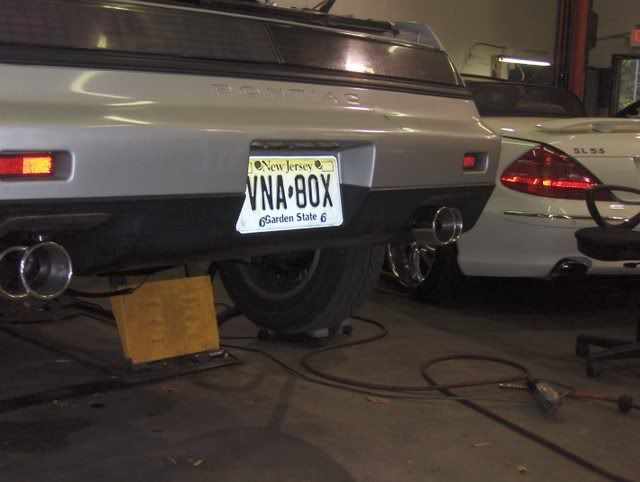

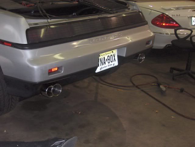

got some exhaust finished today. 100% mandrel bent.....nice Porsche exhaust tips and a nice low rumble with a few small flames out the tail pipes....I might have to retune a little bit.
