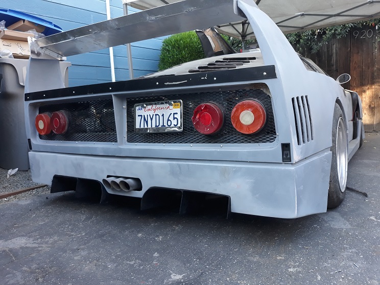

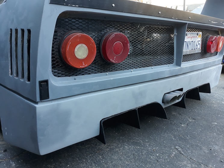

Poking around for a bit, finally had a few hours in the mornin nd this evenin to work on the car. Got the rear fins cleaned up really good, and laid some glass n bondo on the underside of the bumper to get the fins flush w the bumper. Better but not poifect
 Fins are pretty damn symmetrical, been working on getting the thickness even throughout. Been having issues w the airbag check valve getting jammed shut. Really shitty design, I made some mods to it and it seems to work consistently(for today at least). Trimmed up around the rear ps quarter window, fits much better now. The sheet metal I put to seal off the cabin took up some space n the winduh didnt like it. Welded up the ps side window frame to the door skin better, and almost got the door handle rod in the right location lol just a 1/4" lower n ill be perfect!

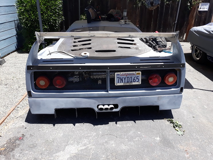

Got the ps outer door handle working good! Finally! Took a shot o the back while the driveway was clear
 Looking pretty friggin good! I cant beleive I did all this work. I cant believe I spelled believe wrong either! I figured out a way to attach the rear of the roof to the car. Ima fb some angle ern to the underside o the roof, then I can bolt the angle to my roll bar n cover w the headliner. The rear of the roof being loose is making the roof to trunk gap totally yuuge, its really like an 1/8". Went to open the new box of latches I got for the car and theyre super small wtf?! lol I really only need 2 and just got em on ebay right now, guy accepted my lowball. Schweet. Cupla mods to the front wheelwells and a little more cleanup and itll be ready for the finish guy.

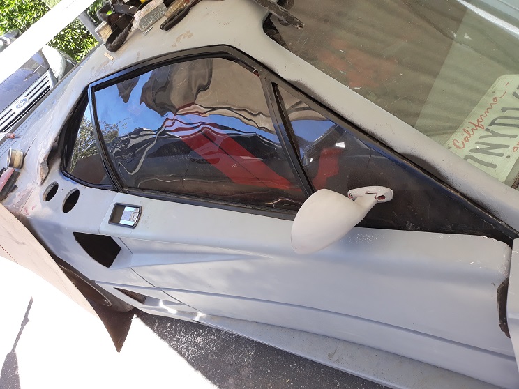

I forgot, tons o window frame cleanup. I got the ps rear quarter window shaped better to he curve of the body, welded up and ready for bondo. The ds rear quarter winduh needs some reshaping too. The door windows are pretty good, cupla minor spots. pics to come

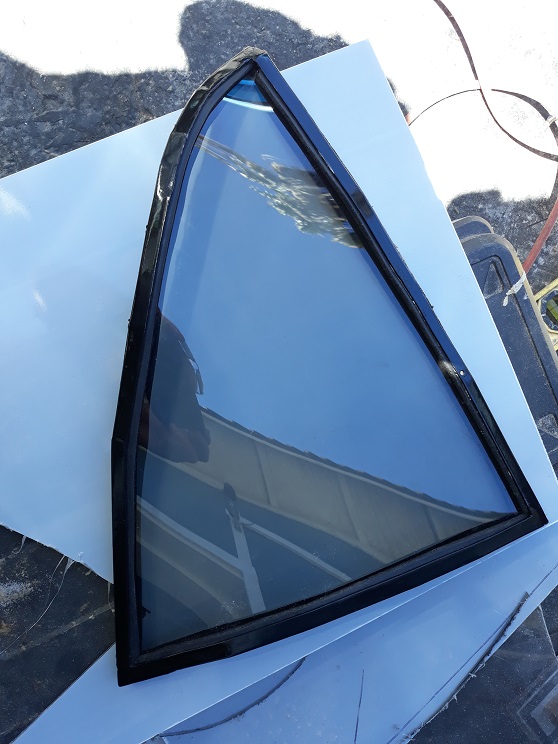

Rear window done, came out great! wifey even said oh wow
 made a new window outta 1/8" poly, old ones were beat Hit tap plastics for enuf poly or the two rear quarter windows n some fb cloth just in case. Gave me an excuse to roll the stang

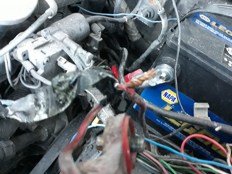

I keep forgetting this thread isnt in general chat anymore lol. I walked down to napa yesterday w the kid in the stroller and got a new battery, + cable, oil filter, and a jar of kitty hair to try out. Ive only been in there a handful of times( oreilly is closer), but my mechanics behind their store and they remember the car. Showed the manager some current pics, he loved it. Cars way too low to get the jack under, so had to fire up the bags. Starter cranked over so nice w w the new battery. I havent changed the oil since I bought the car, it was pretty bad for only a few hundred miles tops. The fram filter i took off was short and the napa filter about twice the length. Pretty claustrophobic being under the car that far, I saw the starter and thought wow thatll be a biotch to remove. Glad I just have to swap the cable. The whole underside of the car has at least a 1/4" of fb dust caked onto the engine and cradle. Give the ratchet a turn... snap and the ratchet gives. I knew somethin came loose and it wasnt the nut I was trying to take off. Solenoid plastic snapped. New starter time. Dropped the starter and broke the rest of the wires off w the ratchet. Cut the front wheelwell edges closer n laid glass. More this weekend

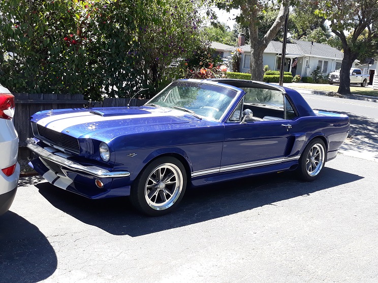

Shem you do some killer work ! Yeah the mustang came out great! Thanks!

Man Im beat, Painted and landscaped a duplex w one helper thurs n fri in hunert degree heat a hunert miles away. Had a lil work locally saturday but picked up the starter before work and installed it and the new cable after work. Check out the c500 hookup

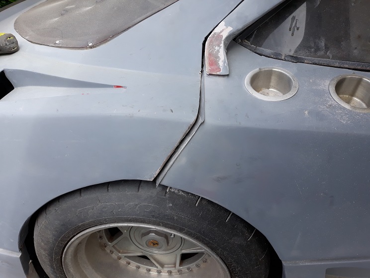

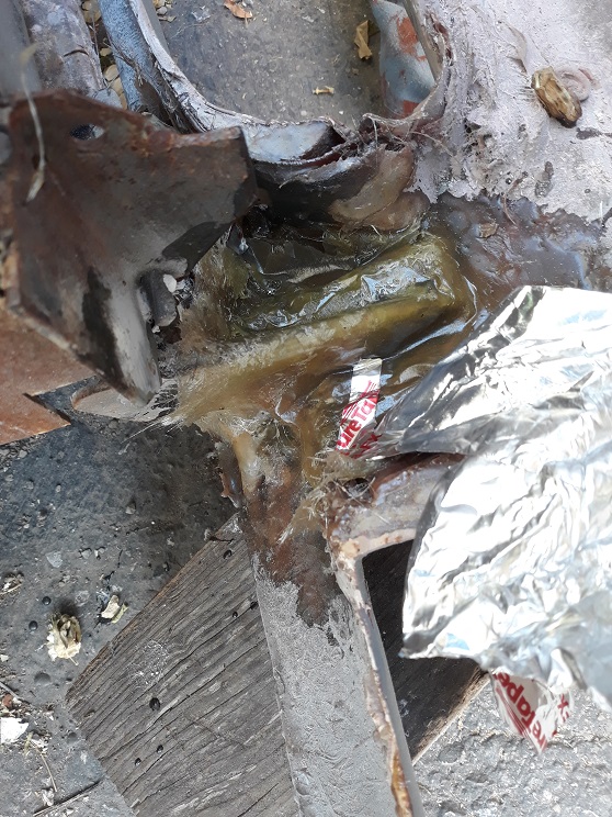

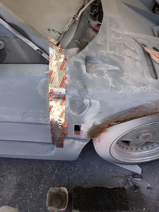

Ive always had a problem w the right side of the clamshell moving forward, today found the reason. The metal frame that holds the hinge and is glassed into the clamshell is ripping off. I slight push and the side tore off completely. I cleaned it up and laid 6 layers of glass and held it in perfect shape w the hvac tape while rsting on a 6x6 chunk

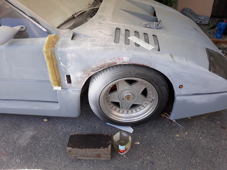

Used some foil hvac tape to hold the rear of the front wheelwell openings where i wanted em and glassed em from the inside. Today I glassed up the outside and had to extend the rear of the clamshell to fit the lower section, used the tape on the inside so the glass had sumfin to rest on

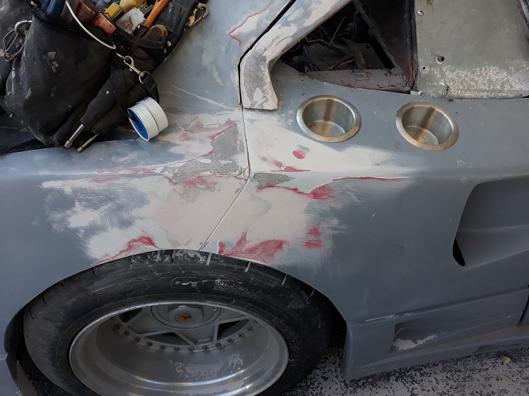

was a little thin so I laid more glass to even it out, then got everything perfectly smooth w some magic tape
That stuffs awesome, glass came out super smooth a lil bondo to smooth errthang out and
 l ooking damn good, still gotta sand down the drivers side

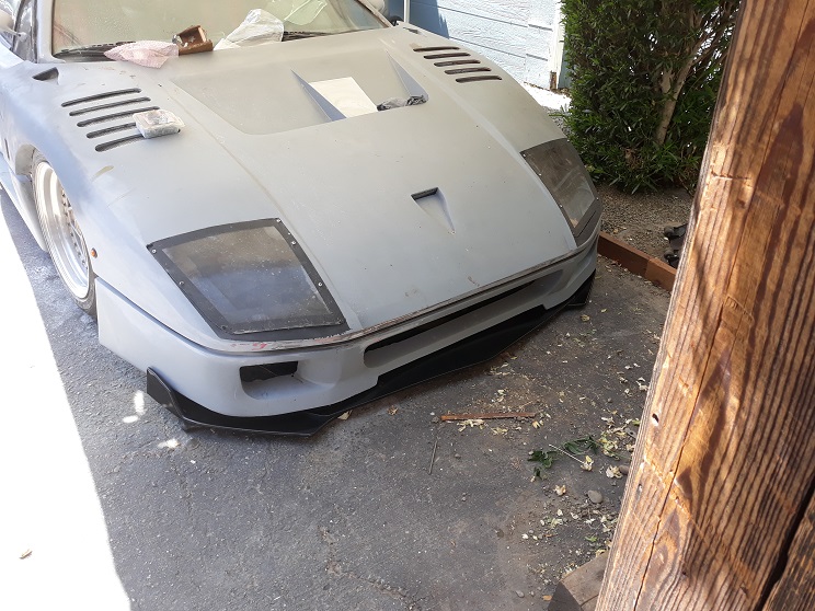

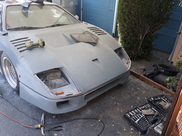

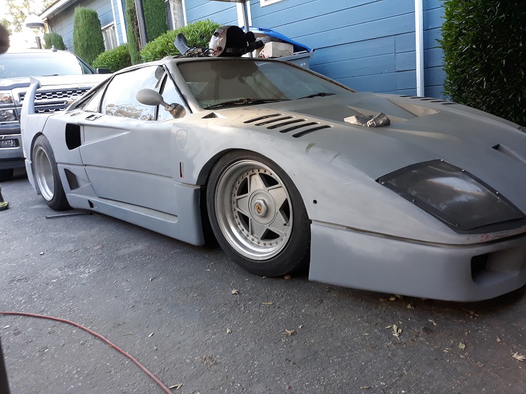

Busy w other stuff, fixing up the trailer and wetbike mods. Squeezed in a camping trip where I had the fattest tailslide ever and I stayed on. Motor died, carbs flooded. Hit start and the gas in the hull ignited n blew me n the seat off the bike lol. Havent touched the car till today. Found a generic splitter i can cut up and fb over to make a good looking one for the car.
Then I cut out the headlights where I had marked forever and It looks awesome. Needs some cleanup but the shape is definitely fierrari and makes the hood look much better, very happy
 need to make the lenses, do a lil work on the A pillars, n starting to run outta stuff to do outside.
